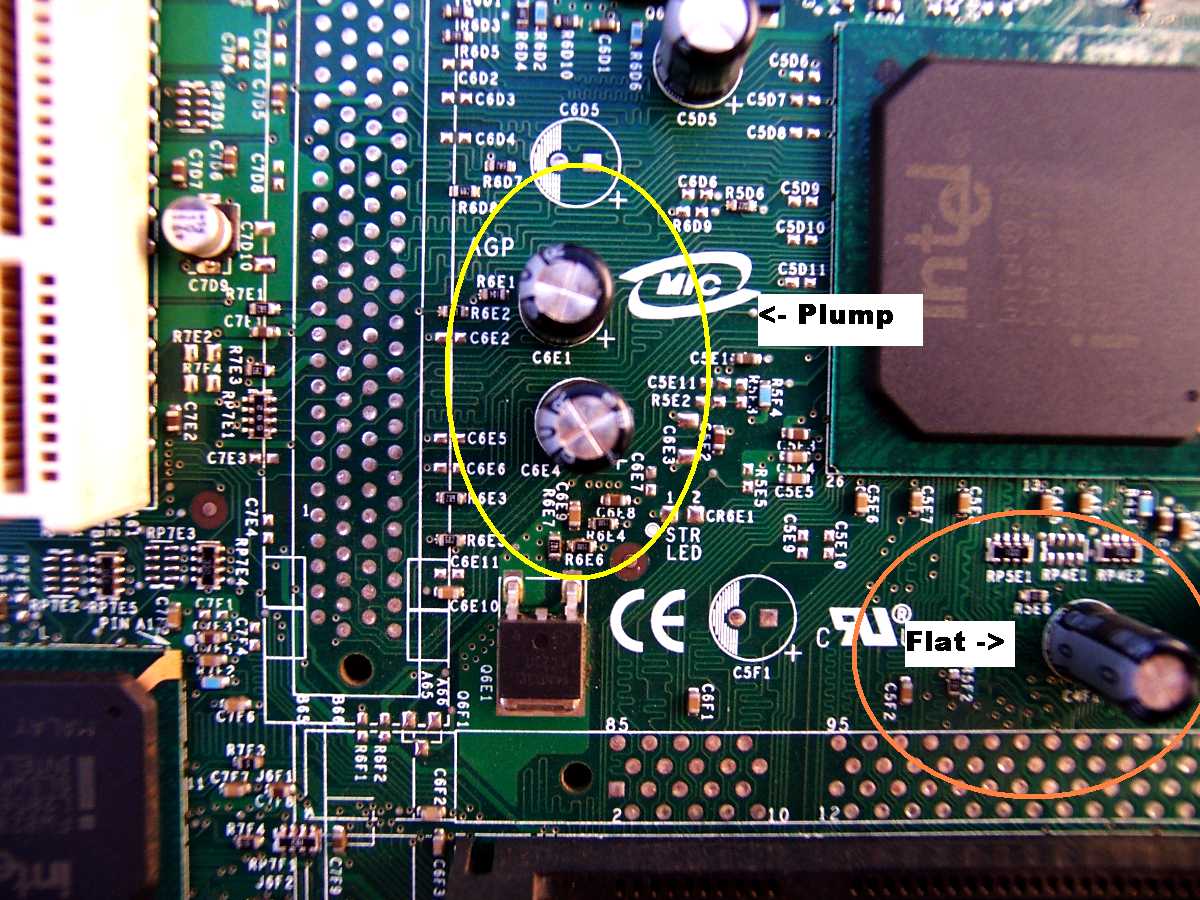

    Oops, my mistake.
    The bloated caps on both those are 85c 100uF 25v 6.3mm.
    100% on the D850GB and ~50% on the Gateway.
    Gateway also has 2 or 3 85c 5mm [no vents] that -might- be bloated.
    I'll try to get a snap-shot but bloated 6.3mm don't show up well.
    - They don't have -room- to bloat that much when they do bloat so the 'bump' is slight.

      Re: Dell GX620
      Dunno if you can see it but there it is.
      They are noticeably plumped up [bulged] between the lines of the vent stamp.
      Obvious / easy to see in person. - Hard to show in a photo.
      The one showing the RAM slots is the D850GB.
      The Kittyhawk is the other one.

          I suspect a lot of repairable GX620 boards are getting written off and trashed because the techs don't think to check the 220uF [or even 100uF].
          Absolutely not a fluke.
          Not uncommon for 85c caps to dry out or bloat on a mobo with poor airflow.
          Thing is they aren't heavily loaded with ripple like the 'popular' replacement caps so it [usually] takes them longer to dry or bloat and cause problems.
          So I understand the GX620 [I don't have one to play with yet but I'm looking] puts a bunch of 220uF right under the hard drive which limits airflow and is source of heat on the 220uF that SX270/SX280 don't have.
          Personally if it's USFF or a server board [or for ME] and it has 85c caps I replace them.
          Buying in bulk [100pc+] the cost difference is usually < $3 per board [for Dell GX/SX anyway] and that's cheap insurance.
          - It's also handy to have a handful of 100uF and 220uF around to replace 85c caps in LCD screens when they show up so I just keep at least ~50pc of those sizes in stock now.
