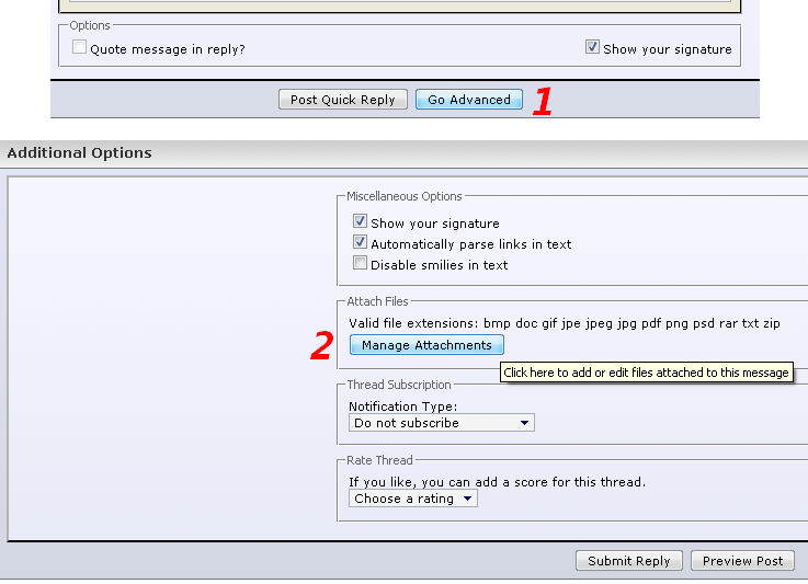

      Took some photos and would like to post 2 jpgs. Each jpg is ~450 MB full size but if compress more significantly degrades the details.
      Please tell me or provide a link if I missed a posting of how you posted the photos at https://www.badcaps.net/forum/showthread.php?t=588
      Gene
        Can anyone tell me how to post photos like https://www.badcaps.net/forum/showthread.php?t=588
        Gene
        • Scenic
          o.O
          • Sep 2007
          • 2642
          Re: Mystery ECS Motherboard?
          you can also upload them here: http://img-share.com/
          and then post the text in the "BBCODE" field here..
                  Scenic,
                  Thanks for the photo tips! Excellent details!
                  My 1st mystery mobo jpgs. Let me know if they need to be reshot to capture any important details.
                  Mystery Mainboard URL: http://www.img-share.com/view/2399
                  Closeup of bad caps URL: http://www.img-share.com/view/2400
                  Since http://www.img-share.com/ allows 10 MB Maximum Upload File Size is it possible to upload a number of small jpgs at once? If so how?
