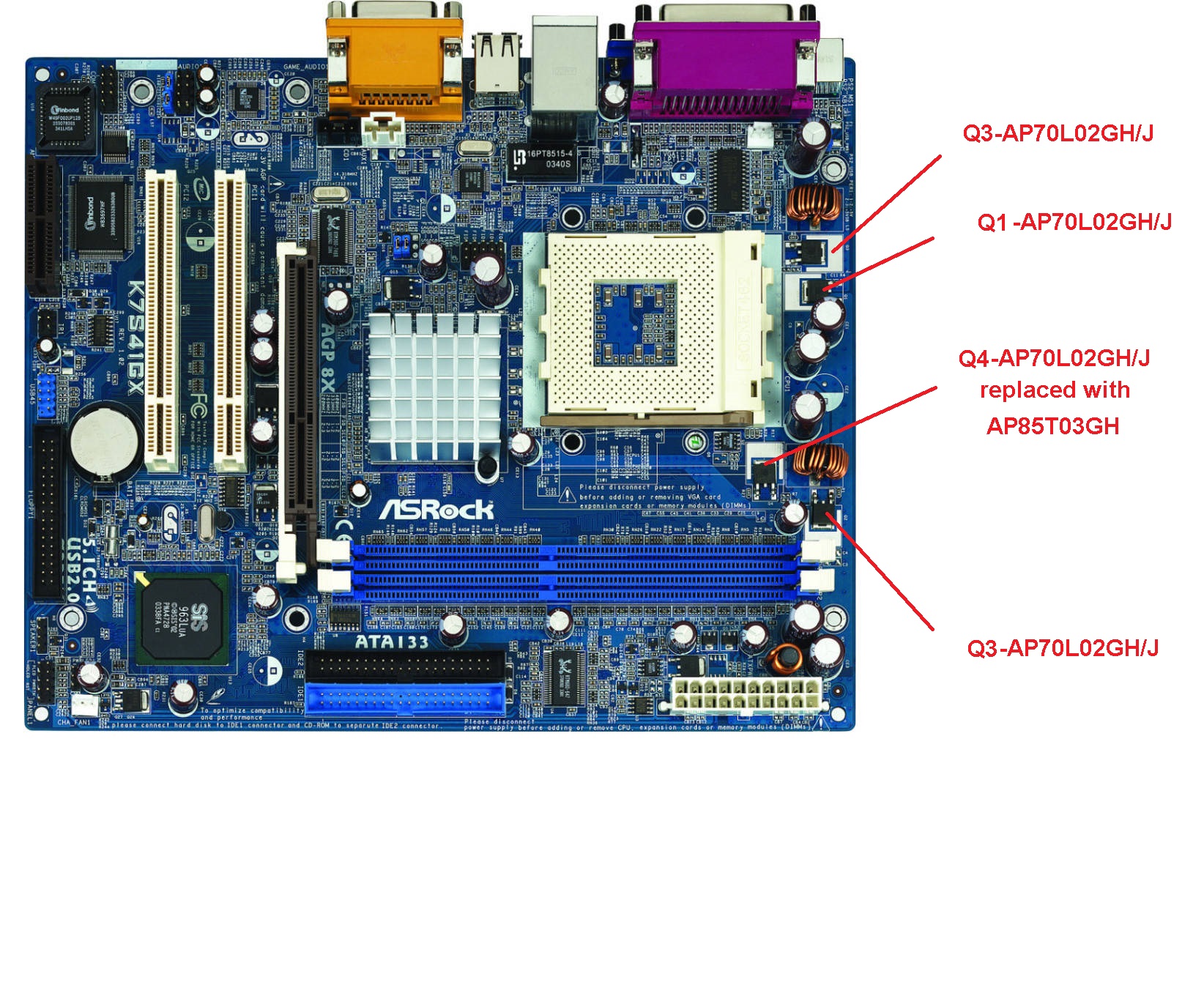

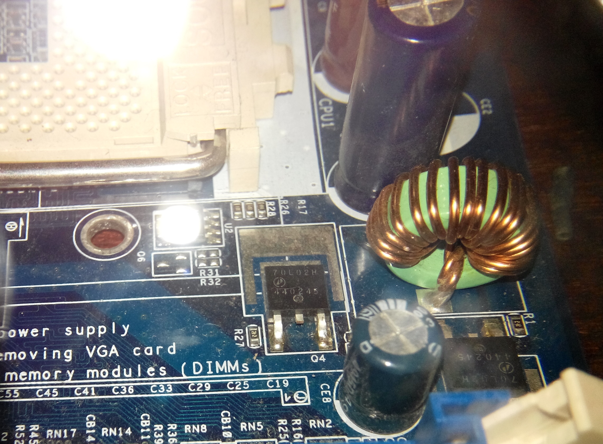

    I have that board for few years ago. She died suddenly and there was not a way to revive.
    That evening I found it in a box by chance, looking for a replacement mobo for someone.
    Thanks to the knowledge gained here on the forum, I immediately found the cause: VRM Q4 was dead.

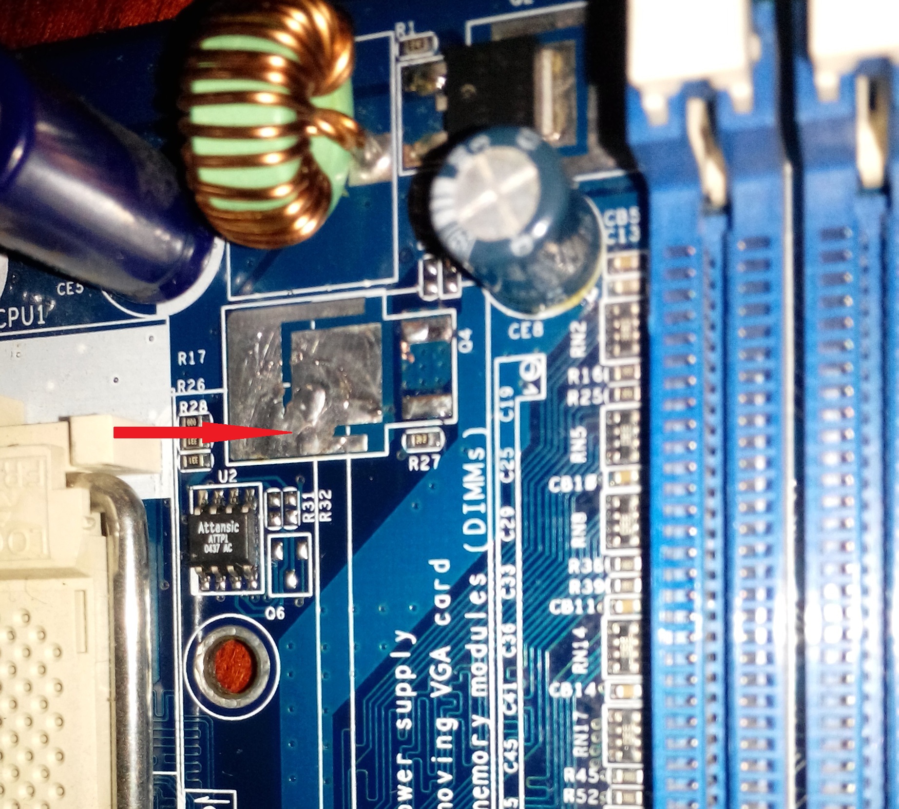

    I noticed that the two areas in figure remained united after vrm desolder. Is there a risk if the two zones are united? I tried to clean the area, but my soldering iron is pretty skinny.
    VRM Q5 is 70L02H, what is best equivalent that I can use?
    Thanks.

    i think that could be just the body pad for the mosfet to dissipate its heat through the pcb. if in doubt, just use a good branded low wattage psu with known working short circuit protection just in case...

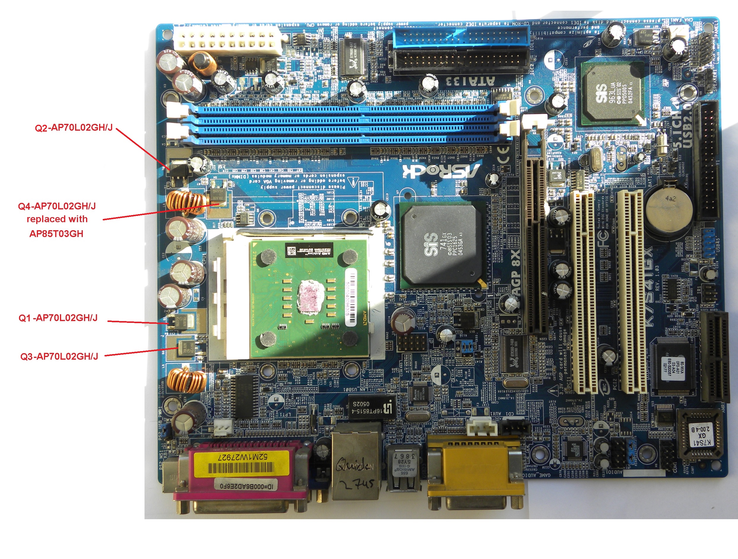

            Re: ASRock K7S41 issue
            3 months later...
            I found an AP85T03GH as replacement for 70L02H:
            http://alltransistors.com/mosfet/crs...009&caps=TO252
            I checked before replacement and after the origial mosfet Q3 70L02H and the replacement AP85T03GH : both has ~600mohm trough Gate and Drain but both fail the continuity test after soldering.
            I really don't know...

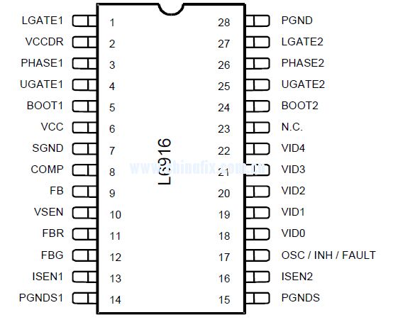

                Vrm controller is the ST L6910 ADJUSTABLE STEP DOWN CONTROLLER
                WITH SYNCHRONOUS RECTIFICATION with 16pins, between LPT port and 462 CPU socket?
                Must verify the pinout voltages after power on?

                      My BIG mistake!
                      The VRM controller is not L6910 but ST L6916D!
                      And I cannot find datasheet.
                      • cpt.charlie
                        • Sep 2013
                        • 270
                        • Spain
                        This is all i can find.
                            Is this in circuit or out of circuit?
                            If the MOSFET is shorted out of circuit, then it most certainly is dead.
                            BUT! if the MOSFET is not shorted out of circuit and ONLY in circuit, then that's different.
                            It looks to me that MOSFETs Q2 and Q4 form a synchronous buck pair, with Q2 being the "upper" MOSFET and Q4 being the lower MOSFET. Thus, Q2 Drain is likely connected to a PSU power rail (3.3V/5V/12V) and Source connected to the inductor close to it (the output voltage of the buck rail... i.e. could be the CPU V_core or Northbridge Vcc). Meanwhile, Q4 Drain is connected to the same inductor (output voltage) and Source connected to ground.
                            With that said, in many cases where a buck converter is used for powering a CPU or Northbridge, it is typically NORMAL for the lower MOSFET to show very low resistance (less than 50 Ohms) or even a "short-circuit" between Source and Drain.
                            While on this topic, I shall note that Q1 and Q3 form another sync. buck rail, with Q1 likely being the upper MOSFET and Q3 the lower one. You can tell by checking which MOSFET has its Drain connected to 3.3V, 5V, or 12V rail on PSU.
                            No risk.
                            The two solder areas are actually united underneath with a copper trace.
                            3 months later...
                            I'm not sure if I am understanding this correctly...
                            Are you saying that you have a short-circuit between Gate and Drain on a MOSFET while it is on the board??
