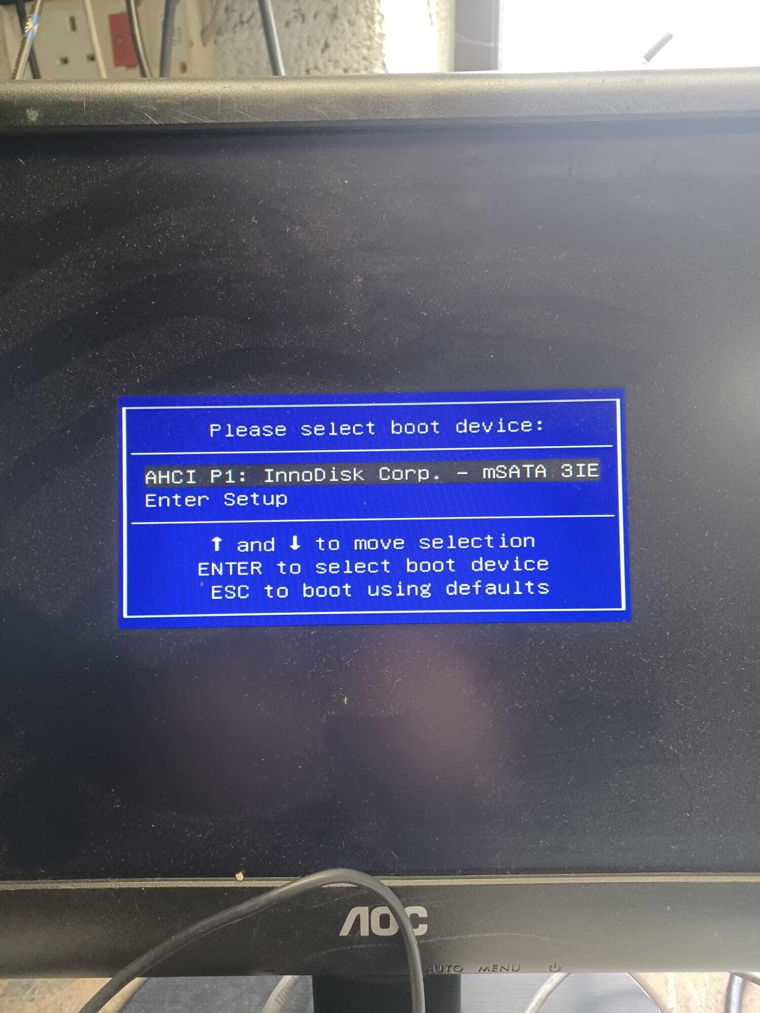

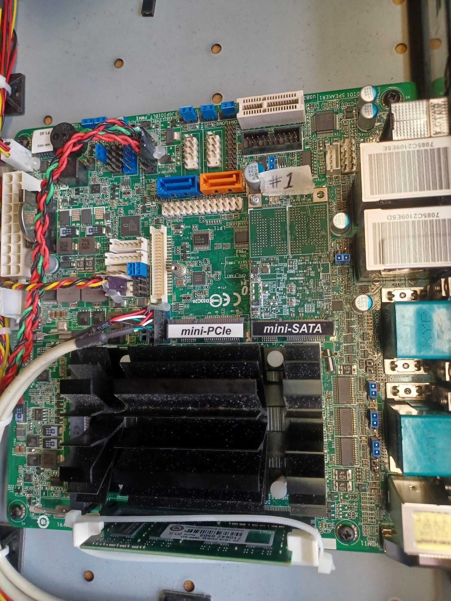

    I have an ASRock motherboard (IMB-150) with Mini-Sata Solid State Drive. I have removed the SSD card and re-inserted. After re-inserting the device will not boot up. During boot up error displayed "Reboot and select proper boot device or insert boot media in selected boot device and press any key".
    Connections on motherboard and ssd card look in good condition, no signs of wear or damaged connections.
    During boot up I pressed F2 to select UEFI setup menu and mSATA 3IE is listed as boot device with no other option available.
    Anyone have some advice on how to repair/diagnose/fault find..?
    Thanks in advance for any help..

    Might be the UEFI issue. I don't think anything damaged. you can boot with a USB drive and reinstall the OS to your SSD.
    but a BIOS reset may also fix the issue. it's just annoying to mess up with the UEFI.

      How do I reset the BIOS?

        Remove the RTC battery and short the two pins for more than 10 seconds. or short the CLRRTC pins for 10 seconds
