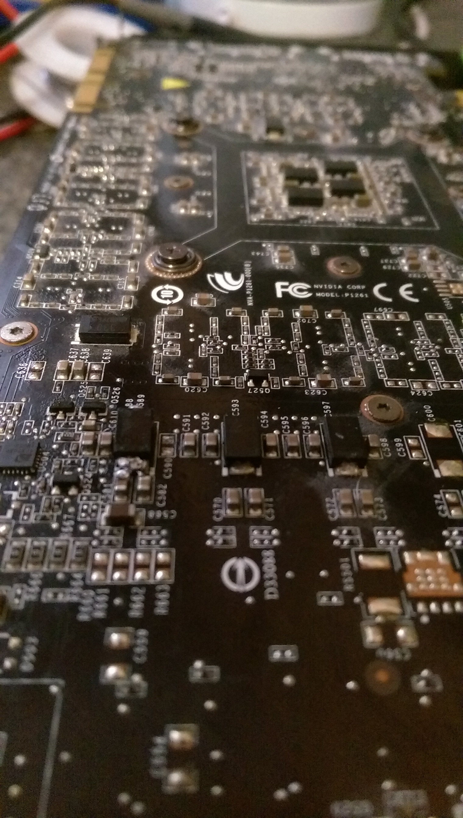

    Got this card from a friend, didn't notice it was damaged until I came to fit it, luckily didn't get to fitting it.
    2 of the components have lifted off, 1 is the black thing labelled as 330 0n7pe , no surprise google returns nothing really on it, the legs on this have snapped but the contacts are still there and i've managed to get it to stay in position with a solder blob either side and does now read like the rest on the board.
    There's a small SMD capacitor (right next to the soldered part) that's missing that i've no idea the value of, which is my main question really, any way to find the value without lifting another off the board to test it, or someone who knows how these types of things work in conjunction with other components to determine the value.
    (I know this isn't a ideal soldering job and not condoning it but it's the only way I could get a reliable connection and for it not to move, gotta clean up the capacitor next to it as solder transferred but nothing is bridging)

    Re: GTX 570 Graphics Card damaged components
    the cap that is missing is 100% the same value as the other 2 below it also where you have soldered that black cap and the 2 smaller one have care that the solder is not shorting across the bigger one and the smaller ones also check very carefully for other missing caps as if they are missing and you try to power it up you can fry the gpu irreparably

      Ye, I have checked for shorts just gotta clean it up, I know the caps are all of the same value in that area, I just don't know what the value is, which is the problem, any ideas other than removing the other caps? (prefer not to if possible)

            The smd parts have no labels that I can see anyway, the card is a PNY GTX 570, plugged it into my pc to see anyway, thought the worst that could happen is it wouldn't boot.
            Card seems to work in a fashion, POST is centred in the middle of my screen, windows is the same and drivers won't install for it, NVIDIA drivers complain that no compatible hardware was found, plus windows driver updater complains of a missing line in the inf file, guessing it's not actually being recognised as a 570 anymore
            Will get better pictures

                Sorry should of explained better, the black component has it's legs still attached to the board, all that was left was 2 small copper contacts either side on the actual component, couldn't solder wires to it reliably so went for a blob either side as the contacts are so small.
                The missing capacitor next to it, pads are fine on the board, just needed the capacitor.
                I've since found working drivers 353.30-desktop-win10-64bit-international-whql which recognised the card, just stress tested it for a hour, no issues

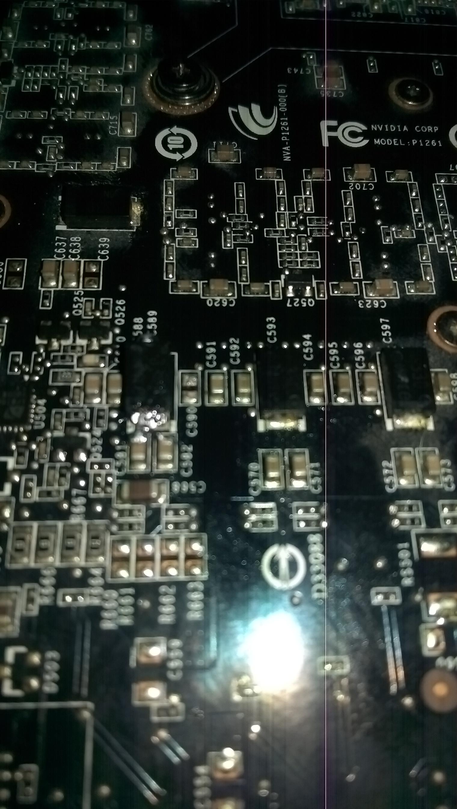

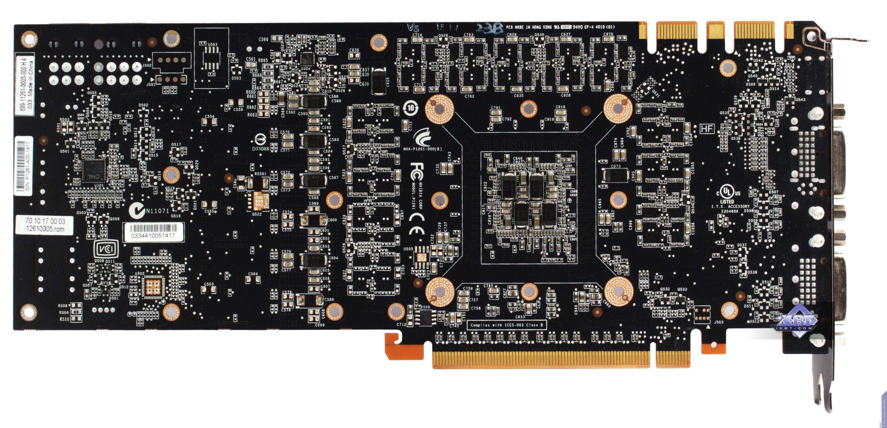

                  This might help, as you can see C636 & C639 are not installed.
                  • R_J
                    • Jun 2012
                    • 9555
                    This might help, as you can see C636 & C639 are not installed. Do you mean C590? should be the same value as C504
                      Originally posted by anotherdude
                      From reading round that 1 cap being missing shouldn't make too much of a difference it's when you see multiple bad/missing caps that problems occur, anyone able to shed some light on that?
                      Yes, if the missing ceramic cap is on a power rail (which it seems to be, in your case), then it's not a problem to use the card as-is without that cap. That's because the power rails usually have many ceramic caps in parallel, so if one or two are missing, it's not a problem. But if you just want to put something there for the peace of mind, generally 1-4.7 uF is used on the 12V rails and 1-10 uF on the low voltage rails (such as GPU V_core, RAM Vdd/Vddq, and etc.)
                      Personally, I've seen a GeForce 7600 GT that was missing a ton of those ceramic caps (the original owner used it for testing and always left it on his desk unprotected). It worked fine... or so until the Sacon FZ capacitors blew and took out the RAM.
                      The black "thing" with the "330 0n7pe" marks is a Tantalum capacitor. Given the marks, it should be 330 uF. Not sure what voltage, but probably 16V or less.

                        Thanks for clarifying. No not using any third party driver software, that was device manager assigning a driver from wherever (windows 10), ended up finding a older driver that works fine, had Infinite Warfare running last night at 720p normal textures for about 2 hours also done a few rounds of Unigine Valley, all seems fine.
                        I know the solder job isn't the best but rather than second guessing at a new Tantalum Capacitor thought it best to just get the original in place, the external legs are broken but contacts inside remain so at least it was salvageable.
                        Thanks again for everyone's help, another card saved

                          Yes C590 is the one that's been pulled off the board, the trouble was that I didn't know the values of the others without pulling them, all seems fine without it now anyway.
