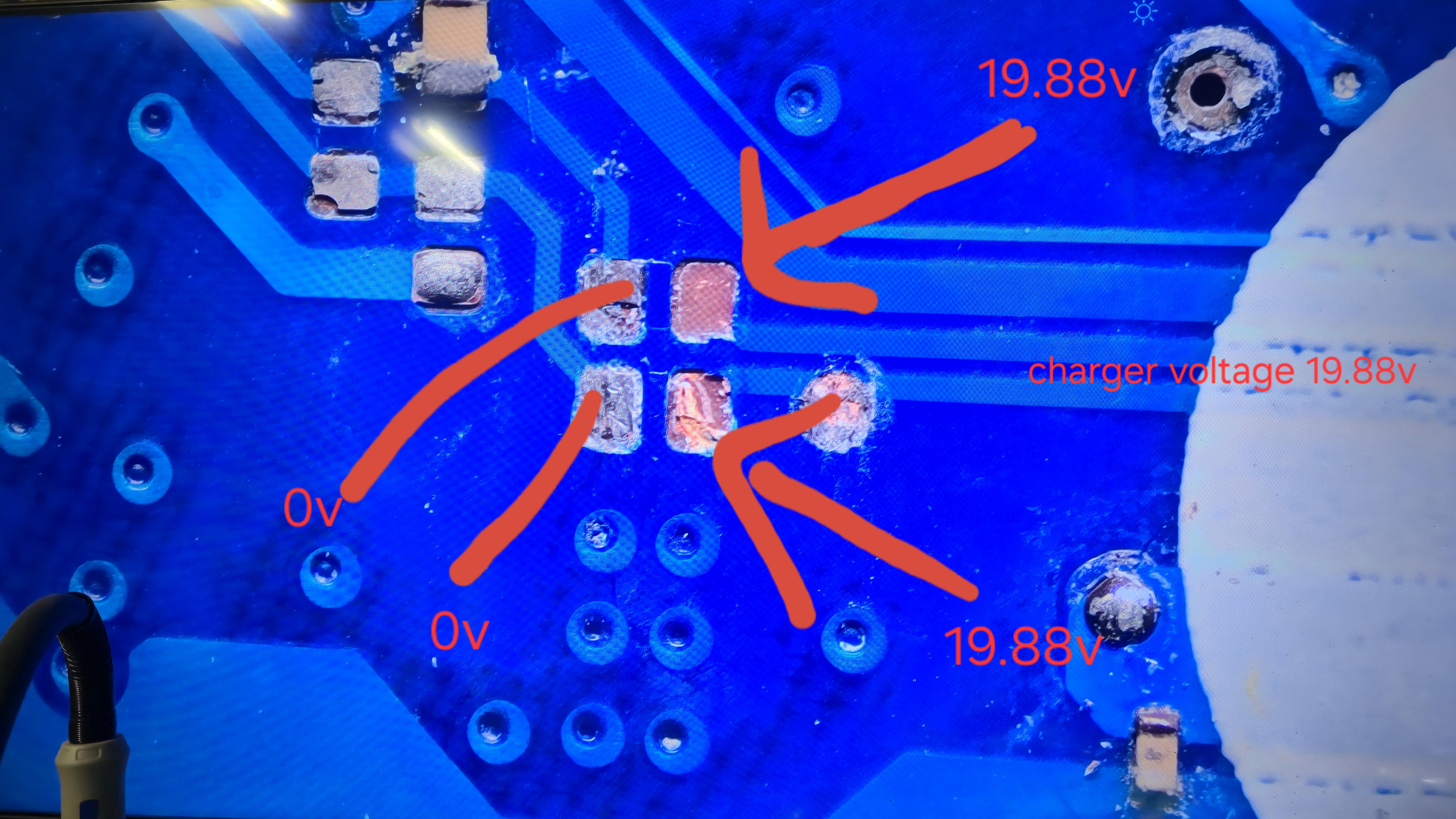

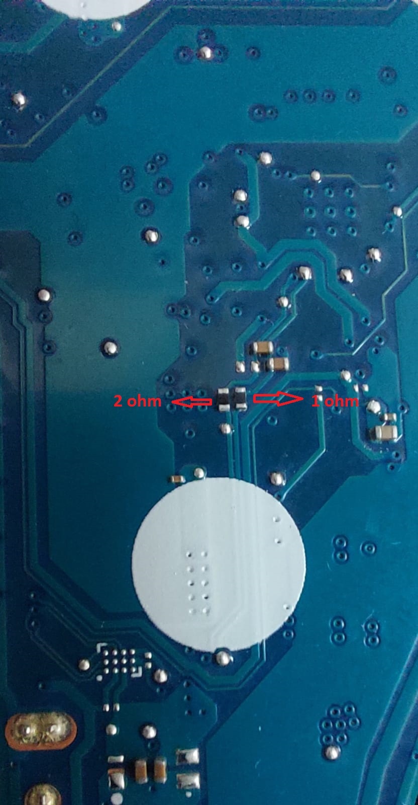

    DAOPDIMB8GO Rev .G not charging, missing components identification
    Missing components on the motherboard.
    Anybody by chance have the same model and can let me know what they are?
    Symptoms of the laptop are. Working, booting, seems fine except does not charge. Windows even says it's charging. But does not. Also charging light is on. So I'm guessing Im missing some Resistors
    Can manually charge the battery.
    Let me know if you need more pictures or have any questions.

      As the schematics for your board is not available, search for the charger ic (BQxxx, ISLxxx) on the board and find where these pads with missing components are connected to. Then find schematic where the same charger ic is used and use it as example.
      • Ryan Wurtz
        • May 2024
        • 30
        I requested access to the full schematic for the isl IC but they haven't gotten back.
        In the mean time I had a core ultra 5 (board model: DAOPDOMRBEO REV: E) with the exact same board layout.
        Had 1ohm resistors on each line (current sense lines I'm guessing as the lines came from under the current sense resistor) and a 0.1uf cap(I think it's a o.1uf, I stole a cap from a donar board with the same current sense circuit).
        Working and charging great so far. Thanks for the reply.

          Hi. Your missing resistors values are 2 ohm and 1 ohm as you see in the first picture.

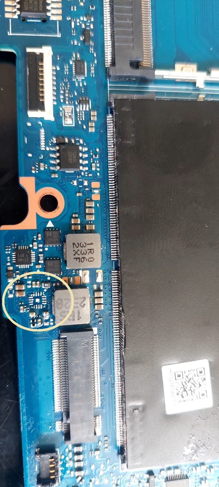

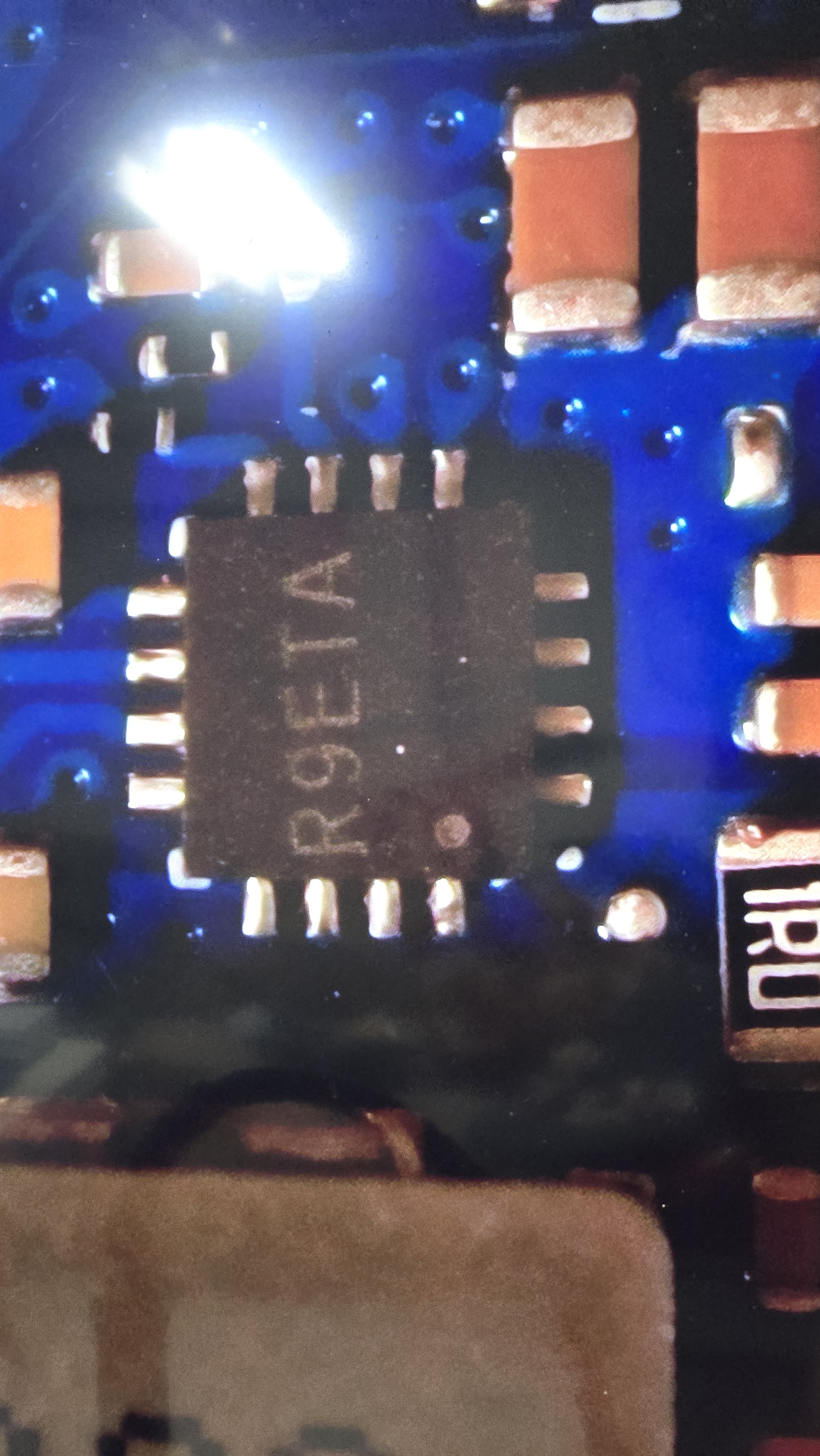

          By the way i need your help also. In the second picture the part is burning and i want to learn what is it? Can you help me? 🤔

              I am grateful to you. Thanks. Unfortunately i can't find any information about this part.

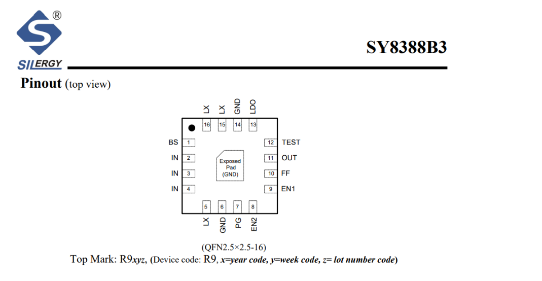

                R9*** - SY8388B3RHC
                Full datasheet (post # 3)
                https://www.badcaps.net/forum/troubl...p-please-folks

                  You enlightened me mon2. Thanks a lot Canadian friends.🖐
