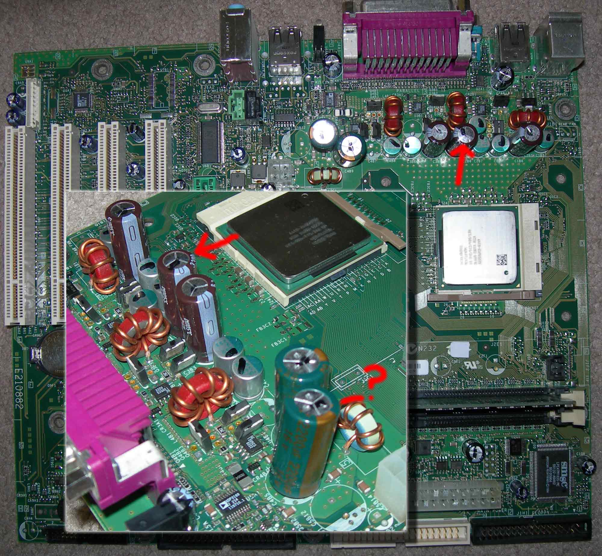

    Dell Dimension 4500 bad cap
    Have a client with a dead mobo, won't even turn on. Didn't notice the bulged cap until I started removing the mobo. The brown cap is a KZG 6.3v 3300uF. I suspect the green one has a bulged bottom, gonna desolder it and see what's up. It is a TEAPO 16v 2200uF. see pics...
    I was reading another thread that their Dimension 4550 had some noisy mosfets as well. I hope that isn't the case with this one. I assume it's a similar board. *crosses fingers*
    I'll update later...

    Re: Dell Dimension 4500 bad cap
    Is the case well ventilated? I'm just thinking because the KZG caps don't really like heat and that's usually why they fail. Otherwise, they are decent caps. Teapo on the other hand is crap when used on motherboards. I dunno, but I tend to notice that Teapos last longer in PSUs.
      That I know of Teapo problems are only seen on older motherboards.
      No one I know of has used 8mm or 10mm Teapo on MoBo's for a few years now.
      I still see 4 and 5 mm on newer mobos now and then but those never did have significant problems even on old boards.
      I see 8mm, 10mm, and up Teapos in newer PSU's fairly often and they don't seem to have any problems.
      I think maybe Teapo got better but mobo manufacturers are afraid to use them for caps big enough to read the name easily because of the earlier problems.
        Success!!! I replaced those 5 caps and all is well, at first I didn't think it was working because the comp would shutdown after about a minute or less of being on, Turns out I didn't have the CPU heatsink clamped down all the way. doh!
