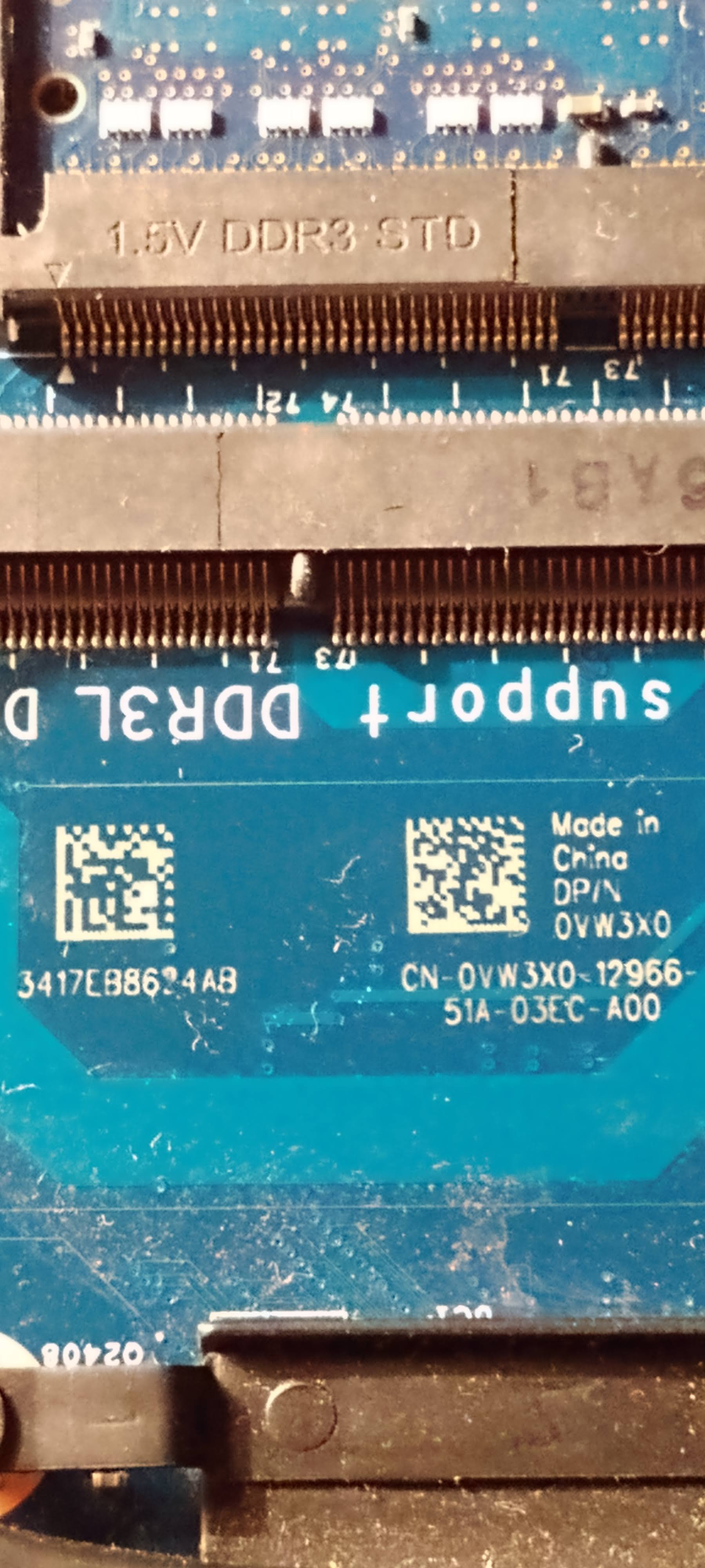

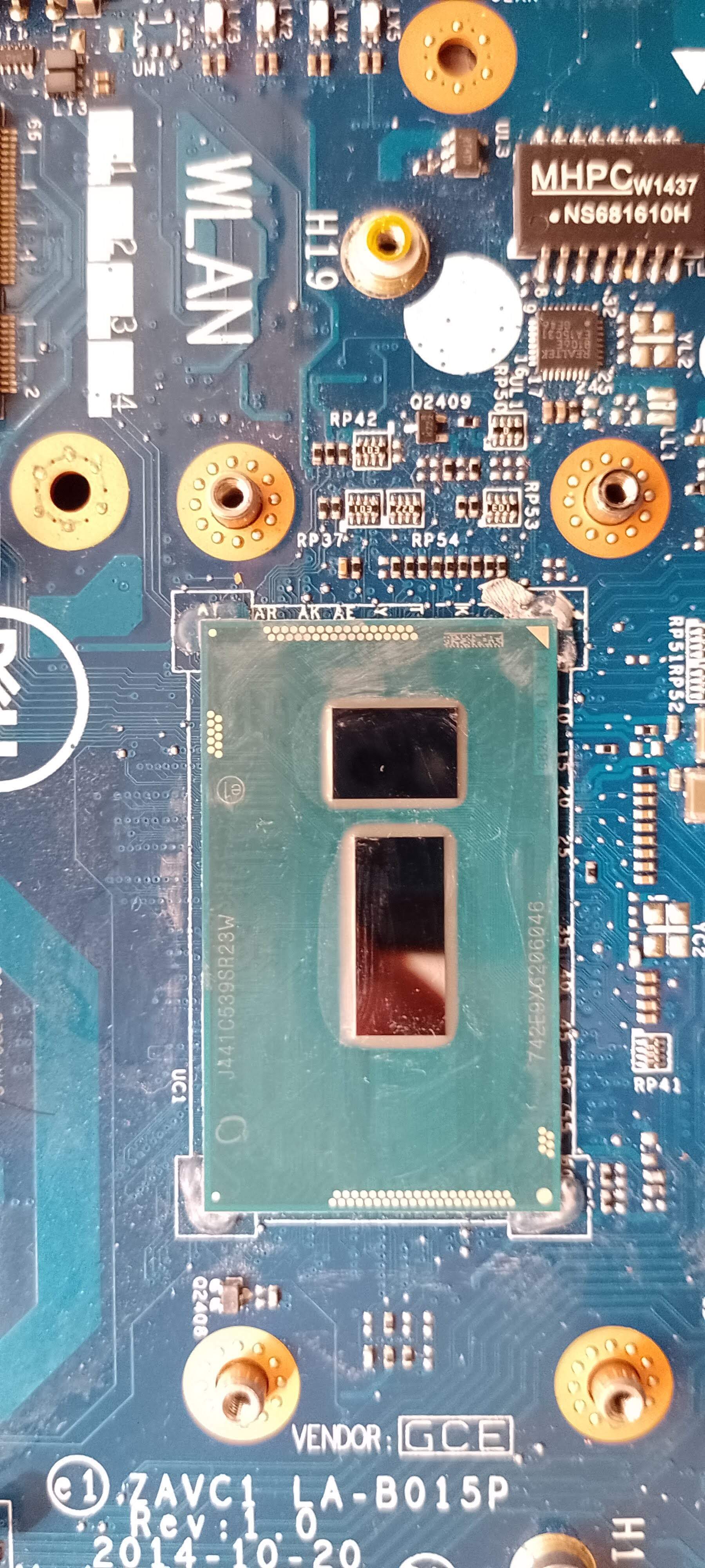

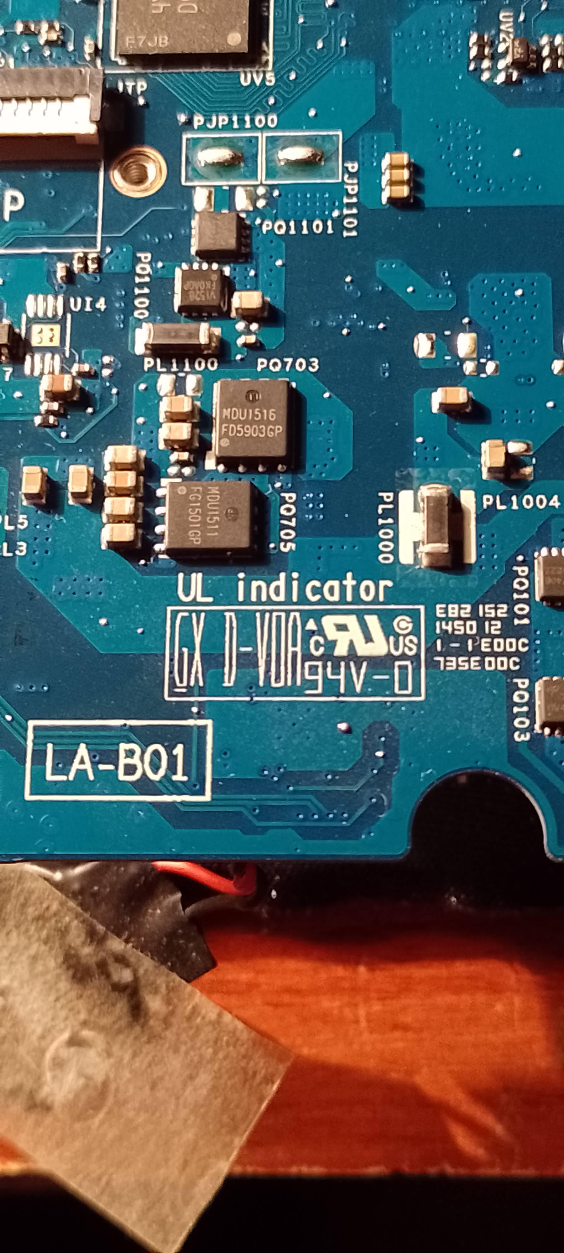

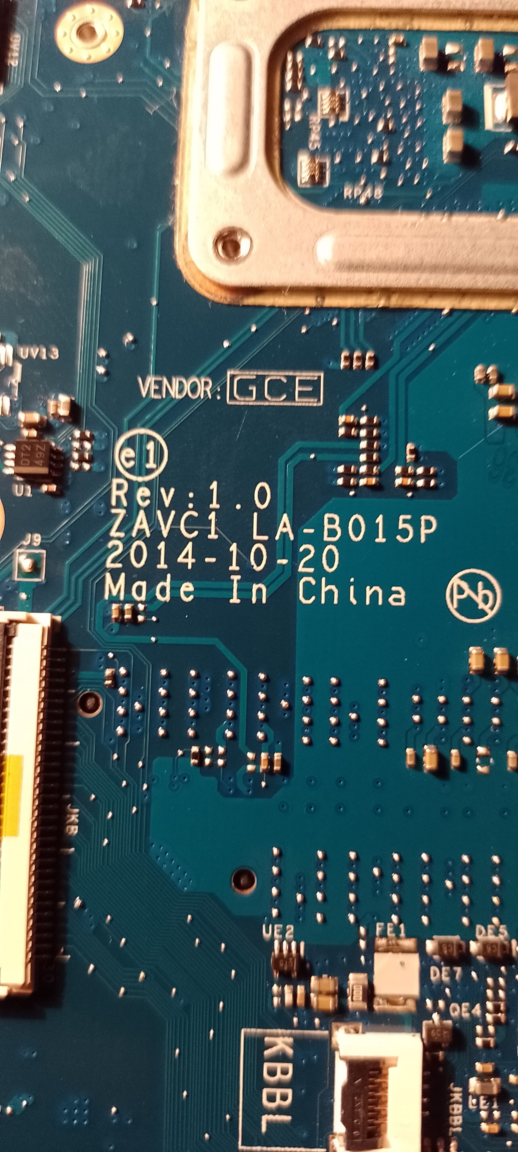

                Hello, mcplslg123​. I suppose that by markings you mean the characters printed there.
                I attached here some snapshots.
                Thanks.

                  LA-B015 is mb marking. Try disconnecting graphics coil(PL1002/1003). If it doesnt help
                  01 Shift RC99 to RC100
                  02.Remove RE3
                  03.Stuff RE5(20K)
                  This will make it UMA and if the problem lies in graphics card,you may get display.
