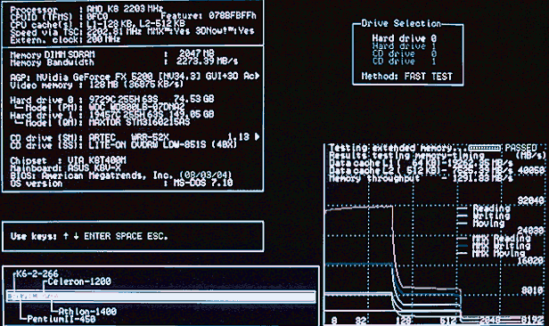

      Last night I have launched memory test with Memtest86+ V 2.01, found on Hiren's BootCD 9.5, this morning it was at pass 47% test 25% after 7 hours. I had stopped it because I prefer not to leave the PC on when I'm not at home; anyway when I stopped memtest no error were found.
      I don't know if such kind of test take so long time.
      Before this test, I have checked the board with PCCheck V6.05 by Euorosoft and all tests were good.
      I have seen that the program said memory bandwidth is 154MB/s and when he tested the memory the results were:
      memory read 20MB/s
      memory write 70MB/s
      memory move 12MB/s
      Memory MMX speed:
      read 40MB/s
      write 135MB/s
      move 20MB/s
      I don't know what those speeds mean and if they are correct

          Anyway today I have checked all voltages across capacitors with my Tektronix DSO TDS210 and I have not seen spikes, ripple or under/over voltage.
          After this test I have reassembled the PC and run a speed test with a tool, I attach here the picture.
          The benchmark result is strange, it seems that this CPU is worst than a Pentium 133MHz.
          As I don't know if this tool is reliable, I have tested my PC and the result are good.
          By the way, while on my PC the test take only few minutes, on the VIA board I have stopped it after 45 minutes while was running memory test.

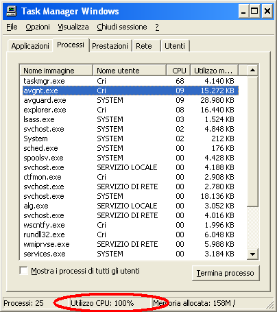

                    My last test gave bad result: with the original CAPS the CPU is always at 100% end the PC very slow.
                    Here attached the pics of system properties and processes. It took me 50 minutes to get them.
                    The strange thing is that the audio is good, but when you move a window it takes some time to refresh the video.
                    I don't believe, like kc8adu wrote, that using better capacitors will solve this problem, I have read a lot of thread here and the problems due to bad caps are quite different.
                    I'm convinced I have done something wrong or maybe something happened when I have taken the board from home to work and vice versa.

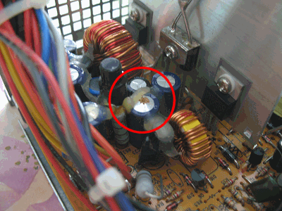

                            I have run some test after clening CMOS and I have seen the +12V was low; I have opened the main PSU and found one damn cap dead!! See the photo.
                            So I have replaced once again the PSU with a new one and run test again and this time everything was OK.

                              For the power suply - at last, change not only the bad capacitor, but all that are the same. Since they may look good but to leak after some time.
                              With some boards I have this issue. Replaceng only the visualy bad capacitors. After some time other capacitors, that are the same, but were not changed got bad.

                                i bet if you put the yxf back and replace the psu caps(all the ones on the secondary)it will be fine.
                                how low is the +12?
                                looking at your pic the burst cap is most likely on +3.3
                                but its hard to tell exactly.
                                i am just going on where it is in respect to the output wires.

                                  for sure I will replace all damn caps in the PSU.
                                  @ kc8adu: I have not replaced the cap as on saturday and sunday I don't work, so I have not all tools to do the work, I will do it tomorrow.
                                  Don't know if the cap is on +12V, anyway in the test I had 2 warning because the +12 dropped to 11.3 and 10.9 two times.
                                  I replaced the PSU with a new one and the voltage with the same test has its lower value at 11.55V.
                                  Tomorrow I will check the PSU and I will let you know if the damaged cap is on +12V.

                                        By the way kc8adu was right: the burst cap inside the PSU (1000uF 10V) was on +3.3V and not on +12V. This morning I have replaced all caps, they were all "Jun Fu"; I have measured them and only 2 were still within specs or at least they had the right value and low ESR.
