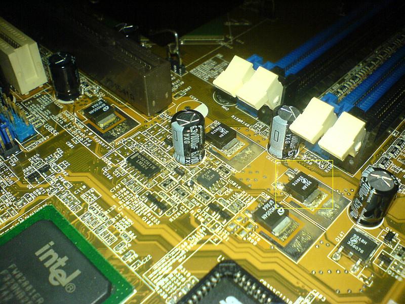

    hi there
    i've got a problem with my Asus P4C800-E Deluxe Rev. 2.0 i recently cleaned up.
    https://www.badcaps.net/forum/showth...1038#post50942
    always gives me 1 long and 2 short beeps. (AMI BIOS)
    this means its a graphics card problem (no gfx card found or faulty).
    the problem is that i tried 5 different (known good) cards. AGP & PCI. none of them works
    weird thing is that it doesn't beep at all if i put some MDT 512MB DDR333/PC2700 RAM sticks in there. it only beeps with either my Kingston 512MB DDR400/PC3200 or my 512MB Elixir (same speed). o.O
    i switched everything (PSU/CPU/RAM/gfx card) but its either beeping or completely dead. (all test components (except the board itself) are known to work fine)
    for now i put my attention on the caps.
    is has OSTs for VRM out and KZEs for VRM in. rest of the caps are all Rubycon YXG. none of them visibly failed, but i don't have an ESR meter so i can't test them now
    impressions (after cleaning)
    and the RAM sticks used for testing...
    i suspect those OSTs but i dont have matching caps here now and i dont wanna squeeze bigger caps (can size) in there..
    any suggestions what to look for!?

          measure vagp.
          had 1 board with a shorted ost there and same symptom.
          across the caps nearest the slot.

                            Do you have check the temp. of northbridge and southbridge chips when power up the board(check the temp by your finger is ok)? The temp is normal or extermely hot?
                            Ans also check the voltage of the mosfet in photo, it seems a little brun.
