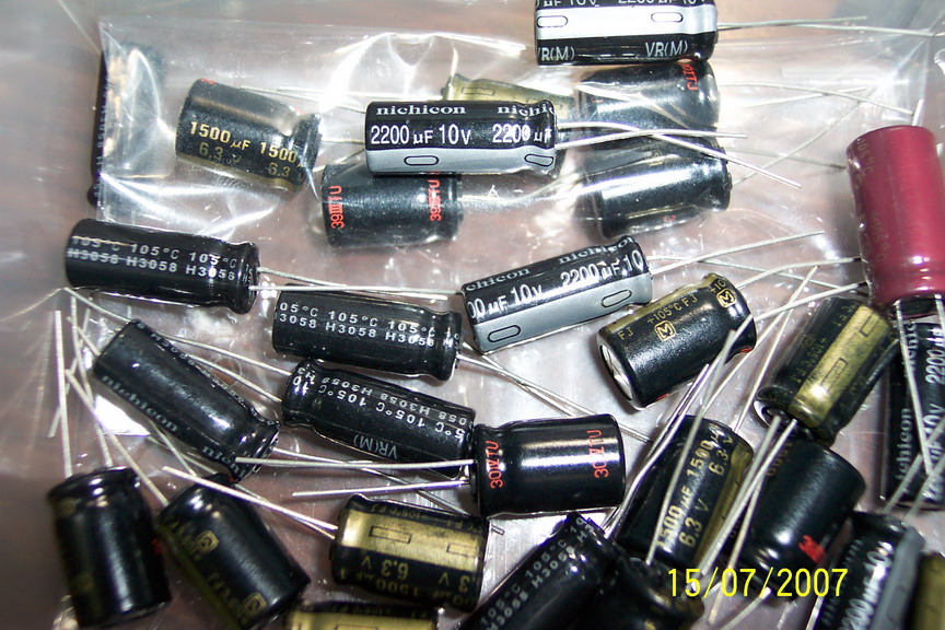

                        I Have gx270 optiplex dell computers .
                        I replaced the 9pc 1800uf 6.3v with 2200 10v (same size),
                        3pc 1800uf 16v with 2200uf 16v and 5pc 1500uf 6.3v with 1500uf 6.3v .
                        I still get a thermal shutdown .
                        do I have to replace other caps on board?
                        thanks
                          You found some 2200uF 10v 8mm caps? Lets see some pics of those!!

                            Re: Dell OptiPlex GX270 - multiple bad cap failures
                            Hi Topcat
                            is there a problem with 2200mf ?
                            20% more in value
                            I can use 8pc instead of 9
                            • Per Hansson
                              Must be general purpose caps then?

                                http://products.nichicon.co.jp/en/pr.../alum_list.cfm
                                https://cdn.badcaps-static.com/pdfs/...120706ef4b.pdf

                                  those nichicon look odd, yeh VR is general purpose but ok lower down on the board.

                                    as I am new in your form and my knoledge about caps is limited
                                    I think to get a general purpose cap is better than a deffective one.
                                    I know that low esr is recomended and I tried to find it in RS ( Egypt).
                                    https://cdn.badcaps-static.com/pdfs/...5a866038c4.pdf
                                      Hi Topcat
                                      20% more in value
                                      font looks wrong on those nichicons.
                                      fakes?

                                        According to the PDF you linked the 2200uF Nichicon VR cap should be 10x20mm and –40 ~ +85°C

                                          Yeah, those look like fake Nichicon VRs. Those Malaysian Panasonic FJs would have been a better bet at the VRM O/P - not as dependable as the Japanese FK/FM, but still good enough.
