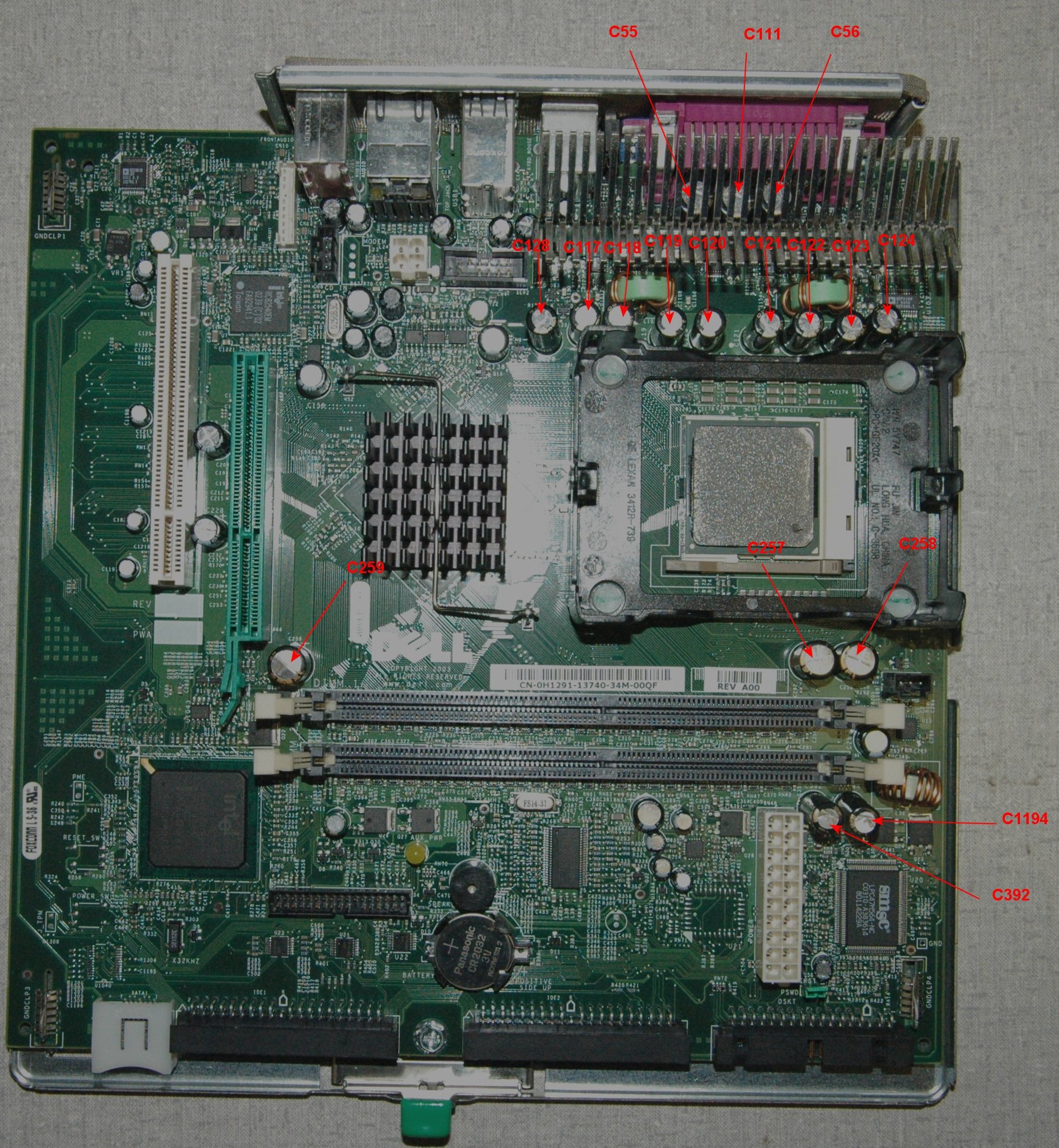

                      Re: Dell OptiPlex GX270 - multiple bad cap failures
                      Bad Electrolytic Capacitors on GX270 Mother Boards - What is the Plan?
                      We have more than 2,200 GX270SFF computers. Of the mother boards that we have inspected (~80), an unacceptably large number of them have at least one defective electrolytic capacitor. The computers that are failing have been in service for approximately 2 years.
                      The defective capacitors are Nichicon “Ultra High Reliability UHN, UMM series” identified by a black sleeve with copper colored text and “+” style pressure vent. One or more of the capacitors listed below is defective on each bad board:
                      C55, 56, 111 - 1,800 µf, 6.3 VDC
                      C117 through 124, 128, 392 and 1,194 - 1,800 µf, 16 VDC
                      C257 through 259 - 1,500µf, 6.3 VDC
                      In light of the magnitude of the problem, we are concerned about getting re-worked boards with Nichicon capacitors at the locations described above. We prefer for replacement boards to have no Nichicon UHN series capacitors.
                      So far we have not seen problems with the capacitors manufactured by the following companies:
                      Rubycon (K style pressure vent, black sleeve with gold text) - this is the preferred component
                      Sanyo (K style pressure vent, black sleeve with white text, lower capacitance values)
                      Unknown company (T style pressure vent, logo is M inside a circle, black sleeve with white text)
                      KGM (Y style pressure vent, brown sleeve with white text) not normally used in Dell mother boards
                      To date we have not had problems with the GX280s, but we will be monitoring them too.

                        #91
                        i doubt if there will be a recall. it would spark class action.
                        are you sure about that or are they HM(M) HN(M).
                        sounds like panasonic (ok)
                        sounds like chemicon (ok)
                        there have been no reports of reworked boards. the new boards had rubycon in place of nichicon
                        I would like to see them be more proactive….maybe a RECALL!!
                        you have a lot of boards therefore you can throw your weight around with dell. many boards though - too many to inspect. the only idea i can give you to present to dell the size of your problem and insist on a proactive replacement would be :
                        The problem is isolated to a specific capacitor supplier which was used in system boards manufactured from April 2003 to March 2004. The defective Nichon capacitors were placed on two manufacturers' GX270 motherboards between 04/01/2003 to 03/20/2004.
                        whether that was the final date range i dont know. perhaps someone on a dell forum knows how to identify the boards with the bad nichicon from the service tags.

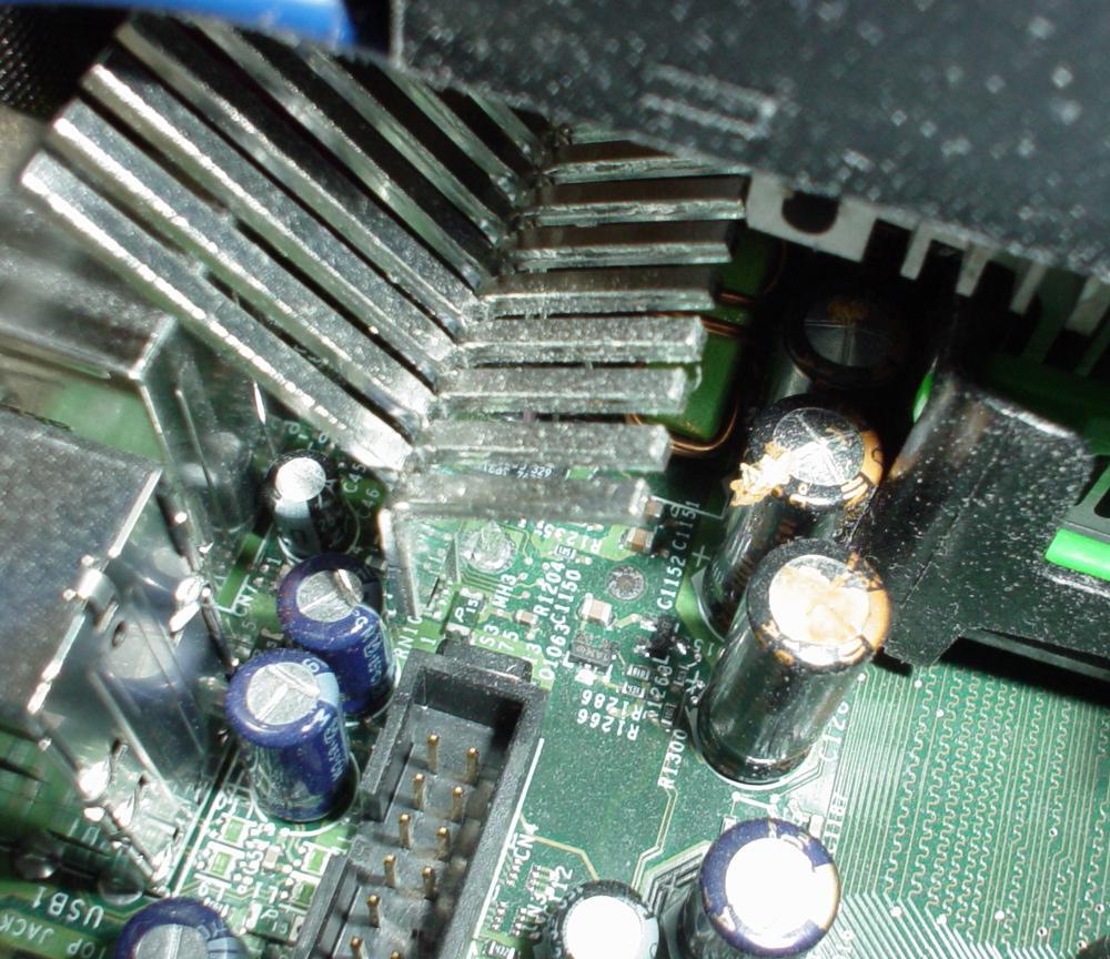

                              I know that the Optiplex GX270 boards had Nichicon caps that were bad, but has anyone seen Rubycons fail on this board? I've seen five boards now that have a Rubycon cap inbetween the RAM slot and the AGP slot that will either bulge or leak.
                              Has anyone else encountered these Rubycons with this problem?
                                I got a corporate batch of about 200 GX270 boards, and I had about 7 with the cap you indicated failing, and it was a rubycon MCZ. My guess for the failure was the HN's that failed, causing the classic chain reaction. I never saw one with a failed MCZ that didn't have the (3) 1800uF 16v mains that had failed as well.
                                  scarfman : are you also talking about boards with both nichicon and a rubycon fail on the same board?
                                    I should have taken some pics, I had one last night............ Yes, they're mixed, some rubies and some nichicons. Its a rare occurance, and its only that one cap right behind the AGP, so its not the fault of the cap. The nichi's always fail in that position, which is no shocker, but on a rare few, I've seen an MCZ in that position fail as well. It had to have been over-volted or the result of a failure further up the line. After recapping them, they came all worked. Out of the 200 or so I recapped, there were no duds.
                                      The ones I'm referring to usually have only Rubycons on them. The last 4 that I've replaced were ones that Dell had already replaced the faulty Nichicons with. I think the faulty Rubycons though are dated around 0331 (latter half of 2003).
                                        what may be happening is the failed nichicons no longer clean up the ripple so the next victim on the same line gets to clean it up.grossly exceeds its ratings and poof!
                                        this also happens when the psu's caps are open.
                                        this type of cascade failure can happen with ANY brand of cap.
                                          I was wondering if it might be more of a heat issue. If you look on these boards right next to that cap are two small black chips, I'm assuming are voltage regulators. If you touch those chips after the system has been running for a few minutes they are very hot. I've even seen many boards where the surrounding area around those two chips is discolored (kind of a yellowish or orangish tinge) instead of the normal green.
                                          Any ideas?
