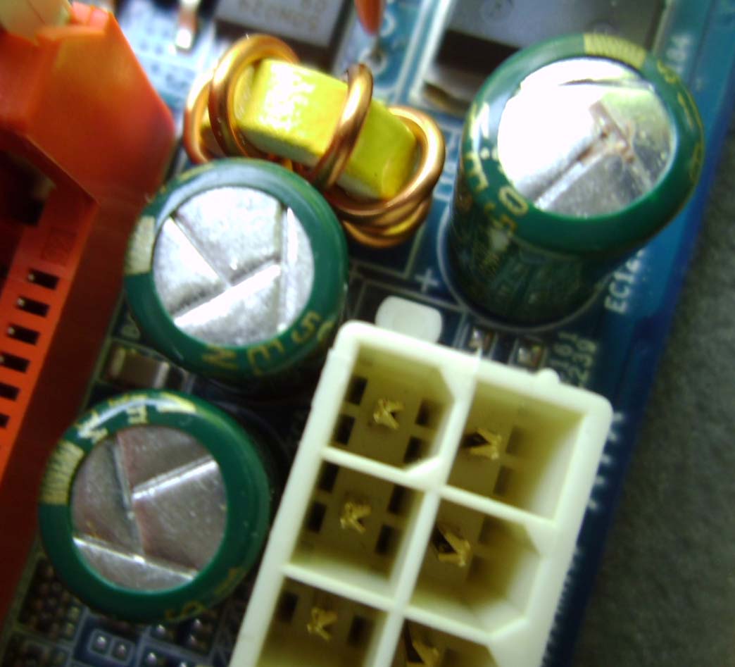

    GA-8I915P Duo Pro with bad Sanyo WG
    Probably should have left this in its kerbside system box, being not really worth the effort to fix
    Maybe caused by the "400W" Codegen power supply I left behind - ironically its KZG and HM appear fine (3rd pic), along with some of the WG (bottom right of 1st pic, left in 3rd)

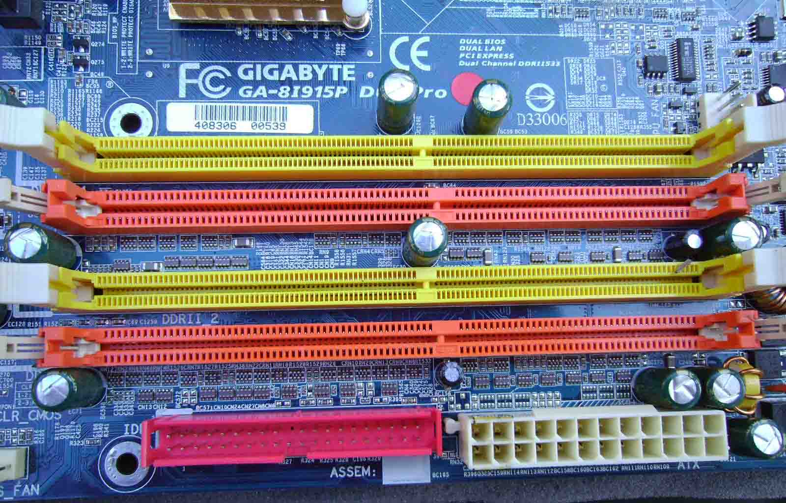

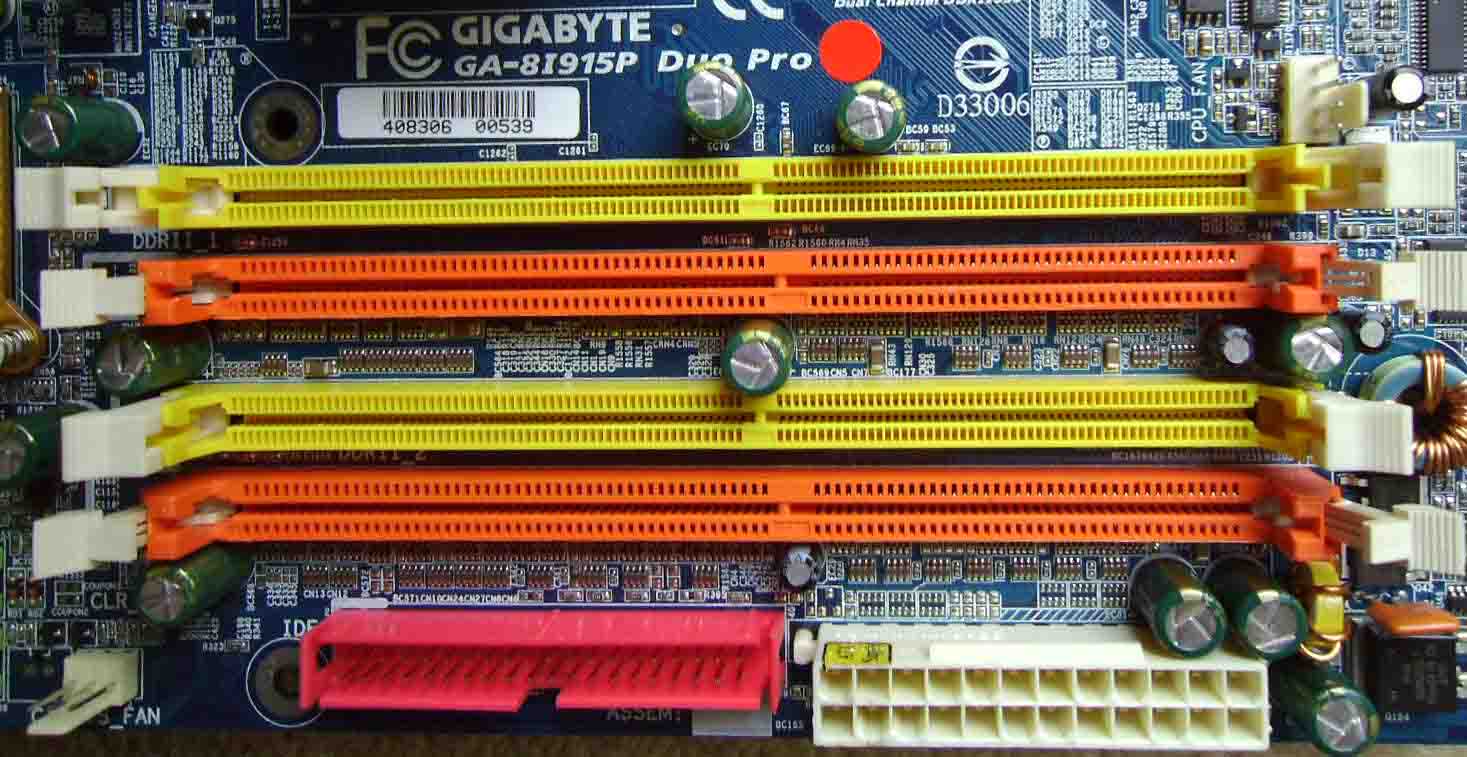

      thats strange... the ones around the ram slot doing the vdimm filtering are bloated but the ones by the atx connector are fine.
      in the second pic, the wgs underneath (or to the left) of the video card slot are bloated as expected. it looks as if a hot and powerful video card was used.

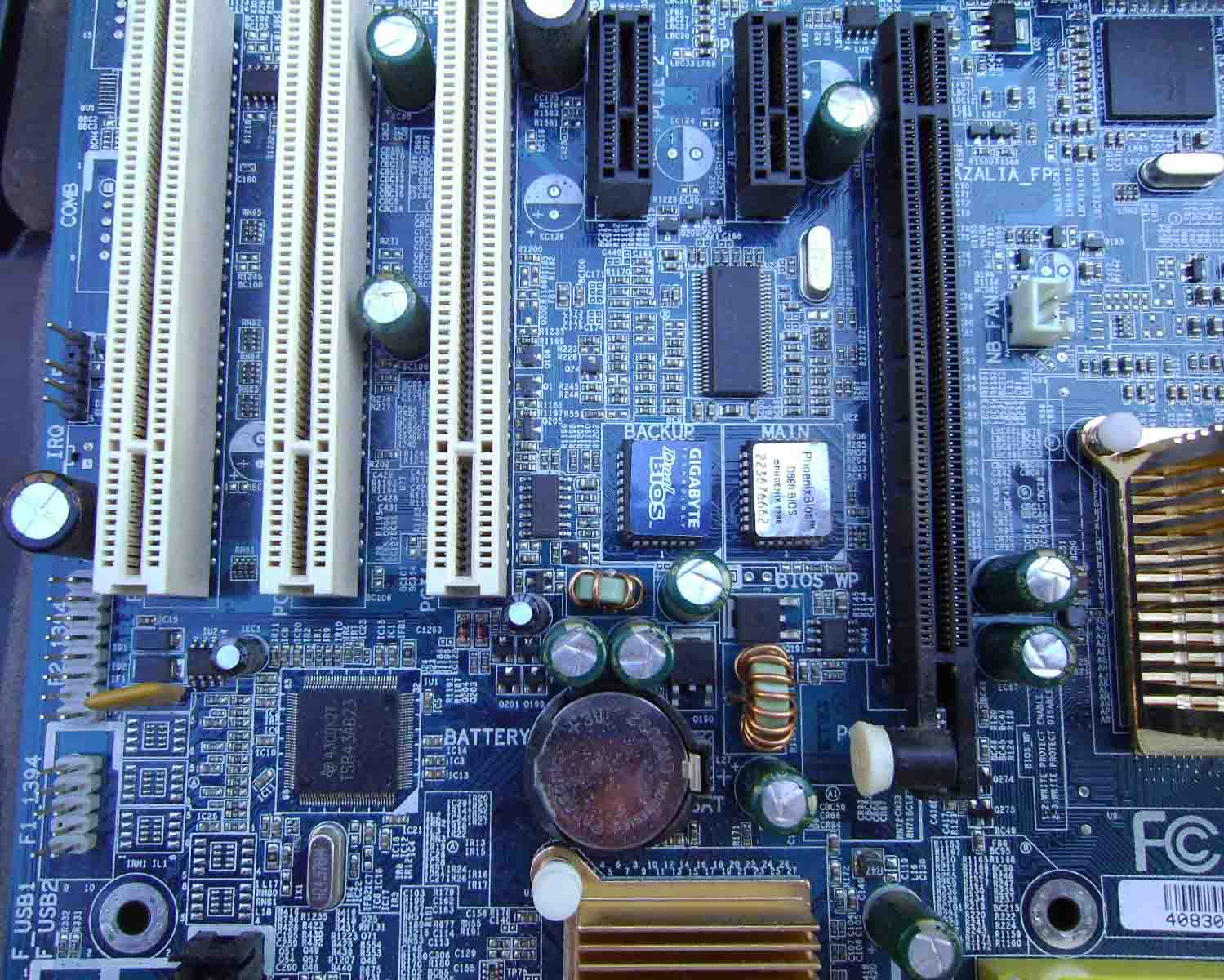

      also, in the third pic, its kinda strange the wg by the northbridge is fine while the ones around the dimm slots are bloated... hmm...
      btw what cpu is under there? if its a 3.4 ghz or faster cpu, the system will function great as a heater during winter...

        ...Massive +5VSB overshoot (or +5V or +3.3V) by any chance? Usually, it's the 1000uF 6.3V KZGs that go bad like this on these boards en masse, or the HMs (2004 datecodes), not the WGs... then again, the ones by the ATX connector look fine so perhaps not. If the board works after a recap, maybe the WGs went bad by their lonesome...

          Re: GA-8I915P Duo Pro with bad Sanyo WG
          Radeon X800GT - got that as well
          P4 3.0GHz
          Works as is

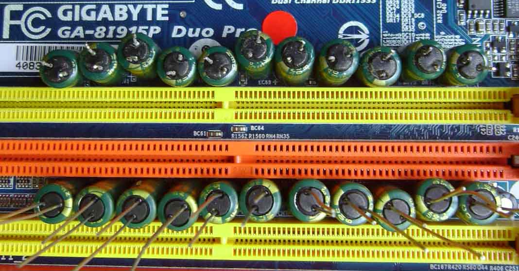

                              Here's a work-in-progress, showing the bulging bungs of the eleven Sanyo caps being replaced, together with their Suncon replacements
                              Perhaps I should have replaced all of the Sanyo, but, I didn't
                                And the finished project
                                As I said, the Suncon caps are genuine or a convincing counterfeit

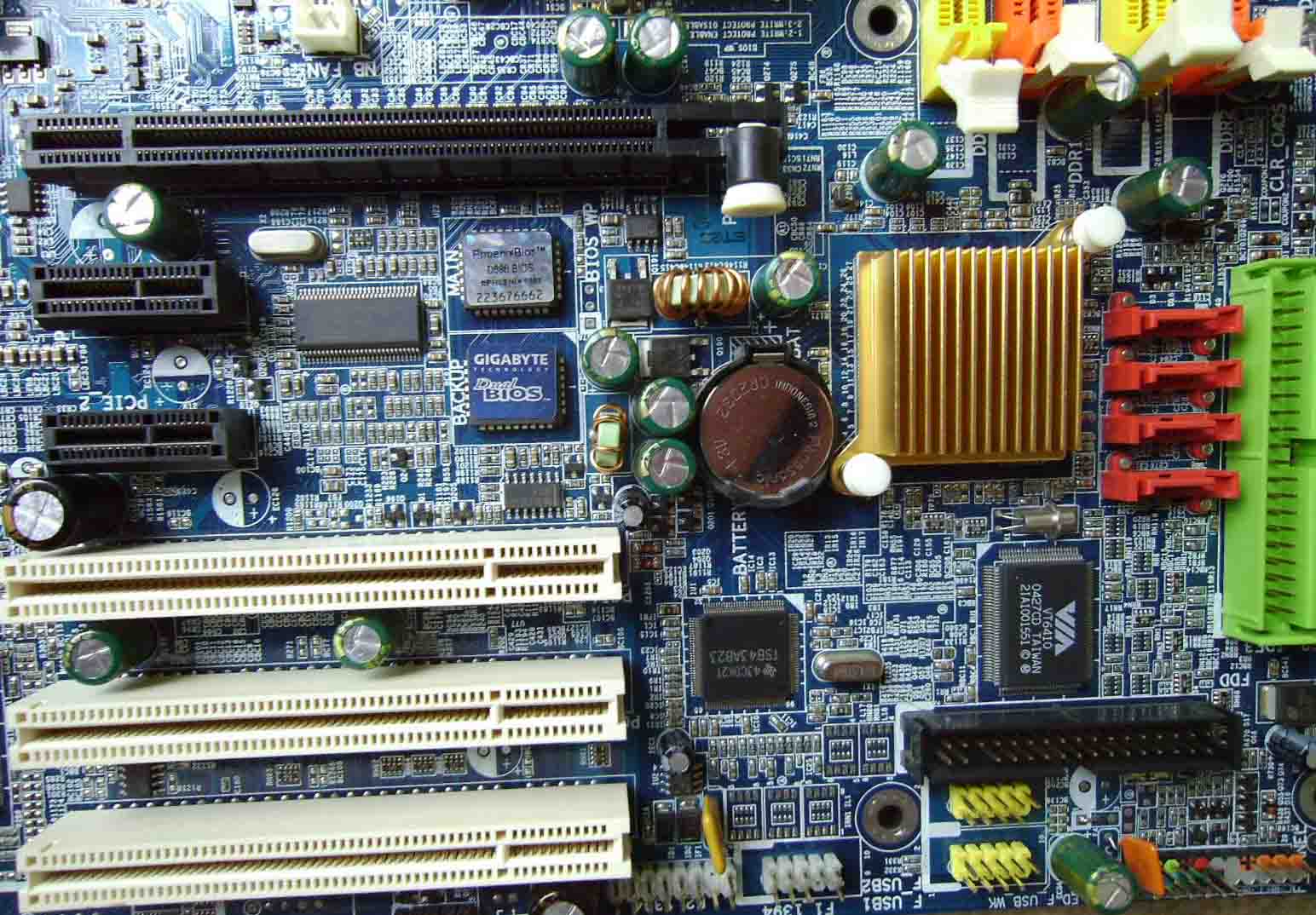

                                      Getting this from storage recently, noticed cap pictured
                                      Had nasty feeling, thinking it was one of the ones I'd put in
                                      Not so, one of the originals, pushing its bung out from the bottom too

                                        It's probably safe to say the original batch in entirety is bad (all the 1000uF 6.3V WG that were original to the board, not the replacement caps). Best to replace all of the old ones, if you would deem it be worth the time and money on a board of this age. But if you would go that far, the KZG and 2004 dated HM could probably do with replacements too (as well as the lone G-Luxon?), even though I'd guess they haven't popped their tops or bottoms.
