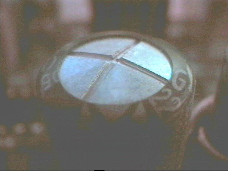

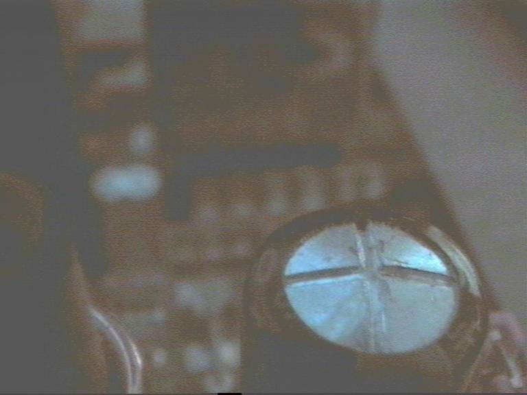

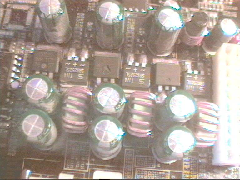

    Just last week, December 23, 2004, my K7S5A V1.x died. Upon further investigation I discovered the following:
    !! BAD CAPS !!
    I received an ECS K7SEM with the same "GLUXON" capacitors in the power section of the mainboard. So far the GLUXON brand capacitors have proven themselves to be hit or miss in quality. Hind sight is 20/20, I should have checked my K7S5A...so my loss is now your gain in knowledge.
    As a result the power section of the board destroyed itself, the FET's are destroyed, pieces have literally exploded off of their packages. Catastrophic failure.
    This is just a heads up to fellow K7S5A owners. If you mainboard has the GLUXON brand capacitors try to have them replaced by a competent technician.

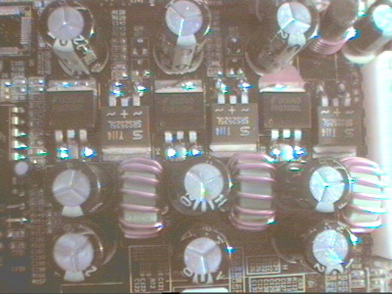

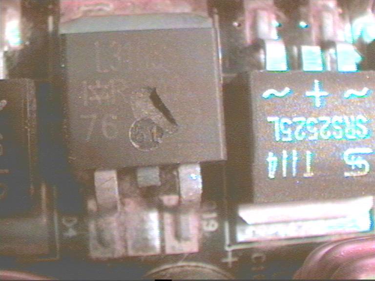

                I've repaired two of these damaged K7S5A boards.
                The 3 mosfets were bad on both boards, they were so hot that they desoldered themselves from the board The 3 double-diodes were good. Some of the smaller caps around were destroyed from the heat.
                There are 3 mosfets in that VRM, each has two small SMD transistors near its gate. Some of these transistors were also bad. The mosfets are connected parallel, only each gate is driven separately through that small SMDs but they're all driven by the same signal.
                Repair:
                Remove the big caps (and also the smaller ones near ATX connector and the one near KA7500B), remove fried mosfets. Then check if the double-diodes aren't shorted (there is some resistor connected across them, so they don't test like a diode). Then check the small SMD transistors - it can be tricky (and if you leave one bad there, the mosfets might short again). I used "diode test" on a multimeter - checked each direction on each transistor and compared to the other ones, then removed the suspicious ones and checked out of circuit. Replace bad ones, then replace the mosfets (I used better ones from dead Abit KT7A board) and recap.
                I've read that some K7S6As fail exactly like this - but I haven't seen it personally yet (I've had only a working one). The circuit is a bit different - all mosfets are driven only by two transistors which are not SMD but TO92 (easier to replace).

                • Rainbow

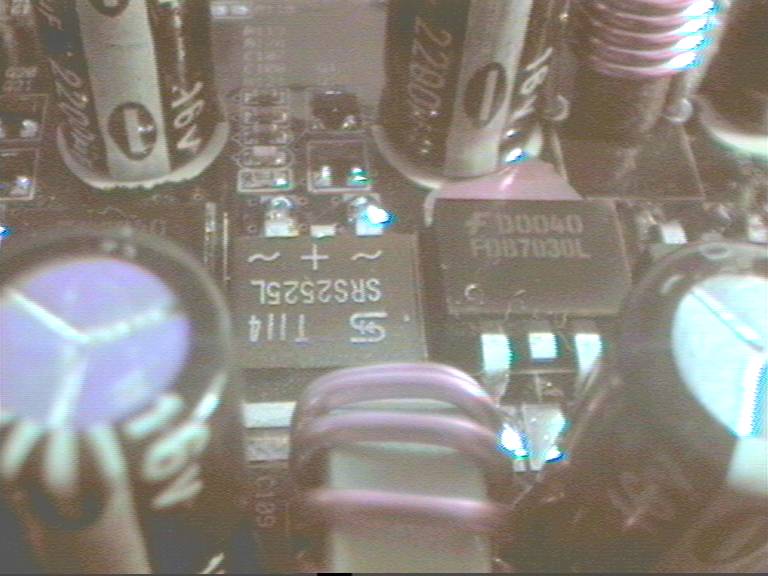

                  Some photos - first 4 before repair, last 3 after.
                  • PeteS in CA
                    • Aug 2005
                    • 3581
                    • USA, Unsure of Planet
                    Re: ECS-K7S5A/ PCCHIPS-M830LR with GLUXON = shite
                    I noticed you replaced the MOSFETs, too. The center one in the before pic had a piece missing from its case. I also noticed that you used Fairchild in place of IR. Is Fairchild a favorite or what you had available?

                    • Rainbow
                      • Aug 2005
                      • 1374
                      All three original mosfets were shorted and they desoldered themselves from the board I've downloaded the datasheet and compared the most important parameters (is logic level?, RDS(on), Id) with mosfets found on boards in my junk pile. The ones I used were from dead Abit KT7A board. They're better than original mosfets (lower RDS(on) -> less heat, higher Id). High quality mosfets like these can be expensive and hard-to-find - and I have a lot of irrepairable boards with them
