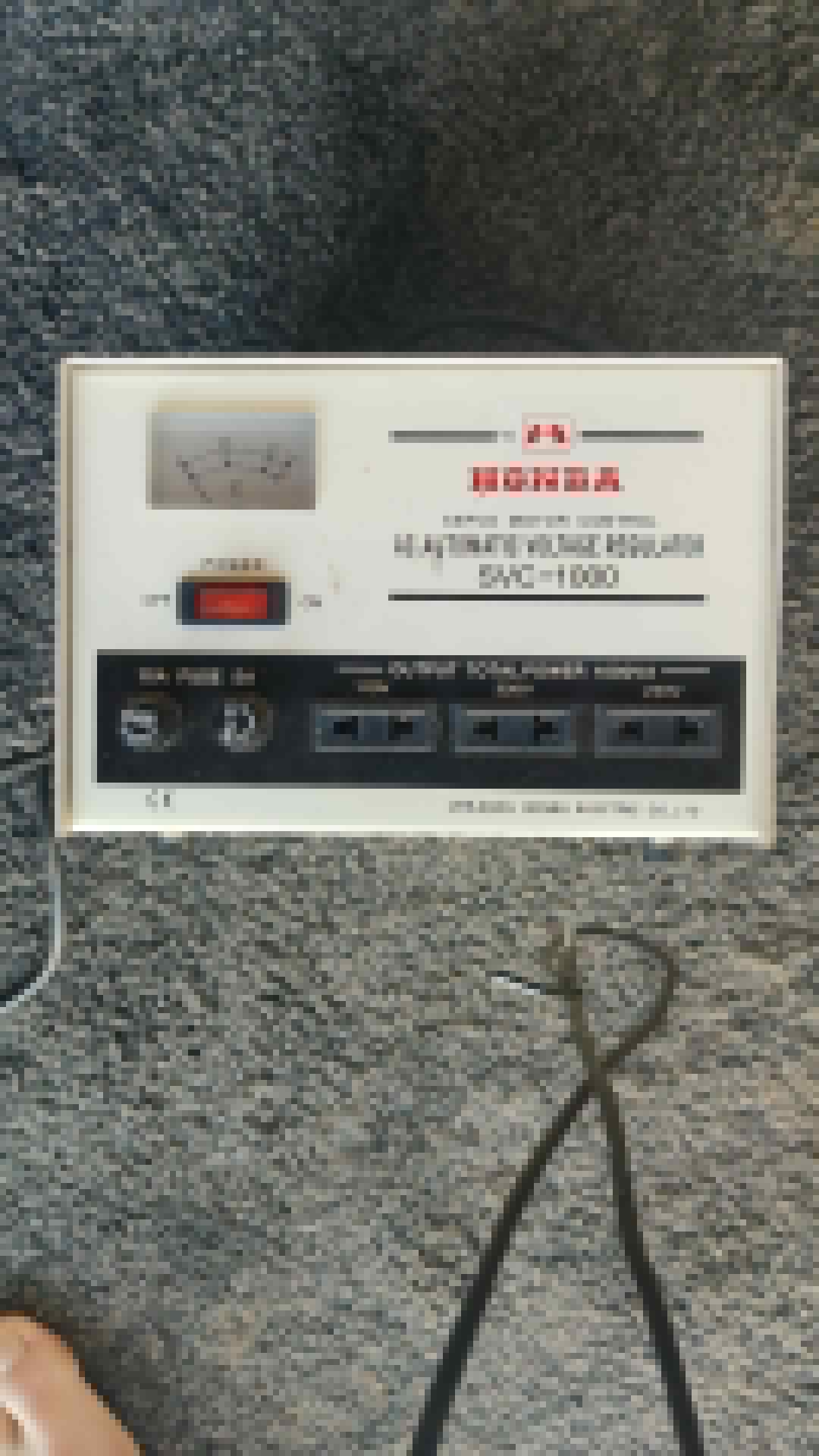

    Hi guys
    One of my customers sent me a pic of a Honba SVC-1000 Automatic Voltage Regulator today and asked me what it is.
    Hmmm... Aye... Well... I said, (not wanting to look stupid)......that's an Automatic Voltage Regulator that is
    So he says, aaahhhh in that case then, seeing as you know what it is, you can have it... for free.
    So it looks like I am now the proud owner of an Automatic Voltage Regulator arriving next week
    But what possible use is this thing? Google told me.... once I insisted I really really did NOT want to look up HONDA SVC-1000, absolutely nothing useful at all
    So, what is it - and don't some clever sod tell me it's a bloody Automatic Voltage Regulator!!!
    Sorry pic is shite - it was from whatsapp and looked OK on my phone it has 1x 110V output and 2x 220V total power 1000VA

    It's a voltage regulator that's automatic
    Used to regulate the voltage in critical situations or where fluctuations are undesirable.

      i guess u could use it if u were in a third world country and your power grid or ac line is unstable. the avr will help to prevent and reduce brownouts of the ac line, so this should make the apfc circuit and primary caps on smps last longer.

          Re: Honba Automatic Voltage regulator - what use is this for?
          I have seen audio/video AVR's that have a variac inside with a motor to move the wiper automatically to keep output voltage reasonable.
          Others use an autotransformer with relays that will switch-in say a 10VAC boost or cut to help with brownouts. These are kind of useless because they have three output levels.
          Either way, the thing is surely heavy, filled with crappy capacitors or dead relays.

            Well let's see - because it's mine now apparently - so next week I'll open in up and see what's inside it.
            Ahh it's made for use in the UK then
            So it's not an isolation transformer, as well as being a voltage regulator?

                i would say it's either a multi-tapped isolation transformer with a bunch of triacs or relays,
                or it's a transformer with an "interference" winding that can fuck with the field - although those can usually only drop the voltage and not boost it.
                a lot of big generators use this method instead of regulating rpm.

                    found some info
                    https://webcache.googleusercontent.c...-/303387855478
                    https://hossoni.en.alibaba.com/
                    Hongbao Electric Group Co ,Zhenhua is one of their own brands.HONBA is probably a clone made by Zhejiang Honba Electric Co

                      Yeah it does look just like one of those. Probably not any use for anything (to me) if it's a tapped auto-transformer and not worth the cost of posting it somewhere else either by the looks of it. Still it's caused a little interest on this forum so I will post some pics once I get it.

                        it says servo motor, so it must be a reostat or variac.
                        sounds usefull.
                        if not then the case is nice!

                          You win the potato picture award of the century with the picture in your OP dicky96!!!
                          As stj says the ad on eBay linked by SMDFlea says it has a servo control so must be a variac, really useful device then!

                              It is likely similar to the one in this video https://www.youtube.com/watch?v=NdtjdoDtNgE. Basically a servo motor driving a variac
