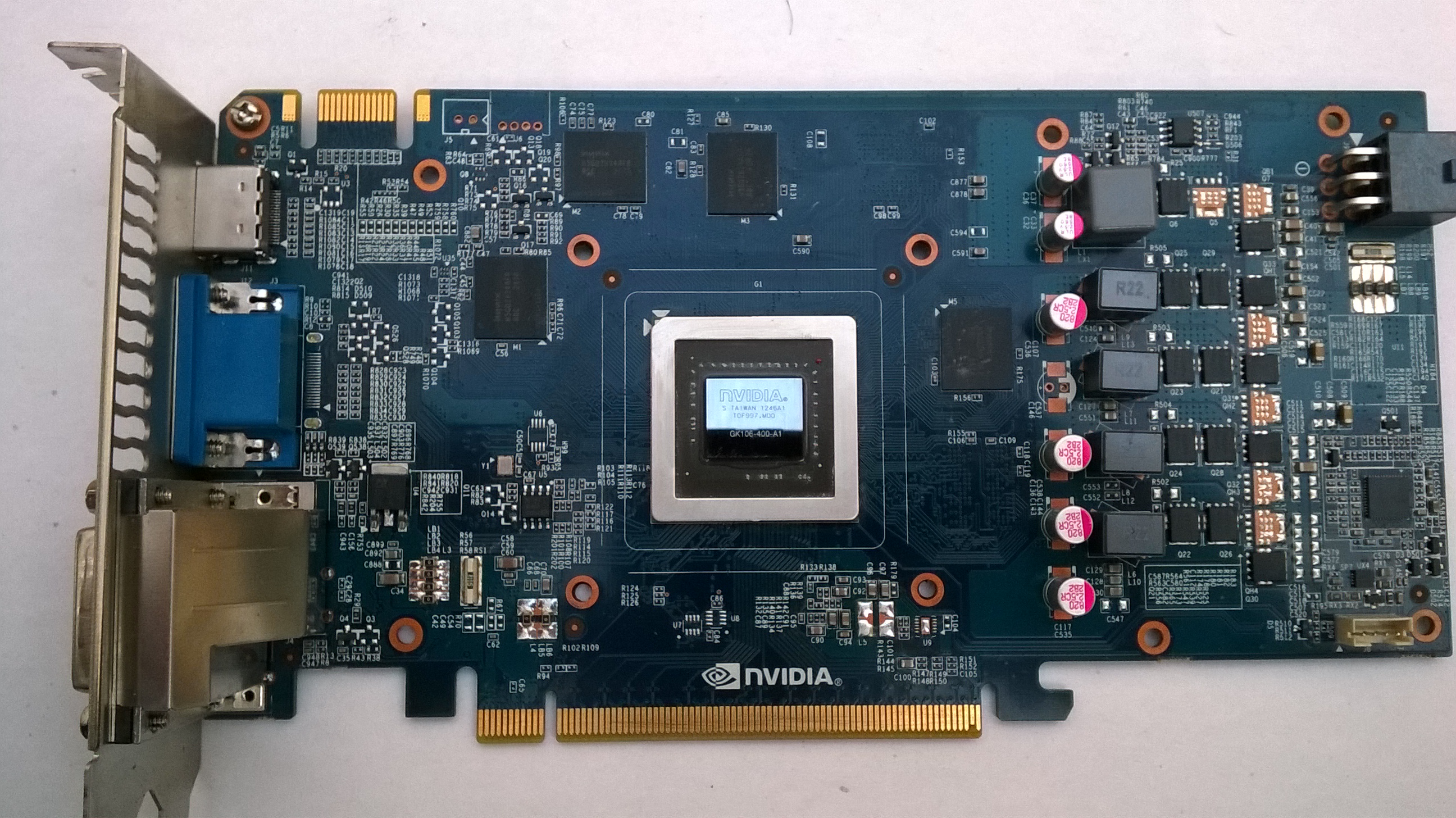

    I have an Nvidia gtx 660 graphics card that runs fine in safe mode but when you try and boot into windows normally i'm getting no video at all after the welcome screen just a blank screen and with just the standard vga driver installed but when you install any nvidia drivers and boot normally it just stays blank even though i've tried various driver versions too ?

    Broken soldering on GPU. You can try to reflow it but it won't last long, sending it in to a shop for reballing would be the proper solution.
    However, you may find that it is not worth repairing, and it is better value for the money to upgrade to a new card.

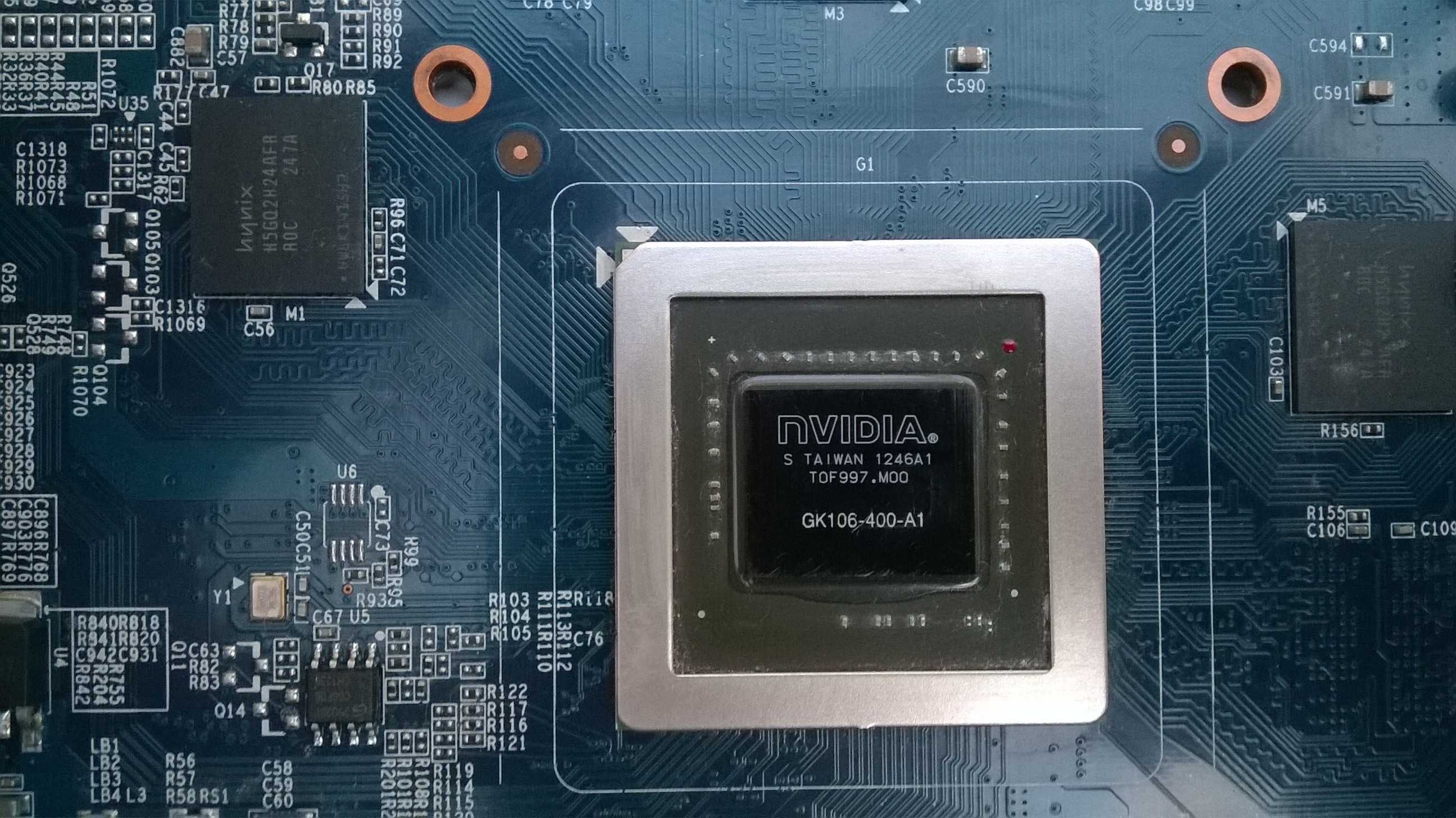

                • smallprint
                  • Nov 2010
                  • 86
                  Re: Sparkle nvidia GTX 660 black screen
                  Deffo not the gpu i've just tried reflowing it and it's still doing the exact same thing i think it may well be time to think about RMA it back to sparkle. i've tried literally everything now and i'm not getting any further with it at all.

                    • smallprint
                      • Nov 2010
                      • 86
                      I can't even get to a state where i can test the video ram i've tried VMT and sisoft sandra and it won't even recognise the card
                      • Pentium4
                        CapXon Be Gone
                        • Sep 2011
                        • 3741
                        How did you reflow it? What method? GPU could still be bad

                          • smallprint
                            • Nov 2010
                            • 86

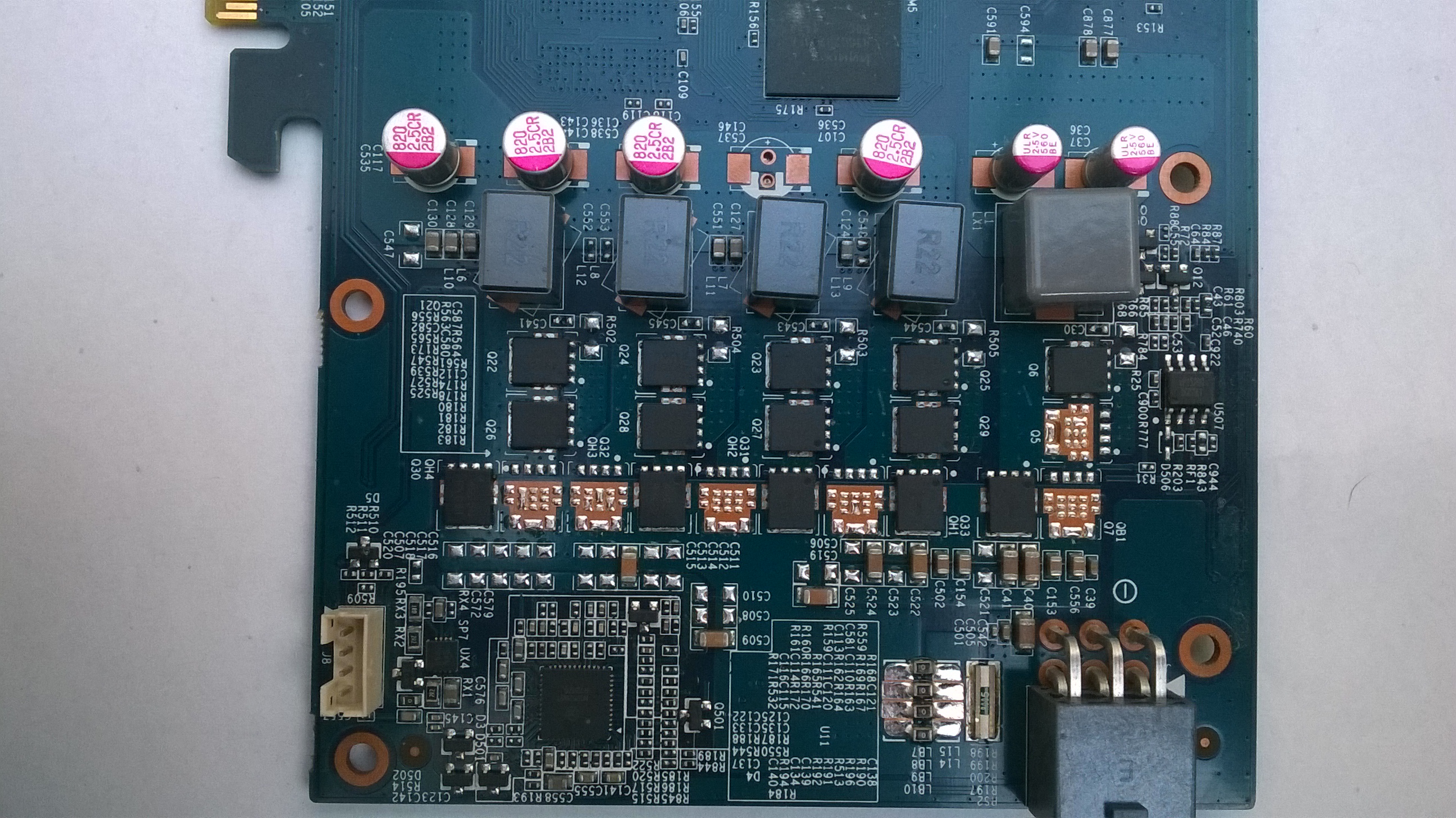

                            pentium 4 i used hot air desolder station the sam one i use for xbox gpus and cpus. Clutchbox yes there is power to it. I'm thinking it could one of the resistors on the board because surely if the gpu was bad i wouldn't still get a picture through it even in safe mode it's only when as soon as the drivers are installed it doesn't want to play ball.I've also tried it in two other machines to make sure it's not the board or pcie slots that are faulting either but it gets the exact same result.There aren't many caps on the board either and those that are don't appear to damaged or leaking electrolytes.

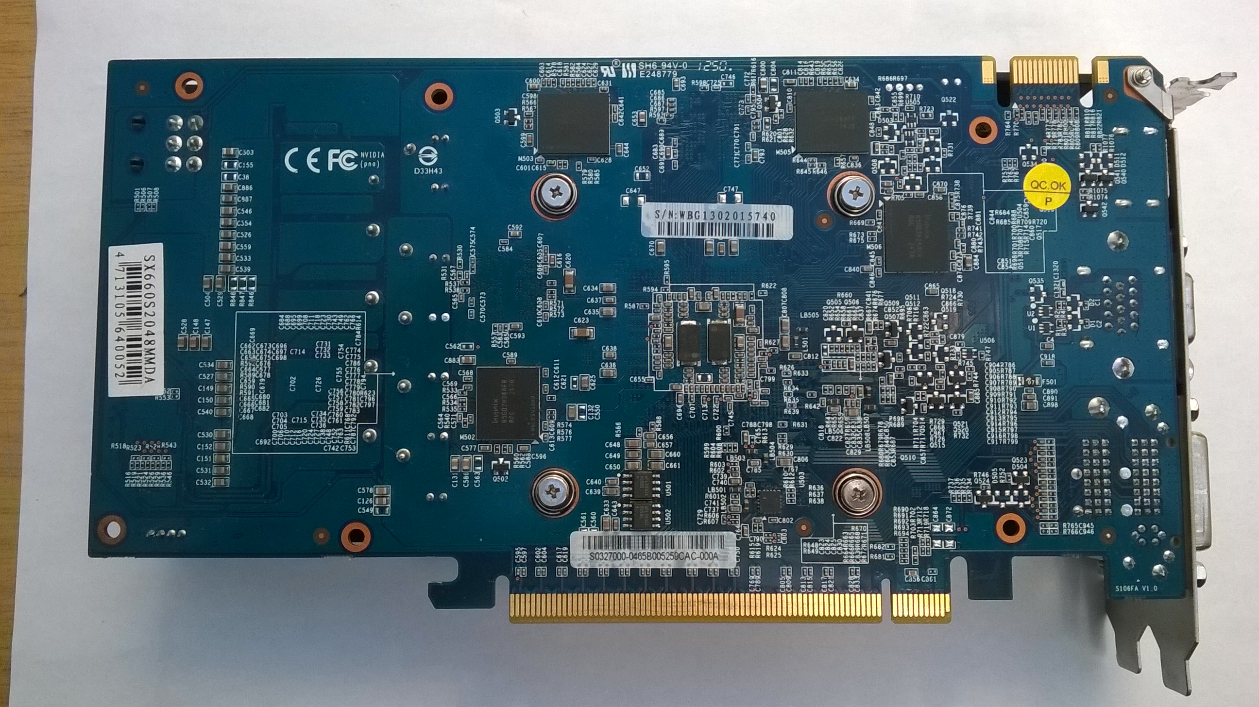

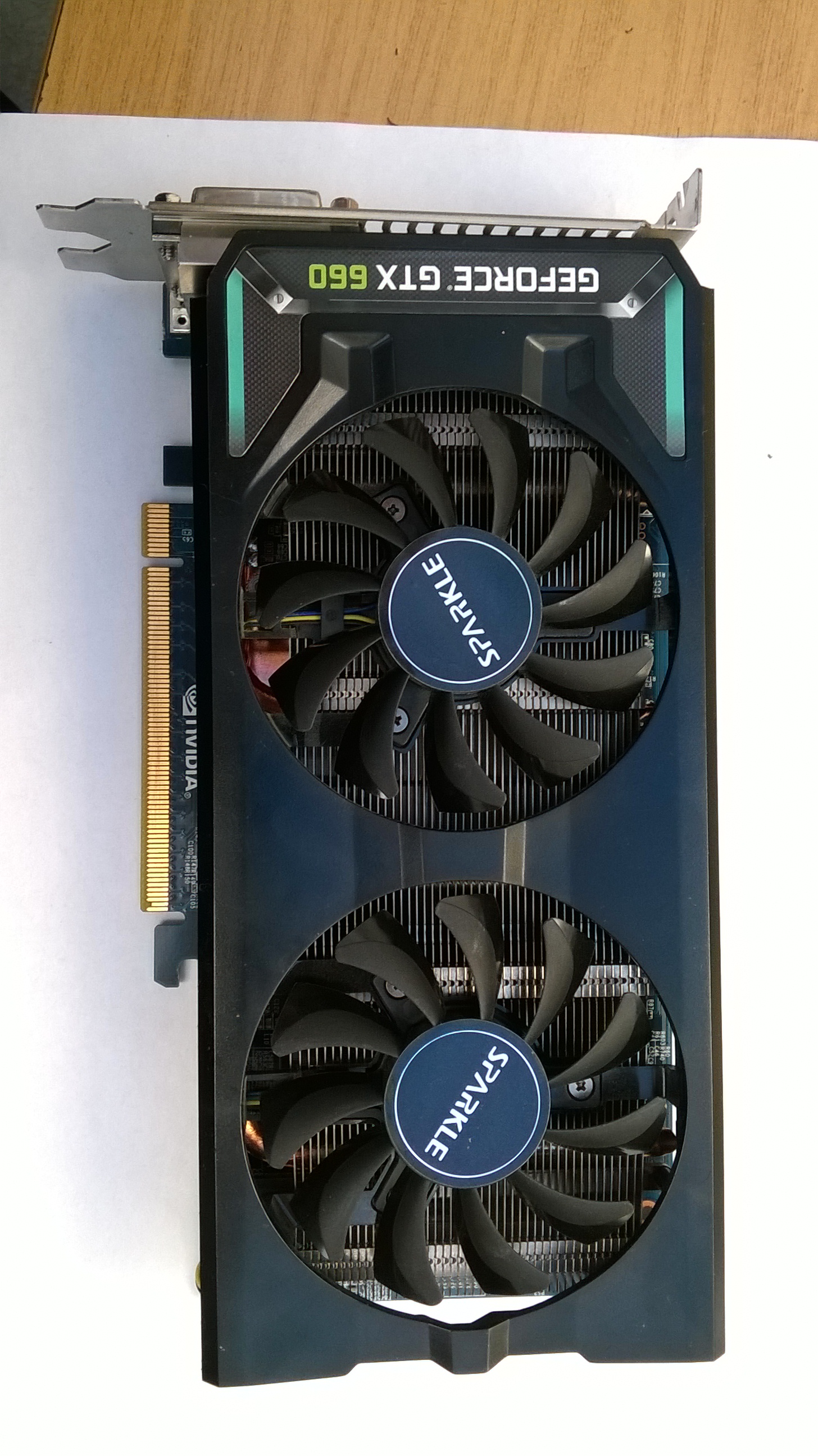

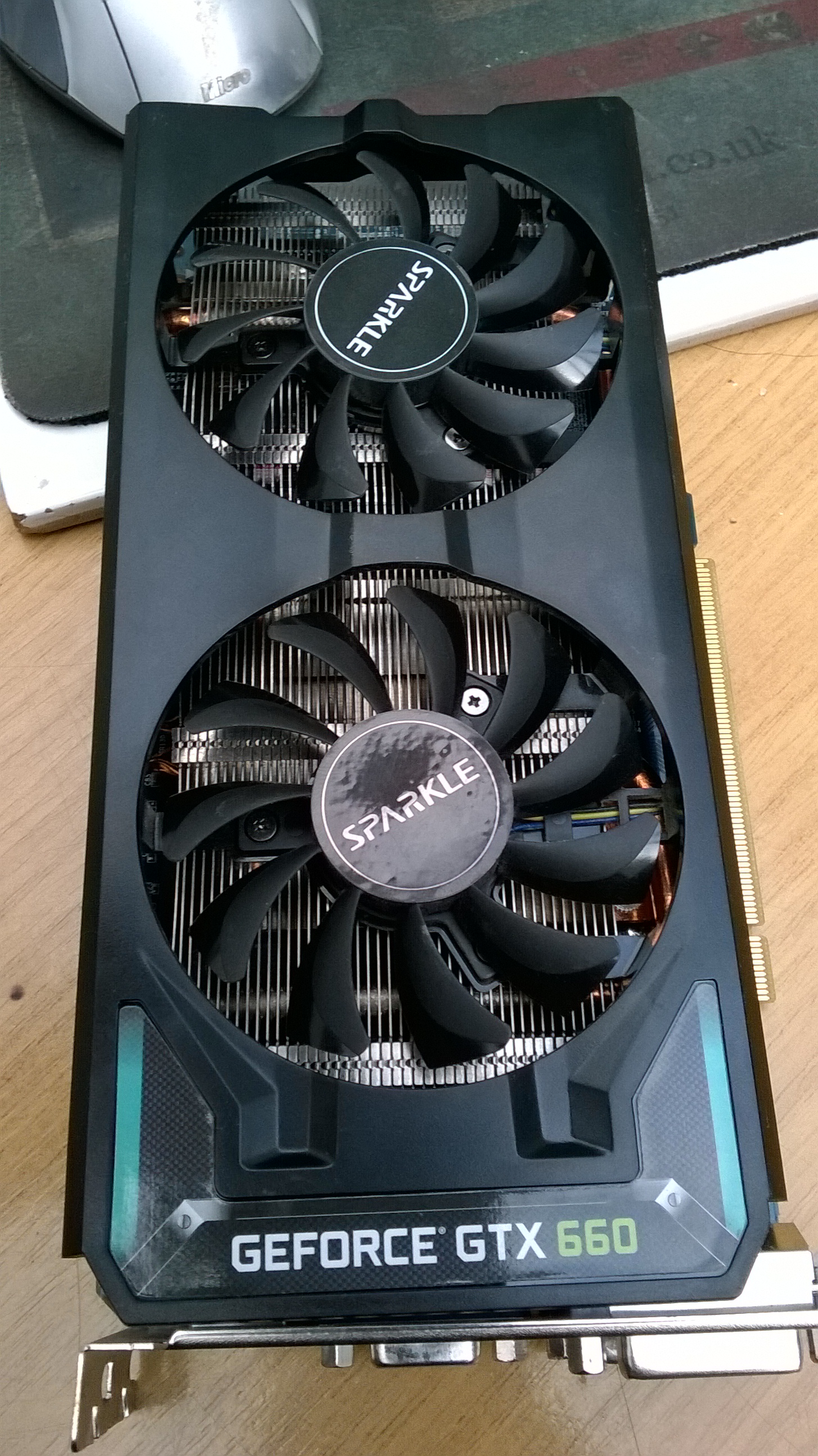

                            • smallprint
                              • Nov 2010
                              • 86

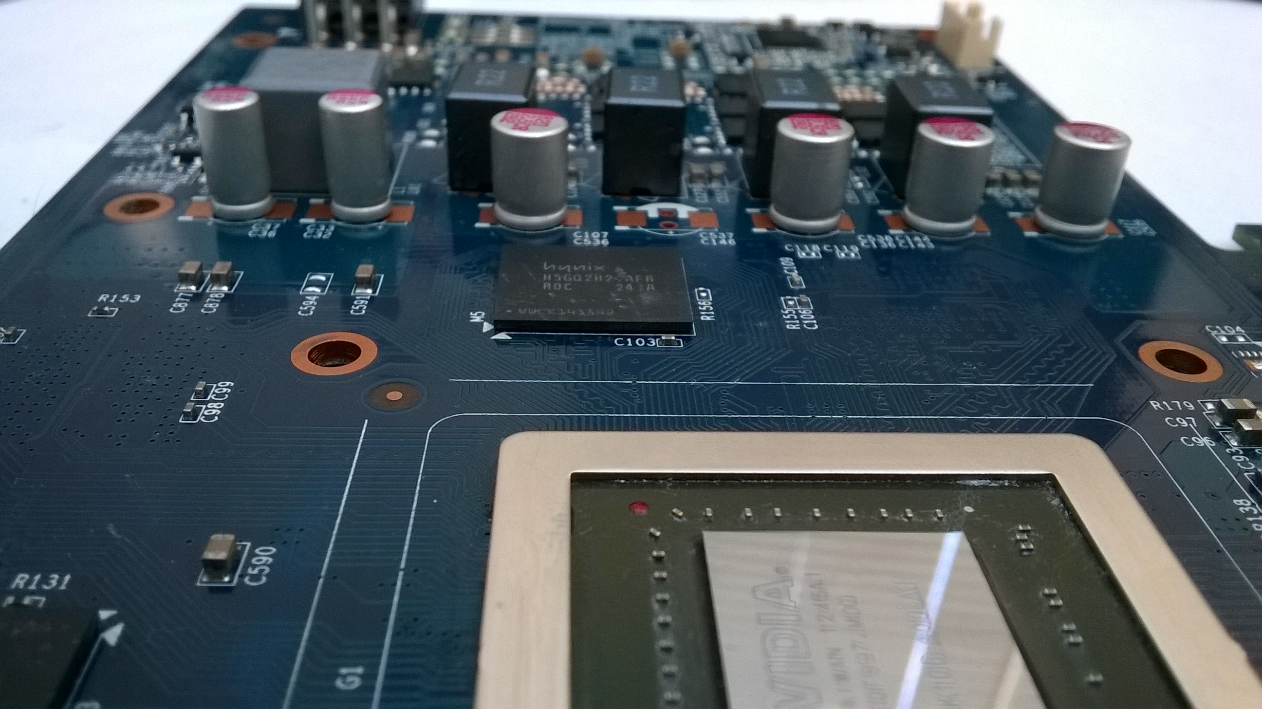

                              some closer up shots

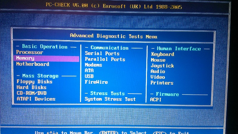

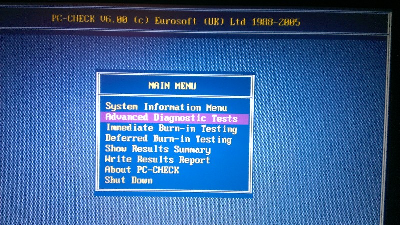

                                  Originally posted by stj

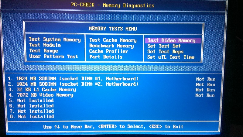

                                  i'v often wondered why there is no software to test video-ram.
                                  something like that would be very handy at times like these.
                                  You can to some degree using Pc-Check , the one I have is an old version 6.0 so hopefully the new versions does support video ram tests better.

                                        mostly it is memory error when crash after driver but ok without it. must check for errors and replace bad chip/s
