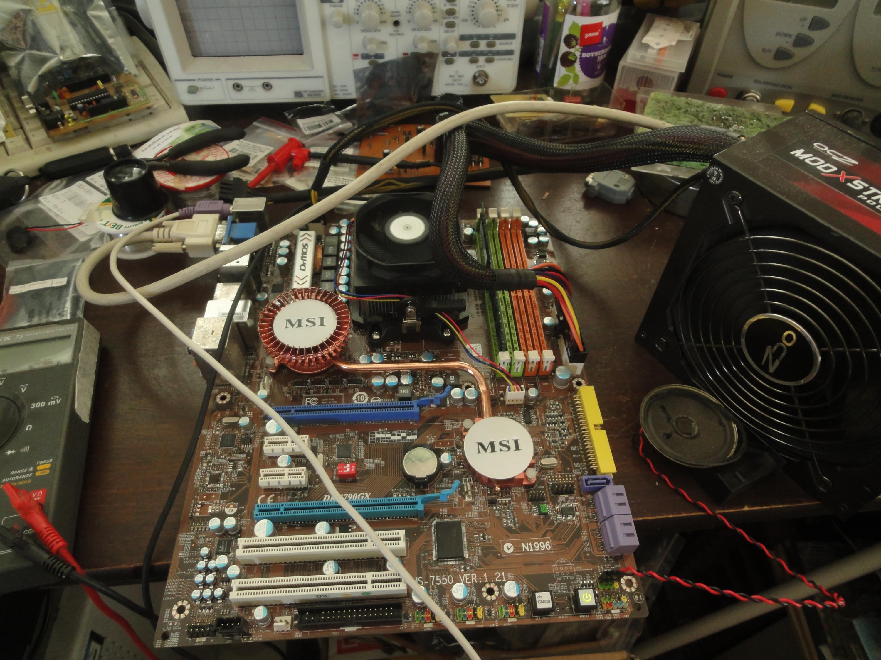

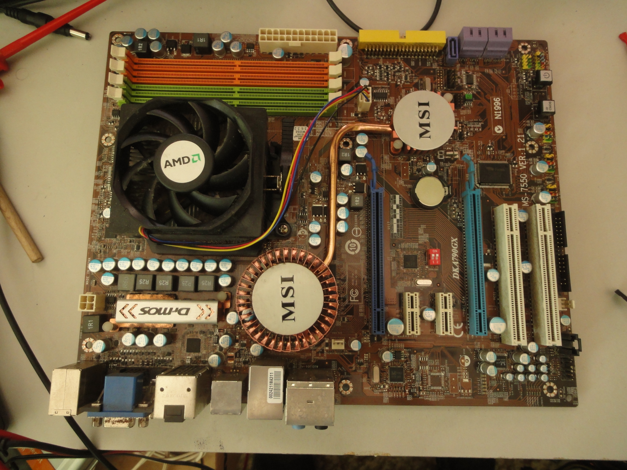

    This was my friend's motherboard. He bought a 2nd hand computer which worked for a couple of days after he got it, then died. I troubleshooted it down to the motherboard and he bought a new board, which fixed the problem.
    Now I decided to try fixing his old one for fun.
    Problem: No POST, No beeps, power button won't shut board down after power up, have to power PSU off at mains.
    After having problems with my own machine locking up and failing to POST, which I eventually traced back to leaky power\reset buttons on my case, I started by desoldering the onboard reset button and checking the RESET line (FP_RST#) which turns out to be high (3.3v). So that at least seems OK to some extent.
    I noticed that FP_RST# also feeds the "SB700 & RS780 POWER GOOD CIRCUIT" (Page 27)
    In this circuit, I measured Q38 to have 5v on its gate, and the output of Q38, the SYS_PWRGD signal is LOW.
    This seems to be because Q37 has no base drive, and there's no voltage either side of R209. NB_VCC1P1 rail seems to be down.
    I notice that NB_VCC1P1 measures 19.6 Ohm to GND. Is this a short, or normal? The schematic (Page 28) suggests that this rail supplies 10.2 Amps.

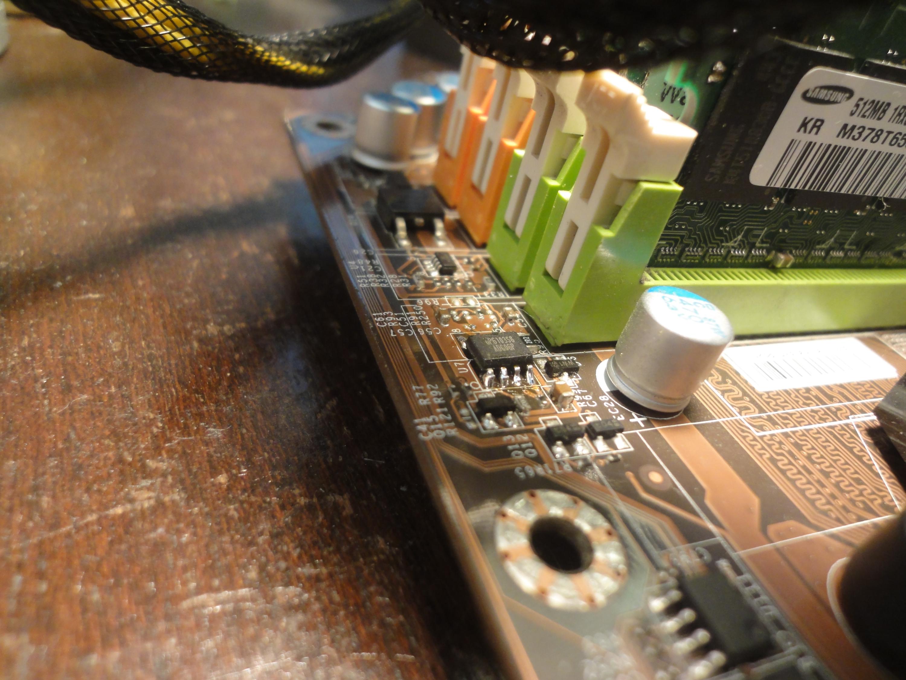

        This is weird. I started going through all the rails and references voltages to see if there are any other problems.
        I found 5V_DIMM, VCC3_SB, +1.2VSB are all OK (no real surprise) but when I got to U16 which generates some reference voltages, things go funny...
        U16, apparently a UP6261BM8 is getting 5v OK, and the 1.8v Ref output is fine, but the 1.25v and 1.2v outputs are dead, either in standby or with the board started. I notice the 1.2v Ref feeds Pin 7 of U23 and this is now gone also (it was 1.2v when I first started testing, now it's got nothing)
        I wonder if U16 is the problem and it is in the process of slowly dying? I can't find a damn datasheet for it though...
        EDIT: U16 also appears to have an enable signal (EN_HT), Pin 8. This is only 0.05v - perhaps this is why nothing is happening... Interestingly this is derived from the VRM_GD signal, which comes from the ISL6323CRZ VRM controller (Pin 37, VDDPWRGD). Hmm...

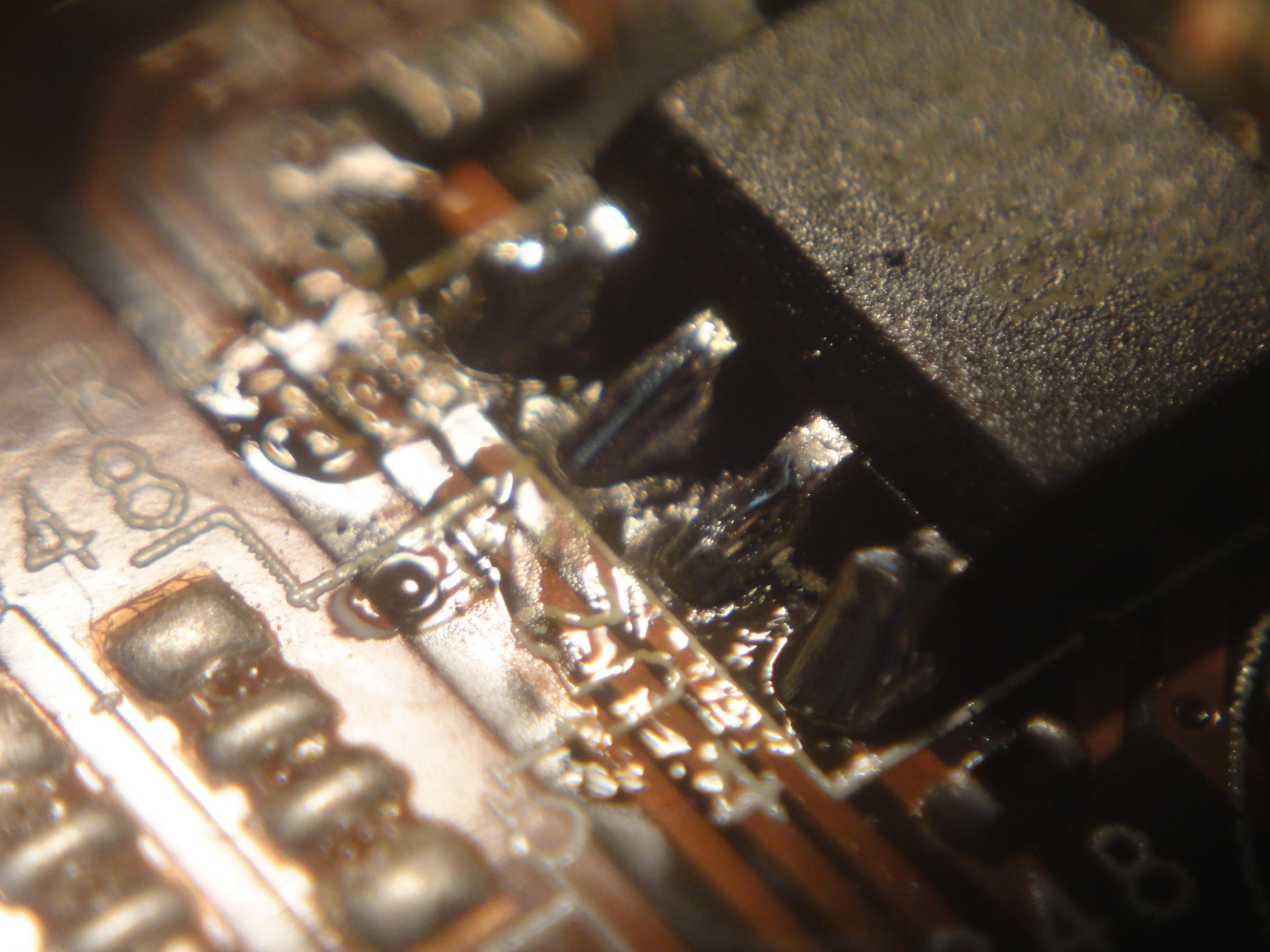

                    Since there was nothing else I could see possibly stopping U23 from running except itself, I decided to replace it and see what happens.
                    I was considering buying some uP6103 ICs on Aliexpress but have never bought there before so am a little wary of fakes and a probably nonexistent refund procedure... Anyway, I recently looked on eBay again, and saw there were some for sale now. For about $8 NZD I bought 10 of them from http://myworld.ebay.com/icmarket2009 as they have good feedback and I have bought from them before.
                    I replaced U23, and got the NB_VCC1P1 rail back! - but only when the CPU was not plugged in, since NB_VCC1P1 won't come up unless the VCC_DDR rail is up, and that doesn't work with the CPU installed.
                    VCC_DDR is created with another uP6103, U7. Since it's the same chip, one already seemed to have died, I had 9 more... I replaced U7 too..... and now the board POSTs!
                    I guess U7 and U23 both failed around the same time - how exactly, or why, I don't know. I wonder if they were knockoff or cheaper clone parts - the replacement uP6103s I received from eBay have larger printing on them. Or maybe they're just cheap ICs from a cheap manufacturer nobody's heard of, and they don't last.
                    I hope anyone following this thread learned some things about motherboard troubleshooting, I know I did
