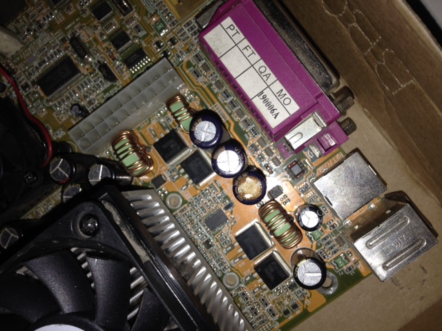

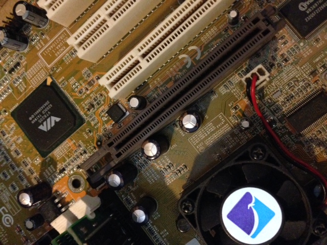

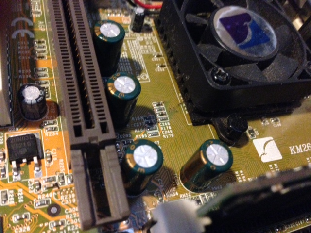

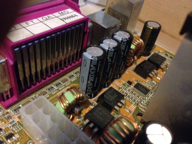

    Well this board has lots of bad low esr GSC caps one of the worse brands you can see the big 3300uf leaking bad, so it was recapped with Nichicon HM 3300uf 6.3 volts these have a code of H0217 and for the smaller 6.3v 1000uf I put in Teapo SC. recap was a success, this is the board that got me though highcschool and never let me down, was still stable with the bad caps.
