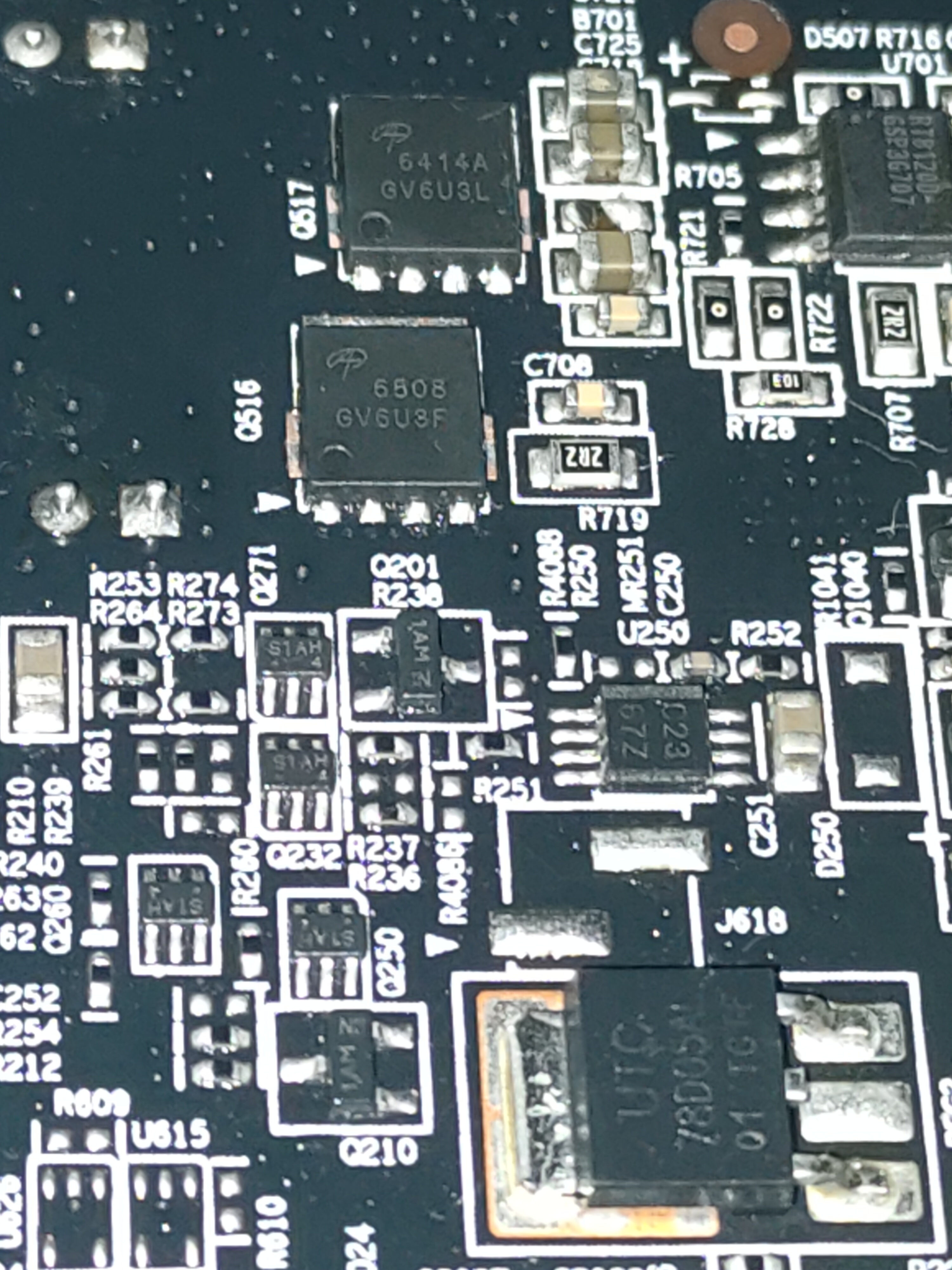

    Hi guys
    In my spare time to upskill myself I buy joblots if stuff to fix , or attempt fixing and get some experience
    I have a r460 that I wanted to fix and give to my nephew

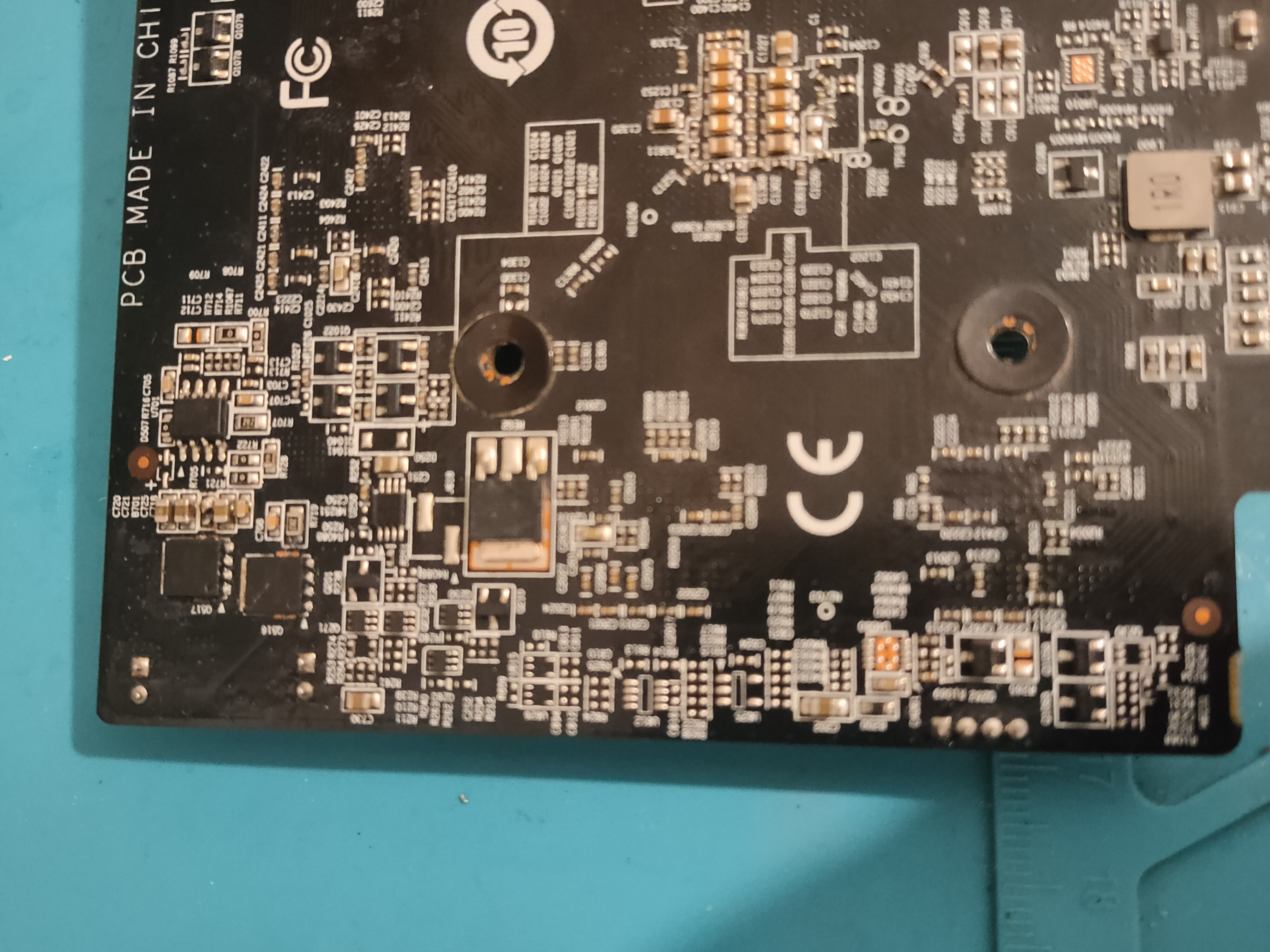

    As shown there is a burned ferrite bead, next to a high/ low side VRM pair on the back side of the card
    I'm gonna try replacing these pair of VRMs. I wondered how hard they are to remove
    I have a decent sequire solder iron and hot air, though may need to get a hot plate.. Seems these VRMs have big contact plates and could be welded
    Also seemingly ferrite beads on GPUs are usually 0ohm right? Need to get some of those
    Fuse is blown too
    Pictures are attached.. will update progress if any

      The fuse immediately after the PCIE 12V in from motherboard ( 75W ) .. I have ordered new fuses .. Though unsure of the ferrite bead value here .. Cant seem to get a pack of various values

        It looks like a ferite bead only, so you can replace it with a solder bridge, at least for testing purproses.
        MOSFET next to it look like they've been damaged and changed before? If so, and if these are for the RAM V_dd rail, chances are the GPU's dead beyond revival. Common to see V_dd rail shorted on AMD GPUs. But let's cross our fingers here and hope that's not the case. Give the ferite bead a solder bridge across and pray to the GPU gods a little.

          Ok This is now fixed
          It was fixed by replacing 6508 the mosfet, with a similar N channel mosfet from a donor . This was an educated guess since the resistance from 12V was lowest here , around 500 Ohms
          Replacing the ferrite bead just blew the fuse
