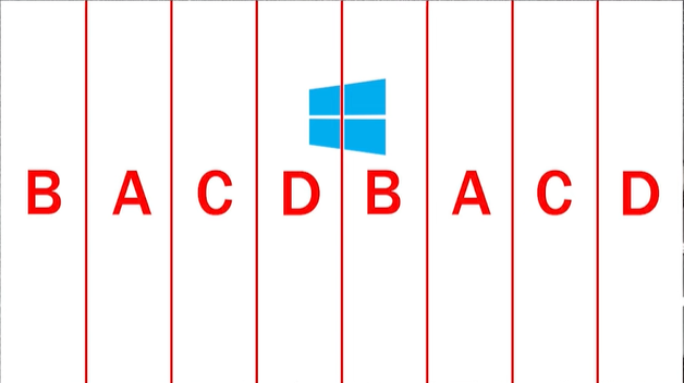

RX580 MSI armor OC 8gb no post
  • ktmmotocross
    Boardkiller
    • Feb 2014
    • 3553
    • slovakia
    Originally posted by chaos-theory
    Have you encountered that error before? Do you think reflowing can solve this?
    MANY times. have so many spare cards because of this. it is cheap so reball is not cost effective. u can try reflow
    u can try this picture to check ram channel
    • chaos-theory
      • Apr 2024
      • 44
      • Africa
      I have used that picture before but it doesn't seem very accurate, can one channel of ram interfere with other channels? Because I removed 2 chips and I still have the artifacts at the same place
      • ktmmotocross
        Boardkiller
        • Feb 2014
        • 3553
        • slovakia
        balls under gpu
        • chaos-theory
          • Apr 2024
          • 44
          • Africa
          balls under gpu
          I tried reflowing the GPU core with flux, I don't know if the balls melted or not, but I heated it really good, but the same thing happens, I also tried pushing down on the core while looking at the image and pushing down on the vram chips, but nothing changes. Many people suggested that the horizontal lines are caused by faulty vram chips or controllers, but the other places are also distorted, can anyone with more technical expertise explain that
          • ktmmotocross
            Boardkiller
            • Feb 2014
            • 3553
            • slovakia
            reflow does nothing on this cards u need reball
            • chaos-theory
              • Apr 2024
              • 44
              • Africa
              I tested VREFC Aand MVREF for all channels and they all have that 1.09v, so the GPU it powering the vram chips, other than that I don't think I can test resistance to the data channels, you mean I need to reball the GPU, that's a hard process is there a way to confirm?
