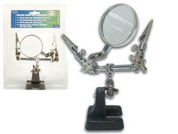

          More hands? yup I know what you mean... theres something like twin clamp jaw vice thinga-ma-jiggy getting sold around the place, could be invaluable

                AFAIK the device I was refering to is called 'helping hands' (hobbyist/soldering vice)
                There's a DIY (home built) version & guide HERE

                  How cool - helping hands! LOL. I see there's a few differing styles there, so it's like choose your savior and build it! ;-). Well, we have tons of scrap everything, so I am going to see what we can "design" for our home use. If we make something pretty, I'll post a picture. BTW, the magnifying glass is a MUST! Ha.
