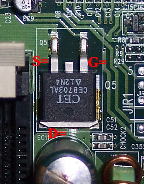

            I removed the FETs near the DIMM slots tonight. I did an Ohm test and a test using the Diode test function on my Fluke 29 Series II Multimeter to get some numbers for the FETs. Are either of those tests applicable for determining a good FET? If so, could someone tell me how to interpret my numbers if I post them?
            Another question: Can someone tell me what the different legs are called for the FET shown below? I have the legs labeled S=, G=, and D=. I understand that there is a "source", "gate" and "drain". I thought the source was "s", "g" was the gate and "d" is the drain. Am I correct?
            Thank you in advance.

                I didn't test for anything when I first got the system - that's too bad too in my hindsight vision.
                In my picture above, I labeled the S and G wrong - I didn't take into consideration that the FET was upside down! LOL. Anyway. I forgot about my books on electricity from school. So, I cracked them open this morning and was reading about transistors. I am understanding that an FET is basically comprised of two circuits within it: the gate being one circuit and source-to-drain being the other circuit. The theory of how it works reminds me of a step transformer. The gate circuit controls (induces) the flow in the source-to-drain circuit.
                Ok, so looking at this test I have been trying to conduct using the diode testing method, I still have a question.
                Here is the test instructions: (see http://www.4qd.co.uk/serv/mostest.html for the full article)
                "So: connect the meter negative to the MOSFET's source. This is arrowed in the drawing above which shows the most popular TO220 MOSFETs.
                Hold the MOSFET by the case or the tab if you wish, it doesn't matter if you touch the metal body but be careful not to touch the leads until you need to.
                First touch the meter positive on to the gate.
                Now move the positive meter probe to the drain. You should get a low reading. The MOSFET's gate capacitance has been charged up by the meter and the device is turned on.
                With the meter positive still connected to the drain, touch a finger between source and gate (and drain if you wish, it matters not). The gate will be discharged through your finger and the meter reading should go high, indicating a non-conducting device.
                Such a simple test cannot be 100% - but it is useful and is usually adequate."
                In this test, after touching the positive lead to the drain, it says to leave the positive lead on the drain and touch the source-to-gate with a finger. Do I leave the negative lead on the source leg while doing this? I am thinking that if I am trying to drain with my finger, that I should be taking the negative lead off - the instructions don't specify.
                Ohms test results on the two FETs - both are the same, CEB703AL:
                FET #1: S-G= 8.8, G-D=9.2, S-D=0.9
                FET #2: S-G= 30.5, G-D=34.1 S-D=4.5
                Both FETs show continuity using the beeper on all three tests between legs. But, if the gate is physically separate from the source-drain, it shouldn't be showing continuity with the other circuit should it - shouldn't it read OL when I am doing an Ohm test?

                          Bit late with this reply seems you got good info on the fets and also think someone posted in the other thread on how to test in circuit.
                          Fets should never read zero ohms between pins.

                                  i just recapped 4 of those mobo's and none would post till i pulled the battery and cleared cmos.
                                  the only ones that havnt survived were ones with burned mosfets.this is with a sample size of about 300.
                                  about 50% of the ones with burned mosfets were fixable.

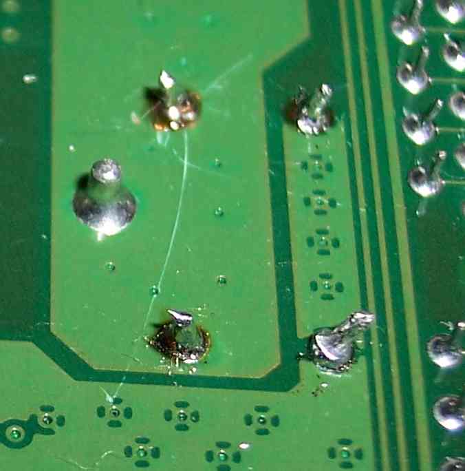

                                    Well, I did attempt to clear the CMOS using the switch and pulling the battery. The computer still wouldn't boot.
                                    I removed the all of the caps 1000uf and above. Used soldering gun and wick to get about 1/2 the holes cleaned out. Then, I did the "no-no" and used a tiny drill bit and cleaned out the remaining holes because I was worried that I was overheating the board. I kept the bit centered and drilled out only enough to be able to get the new cap leads through the holes - so I felt pretty good about my drill job. I blew off the board. I soldered on the new caps, but had a bit of a time with the first two as the solder wasn't adhering. I felt that I should have used flux on the board to clean it up the way the solder wasn't adhering, but I thought that the 60-40 had rosin?

                                        I am getting another board, so this board that I have been working on is my official practice board. Moreover, one of the local computer store/repair shops is happy to let me have boards to practice on, so someday I should get the hang of this stuff and have a pretty look, professionally soldered board ;-). In the meanwhile.....
                                        My multimeter is a Fluke 29 Series II that I bought back in 1996. The soldering iron I have been using is a RadioShack Cat. No. 64-2060B 45 watt iron with a slanted tip that hubby made for me (original tip was actually a sucker thingy). The solder I used is RadioShack brand again 64-002 E .062 dia. 60/40 Standard Rosin-Core Solder.
                                        One of these days, I am going to order a hotter iron because I can see where I have problems with less heat. For soldering things back on, the 45 watt is okay though huh?
                                        Here are pictures of the areas that I had problems with. No, they don't look pretty, so be gentle with me LOL.
                                        The first one is of the area that the two FETs were in. I had problems getting enough heat into the areas; the FET in the upper right was especially hard with the power strip and DIMM slot brackets - I kinda melted some plastic on both of those.
                                        The other one is of the first (ever) capacitors I tried to remove and put back on. I had a hard time getting the original capacitors off - the solder would not melt - it was weird. Then I figured out to dump some fresh solder on and that helped greatly. Trying to solder new capacitors on in this area was hard - the solder was acting like it didn't have any flux in it. I don't know if this is because I didn't wipe the board after removing the originals? Anyway, the soldering looks pretty funky. Later desoldering and soldering went ok as I started getting the hang of it.
                                        I did practice on some other boards before tackling my project board, but the solder must have been different and "behaving" like I thought it should. When I got on the board I wanted to work on, all of a sudden I couldn't desolder and solder satisfactorily - I wasn't a happy camper and thought, "Well, here's some learning experiences happening!" ;-)
