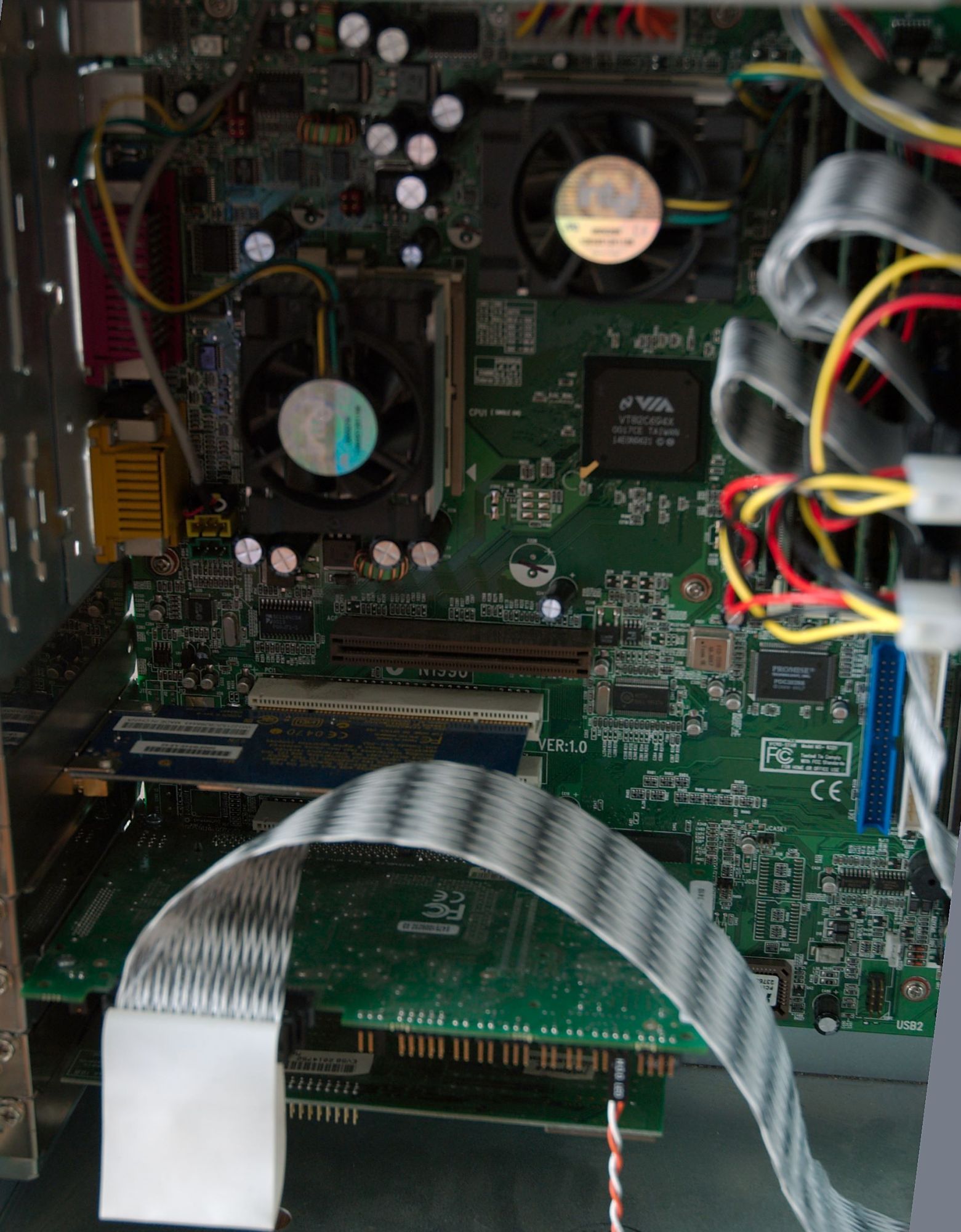

    Like the title states. I have done a successful recap of an MSI 694D Pro motherboard, complete with the C390 mod! And it was the first time I did such a thing!
    It was damn hard to find appropriate capacitors down under, however I settled for Nichicon HE series capacitors. Works like a charm now. Before the recap, it would not run correctly with two CPU's installed. Took a very long time to diagnose the problem as a badcaps problem. Mainly because the motherboard was never run in two CPU mode in its lifetime!

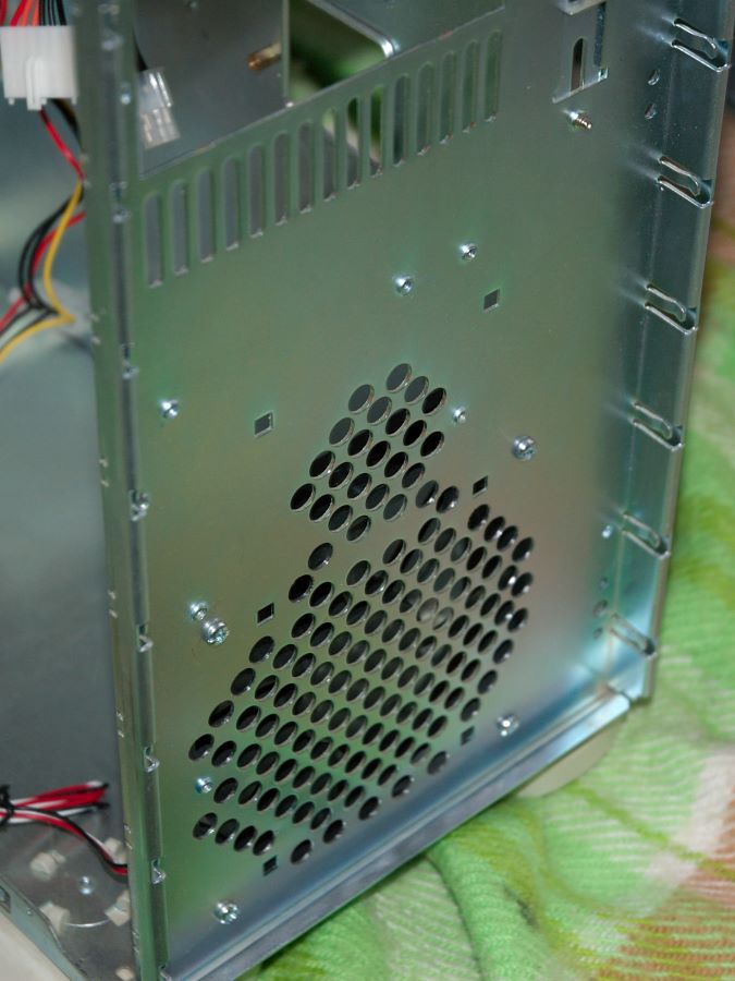

    Now I have another problem, I have no case fans for this case. So I bought a couple of 120mm fans. Due to negligence, I did not measure them. I knew that this case fits fans that are larger than 80mm since I had a 80mm fan lying around. The shop only had 80mm or 120mm fans, so I bought the 120mm one's. Only when I got back home did I actually measure the spaces for the fans on the case and was horrified that it actually took 92mm fans and not 120mm fans. Now I am thinking about modifying the case to fit 120mm fans.
    What methods would anyone recommend to me in modding this case. I am unwilling to buy speciality tools that I would use once in 10 years!
    So far the feasible options that I can think of is the following options:
    * Just drill some holes around the existing perforation to increase airflow from the larger fan when fitted.
    * Drill some holes around the existing perforation and take a hack saw and cut out a rough hole which I then could file down with a file. Long procedure but I have all the required tools.
    * Make my own 92mm to 120mm transition.

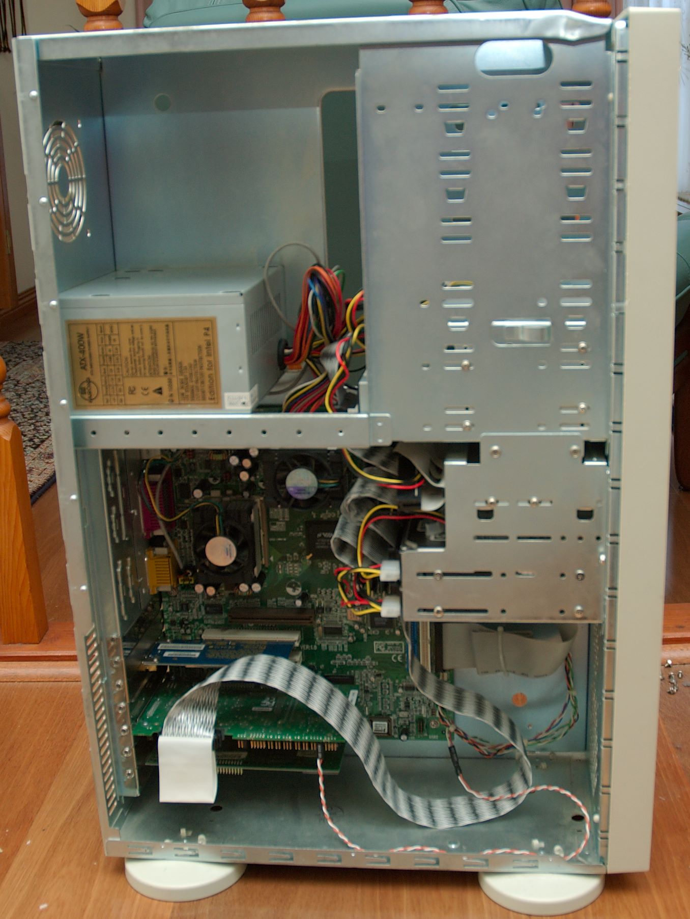

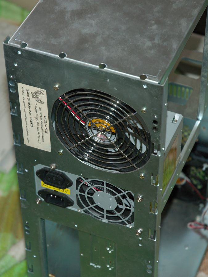

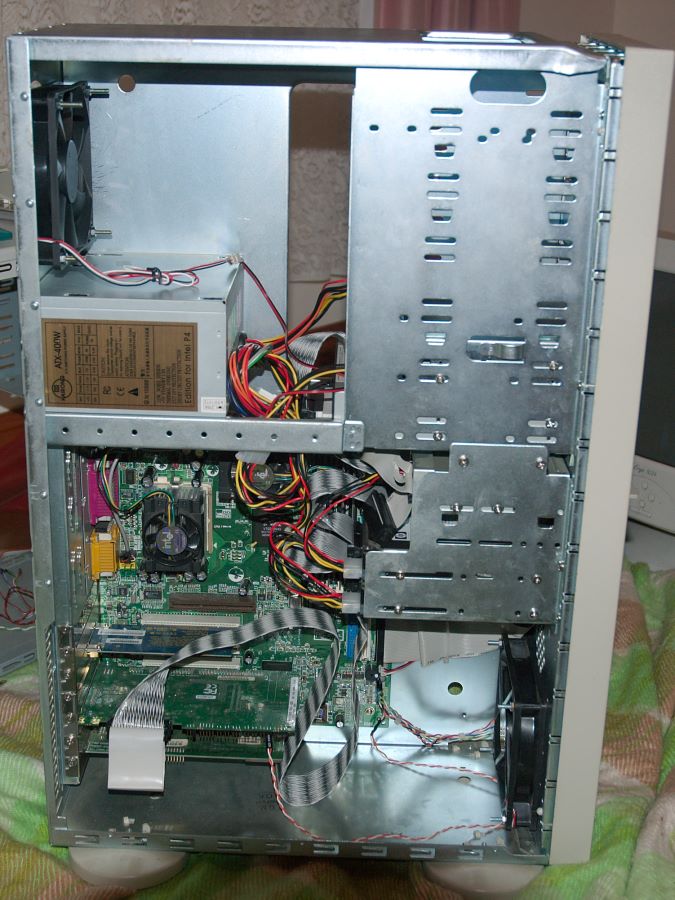

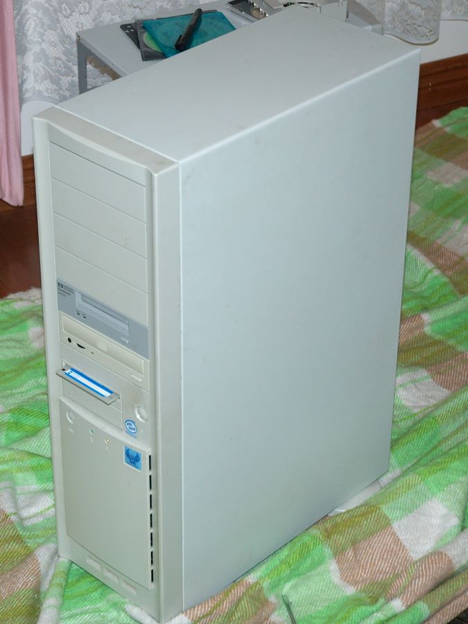

                    Have not updated the progress on this machine for quite some time!

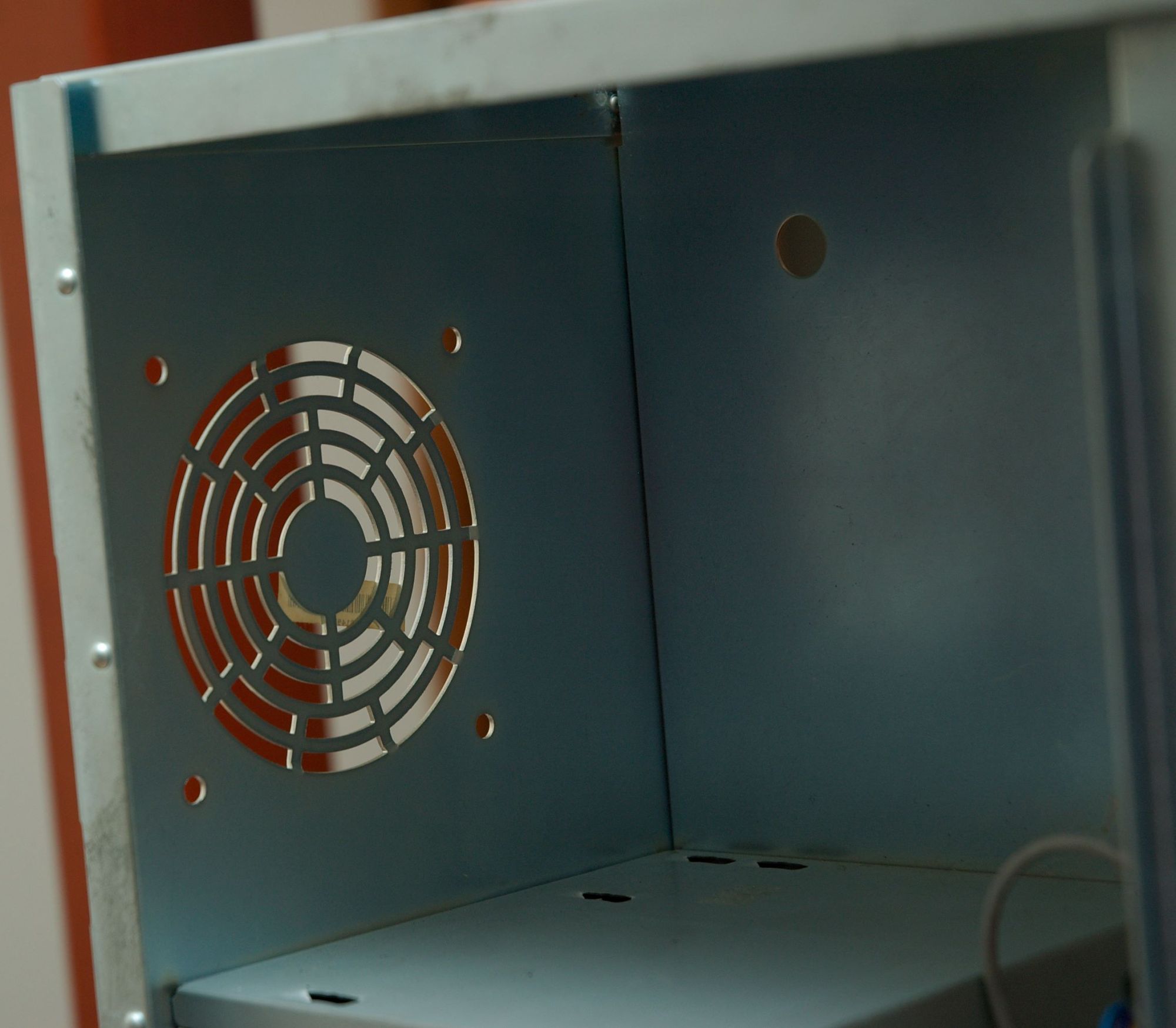

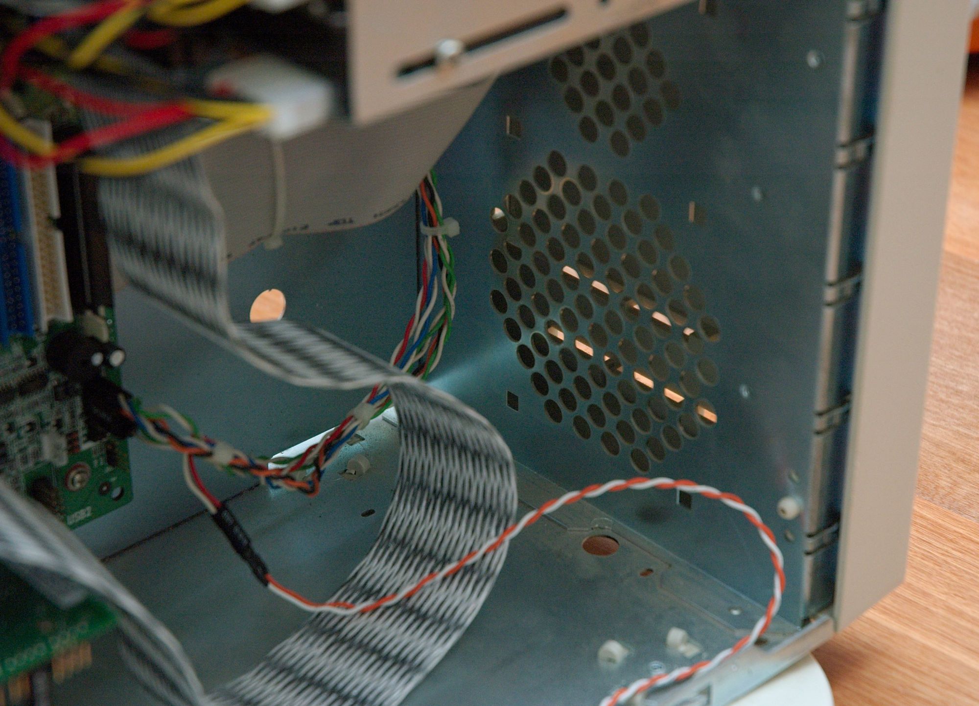

                    Anyway I finished building this nice little server. I ended up cutting the holes out for the fans. a month ago or so my old man and I decided to finish building the PC and he helped me out in cutting out the hole.The process went something like this:
                    * Mark out the circle that you want to cut out.
                    * We we were going to drill out some small holes along the perimeter of the circle, therefore mark out a centreline around the perimeter of the circle.
                    * Using a caliper, mark the centreline every 5mm or so.
                    * Using a punch, punch a dent into the case at the intersections of the centreline and the marks caused by the caliper. (Use someone else to hold an 'anvil' of some kind underneath when you are punching)
                    * Drill out the holes at each punched mark with a reasonably small drill bit.
                    * With a chisel, chisel out the gaps between the holes. (Use someone else to hold an 'anvil' of some kind underneath when you are using the chisel)
                    * With a semi-circular file, file out a neat circle.
                    It worked quite well, except for some mi-communication between me and my dad. I told him that the size of the hole that we want is exactly the size of a CD. And so he assumed that I was referring to the centreline. Therefore my hole is around 13cm in diameter.
                    By the way that was for the rear fan, the front fan grill was made up of 8mm perforations. I just added some more holes to make it cover the whole area of the fan.
                    Anyway here come the pictures!!!
                    Rear of the case with custom 120mm hole and 120mm fan installed.
                    Front of the case with extra perforations and 120mm fan installed.

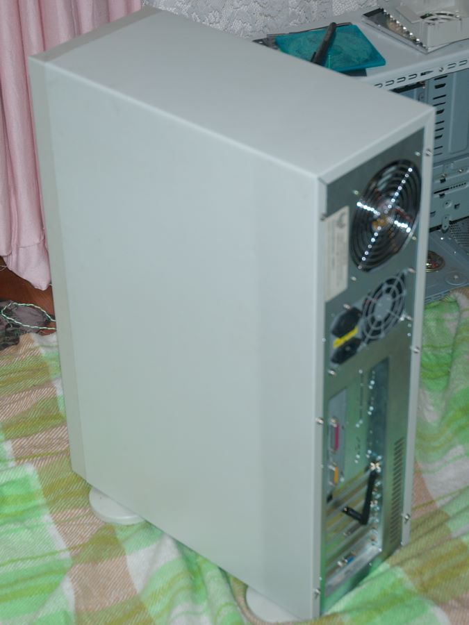

                    Another picture of the whole system, with fans installed.
                    Picture from front of the server fully assembled.
                    Picture of rear of server fully assembled.

                      Wow! Really nice work. I am impressed with the quality of workmanship. The power supply looks a little bit sketchy however. It would be a shame to waste all that hard work with a power supply explosion. Is that a generic PSU? Did you recap it? I only say this because I had one of my favorite machines fall victim to bad caps in an Antec. It would be a shame to see that happen here. You probably have dealt with this already.........but just in case you hadn't I thought I might say something. Again great work on the case and the recap.
                      • shadow
                        • Feb 2007
                        • 732
                        Re: MSI 694D Pro V:1.0 Successful Recap!
                        Actually I did not, this is the best power supply that I have. It is rated at 400W but I know that it is bogus and it is lower. It a Hairong, do not know the capacitors inside, I have to check them, I guess I can crack it open and post a picture.
                        I really do not know what constitutes a good power supply besides the caps in it! Thing is that the PSU is barely used, maybe has two hours of total life in it and the server is purely a developmental server. It does not run 24/7 or for very long periods of time.
                        Besides this '400W' PSU I have an AOpen 250W power supply, needs a recap. It has one bad capacitor, I think on the 5V rail. It is a shame that the AOpen mixed various different grade capacitors. It has Rubycon 200V caps and some Teapo's mixed with YEC and Vent. I have another 250W PSU, no name, has been running this MSI motherboard 24/7 for several years. No idea on capacitors or anything. I have another 230W PSU, also not a huge name but it has served me well for around 10 years now and has never given me troubles. I choose the cheapo 400W model because I am hoping that it will have a higher power rating than the other three that I have.
                        After all I am running SCSI RAID in it with two SCSI 10,000 RPM hard drives, HP tape drive, SCSI CD Burner and two CPU's. I'm pretty confident that that would suck up quite a bit of juice!
                        Maybe some others can shed me some light on a reasonable power requirement of my setup. Also some experience with Hairong PSU's would be appreciated and any recommendations.
