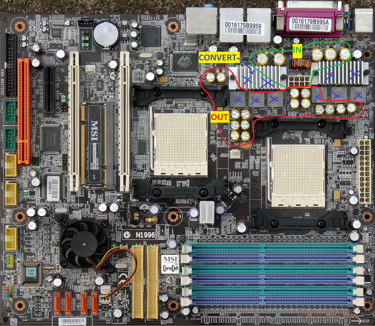

    I have 2 boards that are basically identical. Both are MSI K8N Master2-FAR (MS-9620). One board that functions as it should has a brown colored capacitor. These were acquired from a friend in the UK. It looks to me as though he tried to do a capacitor change that didn't go so well. The first picture is board that functions properly, the second is the one with the failed capacitor. They are obviously different. The capacitor is in the same location on both boards.
    My questions are: Is a 6.3v 1800uf capacitor better or worse than the original 16v 1000uf? Also, is there a solid cap available in the appropriate size needed?
    Are there any known problem caps on these boards and if so, which one's are they?

    It's probably filtering 12V, so it needs to be rated for at least 16V.
    That cap in the first picture is a series that is known to fail. Replace all KZGs.

        Stick with 1000uF 16v if you're going to use electrolytics. Youcan get Nichicon HN or HZ here. If you want to use polies, then go with 470uF 16v parts. I would recommend going with Nichicon FPCAP NE series, as they have that size in 8mm diameter.

            If you are using electrolytics, keep the capacitance the same. You can drop it if you are using polies, though. If you opt to poly mod it, use 470uF on the VRM input and 820uF on the output.

                  Here are pictures of the caps new the power and regulators. Which are input and output?

                    The VRM is above the processors.
                    (click to zoom)
                    Both processors are most likely powered only from that 8 pin connector between the heatsinks.
                    12v comes through that connector and those large yellow capacitors store a bit of energy, those are 16v rated, and from your picture in the post about probably 1000-1500uF (i only see two 00 on the label). I've circled those with green.
                    Notice that I didn't circle that capacitor right in the corner, which is rated for 6.3v - that one if I were to guess is for the 5v power of the USB ports on the back panel.
                    The DC-DC converters are formed by some chips under the heatsink and those inductors I've marked with blue X'es in the picture
                    The output of these dc-dc converters is "buffered" into the smaller capacitors that I circled with red, those are high quality polymer capacitors in a can that makes them look like electrolytic capacitors. You can see an even number, 8, for each processor. They're 820uF 2.5v capacitors Fujitsu (now they belong to Nichicon). You don't have to change those unless they are swollen or leak which I don't see in your picture.
                    The capacitors by the ATX connector are probably just to smooth some 12v and 5v for some auxiliary dc-dc converters spread on the motherboard... let's say maybe for powering up the memory modules, for chipset, fan on the chipset, for other things basically.
                    Some of them are even there just to make the fans smoother, for example the capacitors practically glued to fan headers.
                    edit: As for the second picture you posted in the above post... I don't know what that connector does. You'll have to check the motherboard manual. My guess is that it's an extra 12v connector which goes straight into the PCI-Express slots for video cards or raid controllers or whatever which demanded a lot of power. So if let's say user wanted to overclock video cards, there would be extra "juice" going to the video cards through that connector.
                    Those connectors are usually used with 12v, so it's a bit strange to see there a capacitor rated for 6.3v. it's possible that the 1000uF 6.3v capacitor has nothing to do with the connector. Either way, the KZE series from Nippon Chemi Con is not a "problem" series like KZG is, so if it looks ok, leave it like that.
