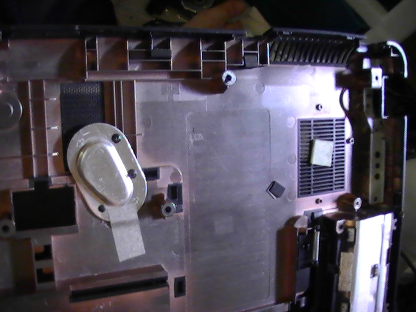

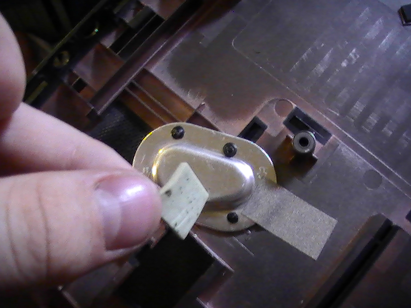

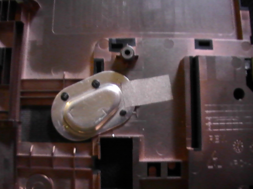

                ok sorry i was late but i got pictures.
                the small plate in the pics is the GPU heatsink and look how close to the cpu heatsink it is!

                  Re: GPU came off of compaq presario mobo
                  I don't see chip anywhere in those pics
                  On the last picture that is thermal pad, and it's normal to be able to remove it
                        I think that just stops the gpu heatsink from touching the plastic.
                        Also, that little bit of metal look like it has been squashed onto something square shaped?
                          yes the chunk of aluminum is the heat sink. i got bored so i gave that board the 15Kv treatment, so no pics till i clean up the board
                            just to chime in here, the CQ57 you have has an E-300, which has the GPU onboard the CPU, because it's an APU.
                            the little heatsink there is for the southbridge. my X120e does not have one for this chip, and it is entirely optional, I believe.
