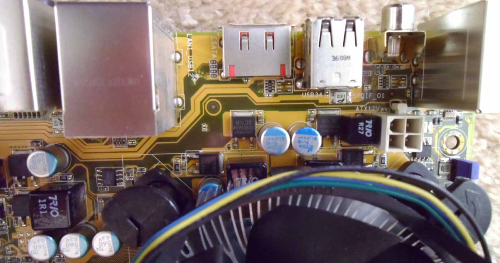

    Board starts, gives an OK single beep, then no more than a couple of seconds later gives a double beep followed by a message on the screen as per title, then as a second message advises, it shuts down after 15 seconds
    Judging by Google this isn't unusual with Asus boards, but this thread http://vip.asus.com/forum/view.aspx?...Language=en-us on Asus forums points to a faulty capacitor
    With my board a USB keyboard isn't detected by either of USB12 ports, in the same block as the LAN port
    But is detected by all four of the other on-board USB ports
    Problem happens whether a USB or a PS/2 keyboard is used
    Pic shows 560uf caps near the ports
    Suggestions ?

    Does the board have a PS/2 connectors? If so, try disabling the onboard USB ports in the Bios and see what happens. Probably one of your existing USB ports has been shorted. You can use one of these http://www.ebay.ca/itm/5-Port-High-S...item20bd8df477 as a replacement.

      Has only one PS/2 connector - for a keyboard
      Have been unable to get into the BIOS to change any settings
      I've tried the CLRTC jumper to reset BIOS, and also a fresh CR2032 battery
      Visually each of the six USB ports looks perfect, and there are no bent pins on the two headers for connecting external USB brackets

        Assuming a shorted USB port is the problem, try booting with no USB devices installed.
        So is it LanUSB12 or USB34 that is not functioning? You could check with an ohmmeter to see if there is continuity between the inner connector and the outer housing of the USB port. If you find the bad USB, you could desolder it from the board.
        Those solid caps could be shorted internally. You could check ESR of those caps. You could replace the caps and see what happens.
        Since USB port is live when the power supply switch is ON, it's very easy to burn out the USB ports.

          Apart from trying a USB keyboard, USB devices have never been installed
          There is continuity between the 5v contact in all USB ports, not just the faulty pair, and all three USB housings
          Keyboard isn't detected in either of the LanUSB12 pair
          I've removed all four 560uf 6.3v caps shown in the bottom left of my original pic
          The board still boots, and still brings up the same error
          Next step is remove the LanUSB12 connector block, to see what happens
          If problem persists, next step is the garbage bin for this Asus POS

                Solder back in the poly caps, they are for the VRM. It isn't good leaving them out - the other caps will suffer from the extra ripple.
                Try desoldering that white resettable fuse next to the USB connector. See if the short goes away. You might also want to try to find the USB controller chip (if it isn't embedded in another larger chip), and de-solder that. You said there is continuity between the 5v pin and the housing of the USB sockets, but, what is the resistance? If there is a dead short then it will be like 1-3 ohms.

                    I faced the same problem in P5Ke-wifi. I found that the problem is due to the short circuit in USB 5v to ground. I checked all the resistance between 5v to ground of each USB port. Finally, I identify the USB34 with the lowest resistance. There is a ceramic cap after the USB34 port is shorted. I replaced it and the problem has been solved.

                      Also worth noting (at least in my case) is checking if there isn't any jumper on the USB headers.
                      Stupid, I know, but I didn't notice the jumper placed on mine until I got the same message. Then it struck me once I looked closely on the board.
