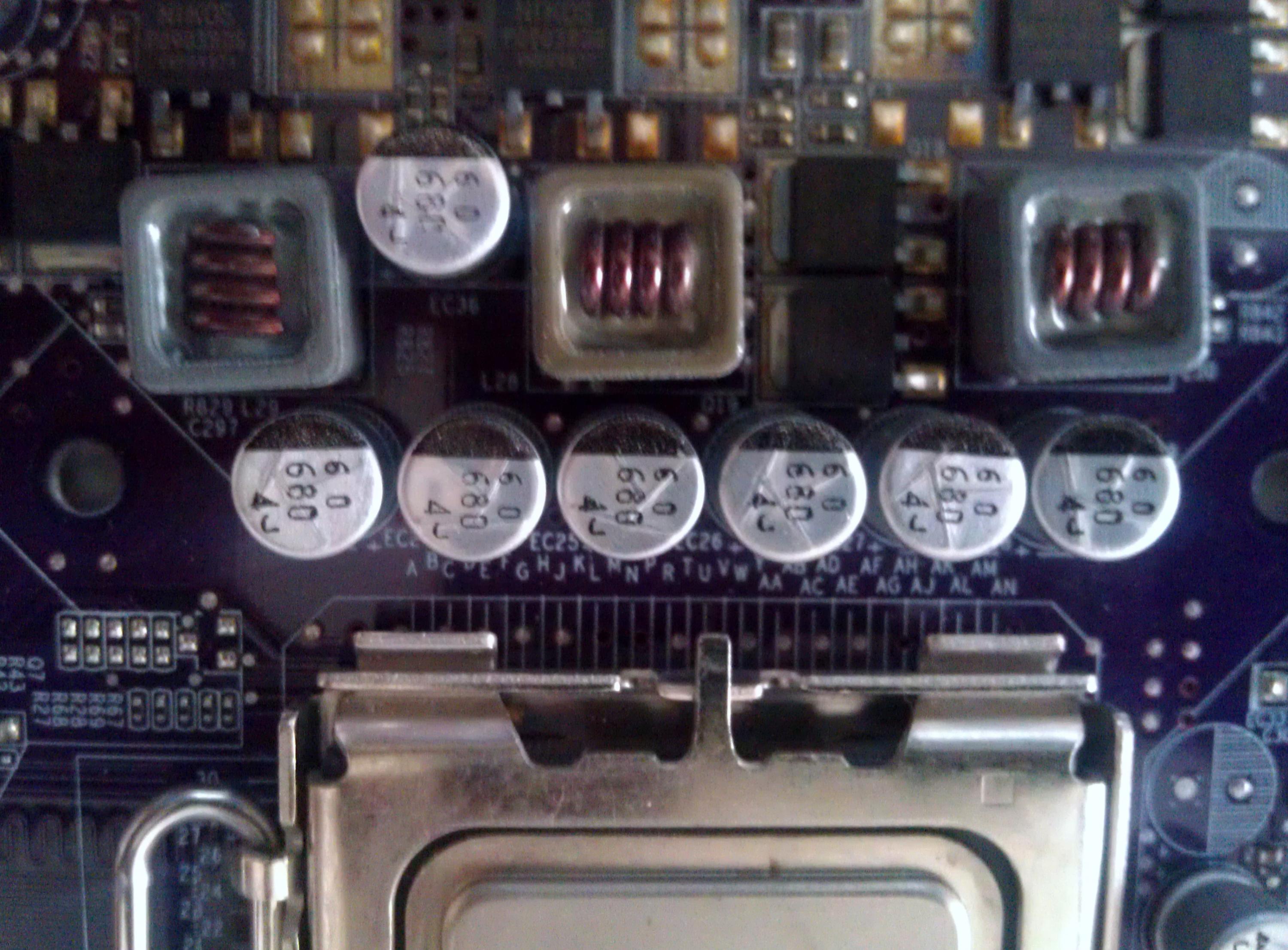

    Hey Team,
    Can you help me Identify these caps? Has a lot of bulging caps just want to replace them all and move on.
    Thanks...
    ECS NFORCE 570 SPLIT-A V5.1

    Re: Identify Caps
    680 uF , 4v capacitors
    replace with any one of these:
    http://www.digikey.com/product-detai...011-ND/1136101
    http://www.digikey.com/product-detai...224-ND/1826688
    http://www.digikey.com/product-detai...063-ND/1662449

      Hey thanks, I just wanted to ensure uf before replacing. I do already have some from BADCAPS for another PC, this one just popped up today and kinda would like to fix it, so guess I need to order more.

        Oh forgot I have plenty clearance, due to cool-master heat sink.

          When 4v caps are too tall or too expensive I use 2.5v caps to keep the height less than 11mm. It's been years since a processor ran at 2.5v

            I usually drop the capacitance back to 560uF. It's perfectly fine when you are poly-modding.

                Thanks for all your help, MO BO back up running no problems replaced all the caps! 1st one very successful .

                  I have the same mobo with bulging caps, and I'm also wondering what brand and series those caps are. Does anyone know ?
                  I have seen them several times in different (cheap) boards, but I'm still unsure of who made them. One example would be an ECS P4M800PRO-M2 that I have lying here that also has 4 of those caps in the VRM area, mixed with 2 solid OST (?, the ones with the T encircled) 560uf. Thanks.
