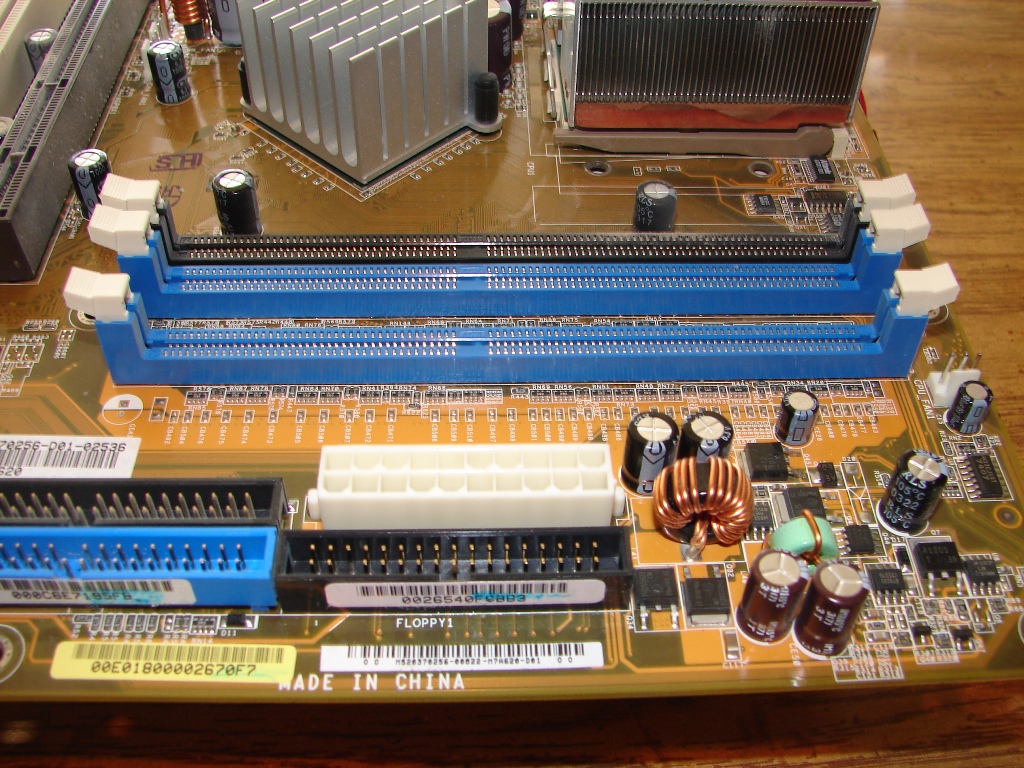

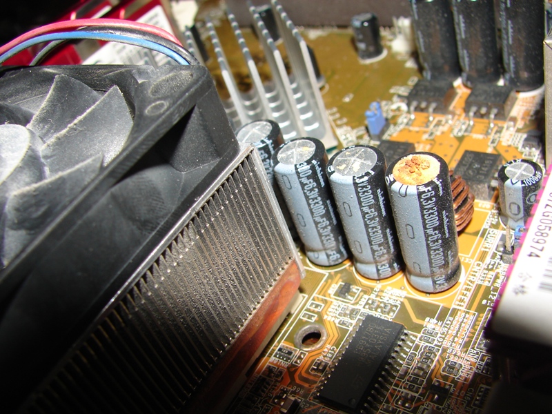

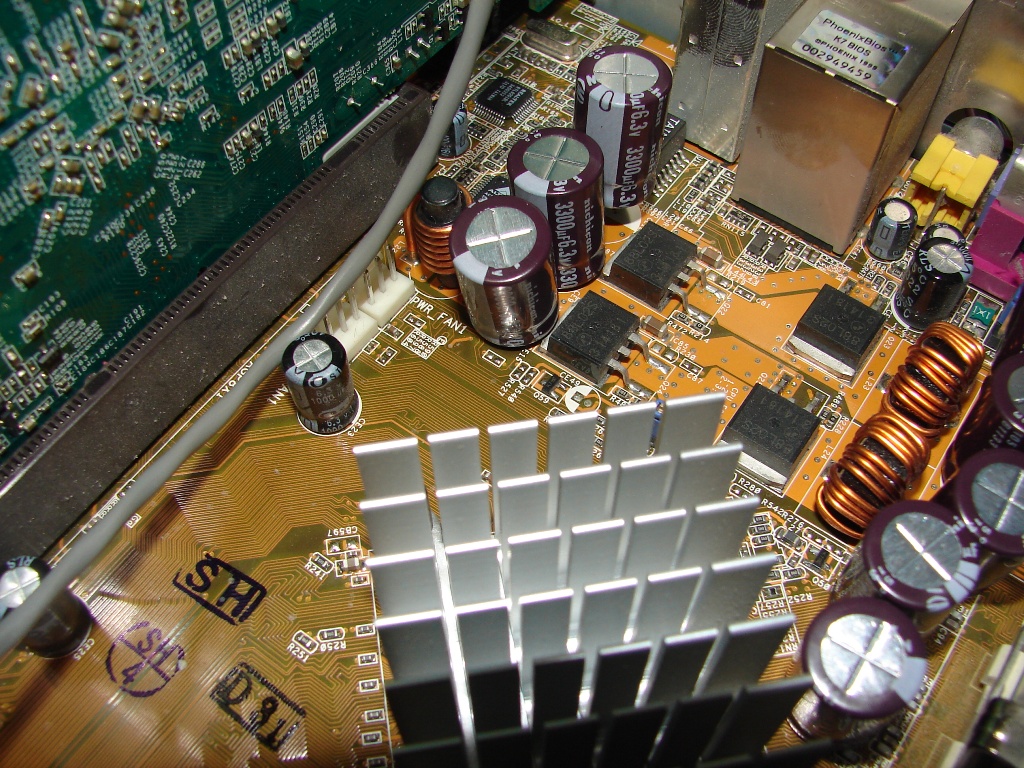

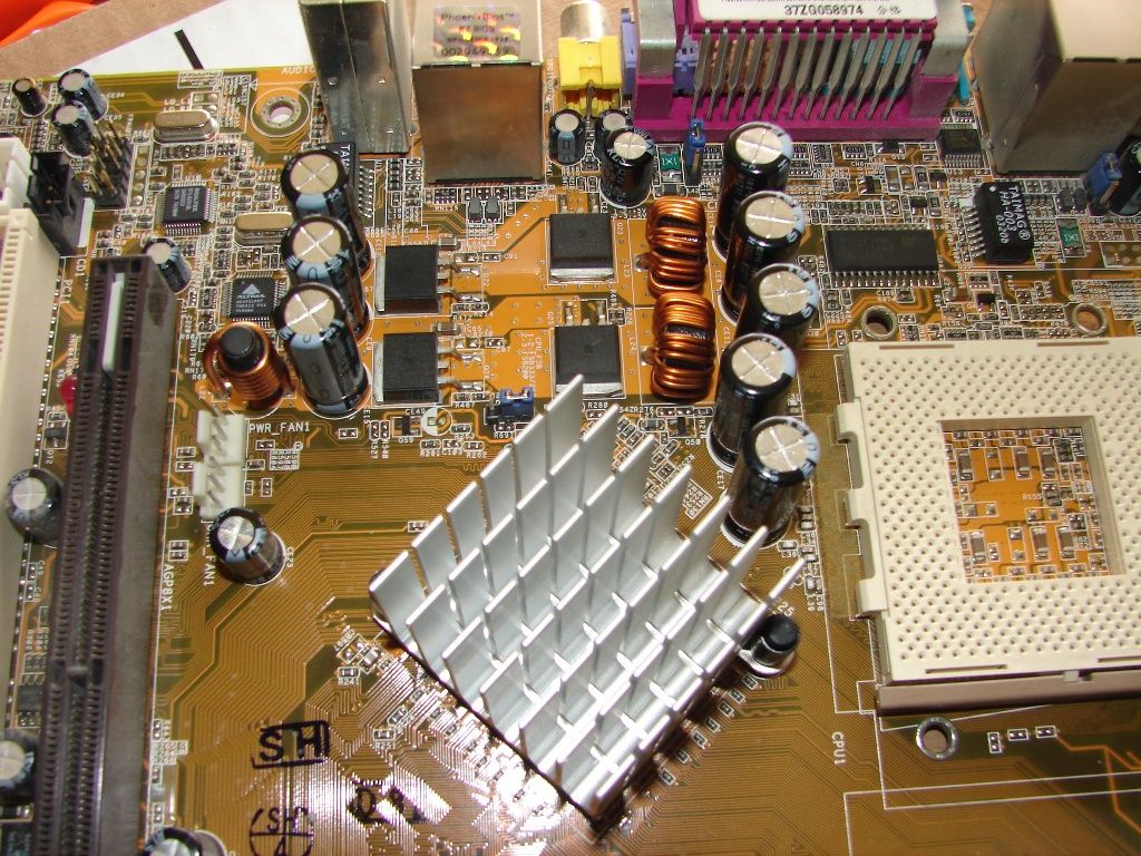

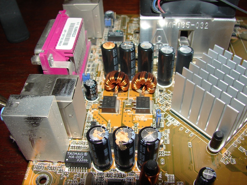

    I have searched through the forums and spent hours reading posts. I have learned a lot but most of the material is above my head so here goes the newbie question.
    I have replaced 8 bad caps on mobo but they are not a perfect fit. The board is Asus A78NX Deluxe and the caps that were bad are : nichichon 3300uf 6.3v .
    The problem is I needed 10mm and thought I could get away with 12.5 mm and they don't fit snug to the mobo. One actually sits about 5mm off the board.
    This is probably my problem and I am ordering the right size but I have to ask anyway. If the soldering joints are good does it matter that they are not flush to the mobo ? Also, I think when trying to make them fit (if it doesn't fit then force it) I may have bent the posts coming out of one of them before soldering it to the board.
    When I power board I get a green light on board but nothing further. I have taken out battery and tried with components connected and with just mobo connected to power. I have also swapped out power supply to rule that out.
    I also took into account that the negative is reversed on the Asus board and have them facing in the proper direction.
    Before fix, board would power up and boot after several restarts and forced shut downs. Then, it would freeze and have to be restarted again. This is my first attempt at recapping a mobo. I did successfully recap and fix my monitor so I got brave and am trying this.
    I have attached some picture of the bad caps and am embarassed to show the recapping but will include them as well.

        The original caps say Nichichon 6.3v 3300 uf on one side . The other side says HM(M) and 105 c and HO 323 and some HO 324. I don't know how to determine any other values from them.
        I bought from digi-key : item # 493-1714-ND.
        Nichichon aluminum 6.3v 3300 uf ;1.65 ripple; 7000hrs @ 105; 12.5 x 20 with 5mm lead space like the ones I removed.

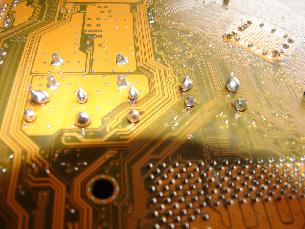

        Solder joints look good to me. When I take it apart again I will post a picture of the joints.

          Those are PW series (note "General Purpose") - not suitable for most motherboards. You should use HM/HN Nichicons, ZL* Rubycon, or FJ Panasonic...

                You are moving in the right direction. One thing you should do is read the datasheet of the replacement capacitors before you order and the original capacitors to make sure the replacements satisfy the criteria. The replacements should have equal or higher ripple current then the originals and equal or lower ESR/impendance then the originals. tom66 gave you pointers as to which series to look for as they are high ripple low ESR series.

                  Tom66 is correct... You need HM/HN series from Nichicon, not PW. I've done an A78N-X Deluxe...

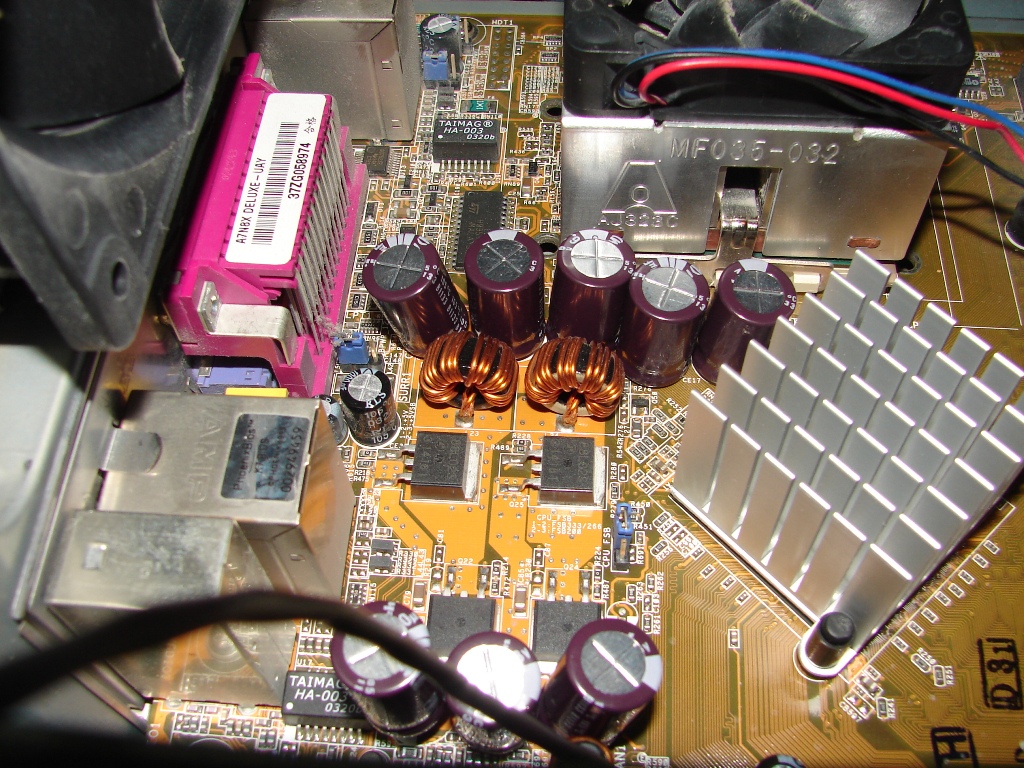

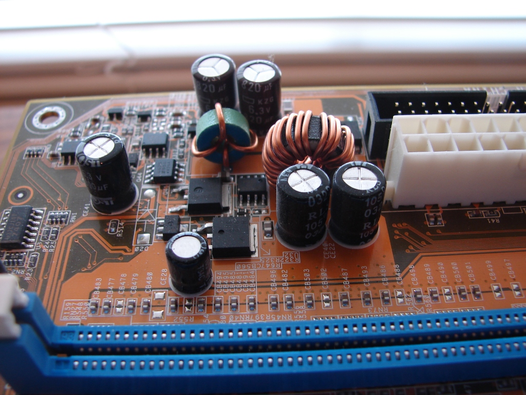

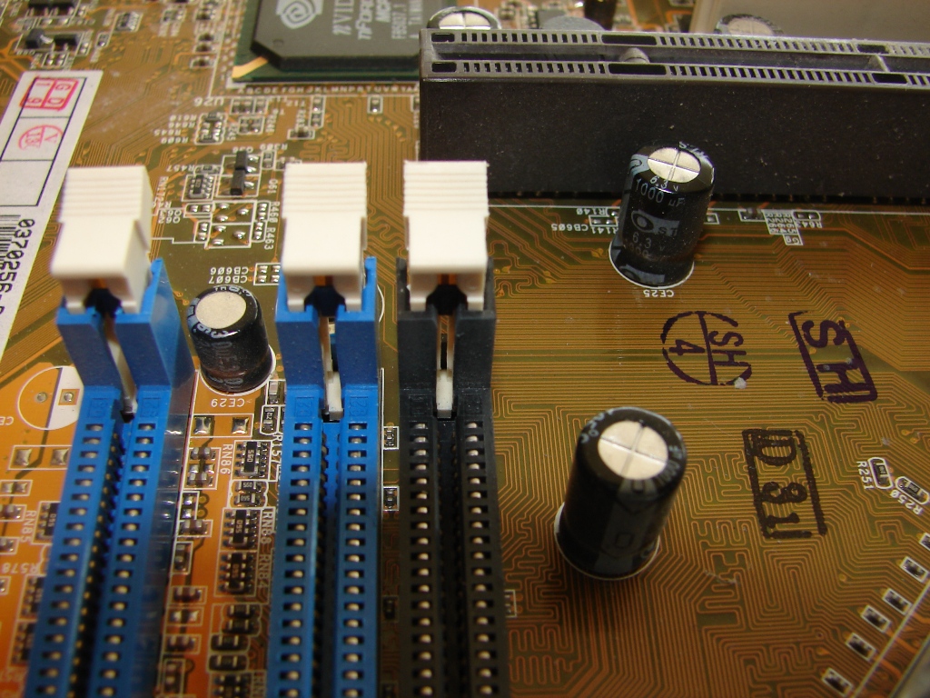

                    Can you tell me which caps near the memory slots need to be changed.
                    I have taken some more pictures to include these.
                    Some are : RLS ; Teapo ; GSC ;KZG
                    Thank you.

                      ALL of it...
                      I would do a total motherboard re-cap as it seems you got them scattered all throughout the motherboard...
                      The HM you replaced with PW... You can use HM again to replace those bulged HM caps... It's safe because the newer HM caps are reliable unlike the batch used at that time. I personally used Samxon GC because that is what I had.
                      Topcat has a kit available on his site, but it is incomplete as it doesn't include the smaller value caps.
                      Make a list of all the caps on the board in the following format:
                      1) 6.3V 3300uF Nichicon "HM" 10mm x 25mm QTY
                      2) etc...
                      I can then point you to the equivalent parts on Newark (I'm pretty sure they have everything in stock).
                      I would also urge you to seriously look at the PSU as a PSU from that many years ago must either be in need of an overhaul or replaced completely.

                        Anyway, here are the caps on the board:
                        25v 10uf RSM 4mm x 4mm - 3
                        6v 100uf Teapo 5mm x 6mm - 6
                        6.3v 330uf GSC T34c 5mm x 8mm - 2
                        6.3v 820uf KZG 3T 7mm x 14mm - 2
                        6.3v 1000uf RLS ST 7mm x 7mm - 14
                        6.3v 3300uf Nichicon HM(M) 10mm x 25mm - 8 (these were the bloated ones)
                        I think this is all of them. Had to use a flashlight and magnifying glass to really see them and some I was not able to tell the type.

                          I doubt if you'd need to replace the small ones without vent stamps. Just replace everything 330uF and up. As the other members have said, go with Nichicon HM series.
                          • c_hegge
                            • Sep 2009
                            • 5219
                            Re: Need recapping help for Asus A78NX
                            These replacements should work
                            6.3v 330uf GSC T34c 5mm x 8mm - 2 - http://www.newark.com/panasonic/eeuf...-3v/dp/04M8999
                            6.3v 820uf KZG 3T 7mm x 14mm - 2 - http://www.newark.com/nichicon/uhm0j...-3v/dp/70R1135
                            6.3v 1000uf RLS ST 7mm x 7mm - 14 - http://www.newark.com/nichicon/uhm0j...w%20Capacitors
                            6.3v 3300uf Nichicon HM(M) 10mm x 25mm - 8 (these were the bloated ones) - http://www.newark.com/nichicon/uhm0j...-3v/dp/70R1133

                              c_hegge's replacement suggestions look good. Leave the 25V 10uF and 16V 100uF per his advice...

                                  Take it easy guys, the first thing he should do is replace those PW's on the vrm to see if the board will work at all. since the thing was booting fine before the recap I doubt that the small ones need replacing, at least not before seeing if the board is viable for a full recap. Otherwise the whole thing would be just a waste of time and money if the board happens to be dead.

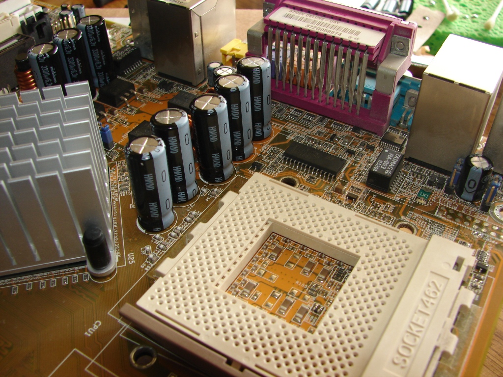

                                        Well, I have recapped and get power to board, fans turning on cpu, psu, and case fan . This is an improvement from the first cap attempt with the wrong caps. Unfortunately though, it will not go to POST.
                                        Have cleared cmos, removed battery and moved jumper to clear cmos several times. I had noticed one of the caps felt loose so I removed board and found a bad solder joint. I fixed that joint with new solder but this did not solve my problem. Still no POST.
                                        Remember, before recap I would POST but it was unstable and required several restarts. Since recap, I have never made it to POST.

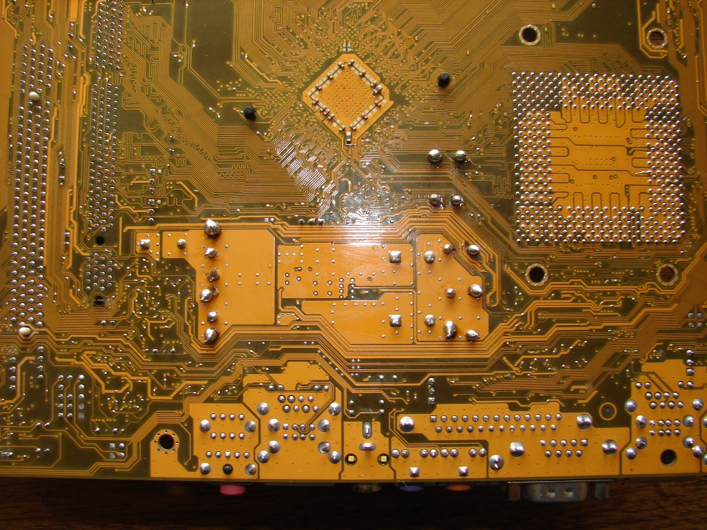

                                        I am not 100% confident with my soldering skills as I am brand new to this.
                                        Any suggestions ? Thanks.....
                                        Here are some picture of soldering (don't laugh) and mobo with new caps.
