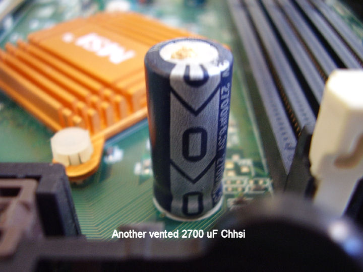

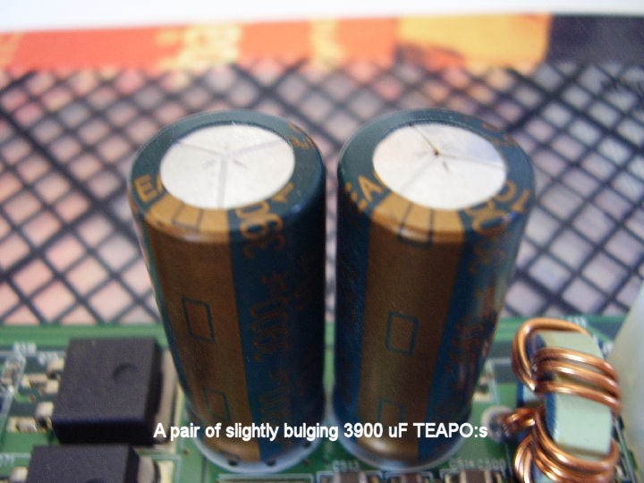

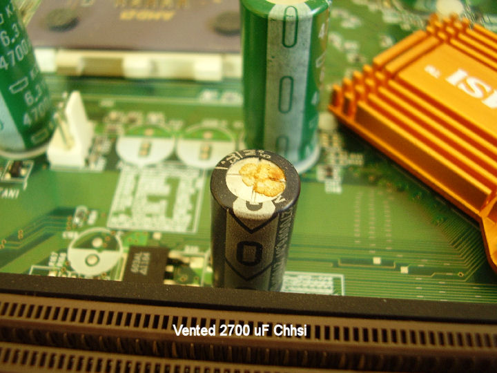

    When inspecting the MSI board, I could see two vented caps, Chhsi 2700 uF, adjacent to the AGP slot, and two slightly bulging 3900 uF TEAPO:s on top by the power connector. The rest showed no visible signs of being bad.

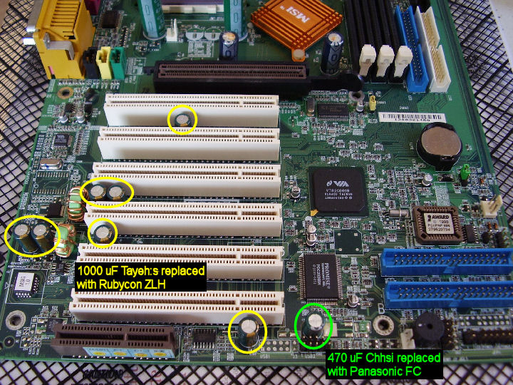

    Finally, after training on some trashed boards, I got up the nerve to get the recap underway. Removing the old caps was relatively easy, with the exception of the ones situated between the PCI slots, with the holes perpendicular to the slots. Soldering the new ones wasn't much of an issue either. The really difficult part was to clear the holes. I tried with a stainless steel dental pick, but it was very difficult to get it through. With a sewing needle, it was much easier. Perhaps the needle soak up less heat. In a couple of tight spots, I had to soak up a short with solder wick. A powerful magnifier, I use one with 8x, helps here.

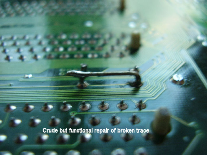

    One lesson to be learned however. I almost ruined it, when I got careless and broke a trace. Add to the commandment list: "Thou shalt not ever position the tip of the soldering iron across a trace." I was able to fix that with a crude but functional repair, see attached picture.

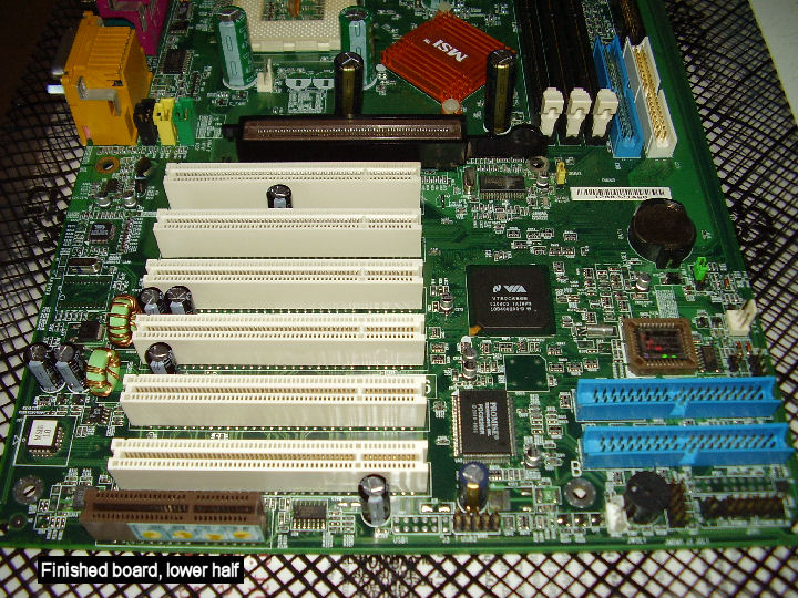

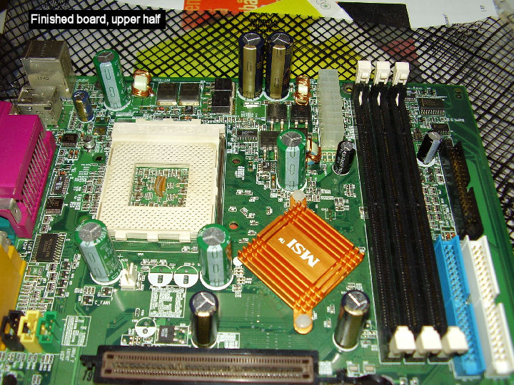

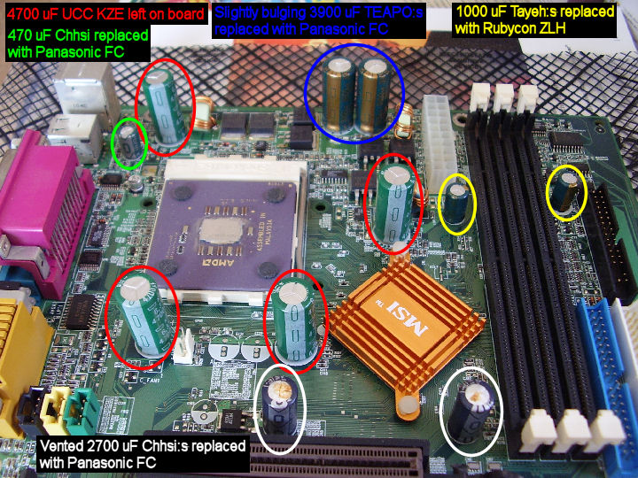

    Anyway, now the board has 15 new caps, 2x3900 uF replacing the TEAPO:s, 2x2700 uF replacing the Chhsi:s and 2x470 uF by the USB ports, also replacing a couple of Chhsi:s, all of those Panasonic FC. Also nine new 1000 uF Rubycon ZLH, replacing the Tayeh:s originally on the board. The four 4700 uF UCC KZE around the CPU socket I decided to leave, as they look fine, and are from a reputable manufacturer.
    It POST:ed on the first attempt, the voltages are rock solid, within 2% of nominal values, all the PCI slots work, tested with a PCI graphics card, the USB ports work and the board has completed 10 hours each of Memtest and Sandra runs without problems. I'm a little astonished that I actually pulled this off. I could never have succeeded without the information from this website. Simply invaluable.

    i know the feeling....... welcome to the club.
    pity about the trace, perhaps next time it will be a perfect job, good work fixing it though.
    what iron are you using?
    anyway i have found it necessary to change technique for different holes. i have several kinds of needles. if i have problems i will add solder to both sides of the board and put the corner of iron into the hole on both sides for a second, then try to get the needle some way in on one side while heating from that side, then change and heat from the other side to push it all the way through. depends on the board though. newer boards are difficult.
