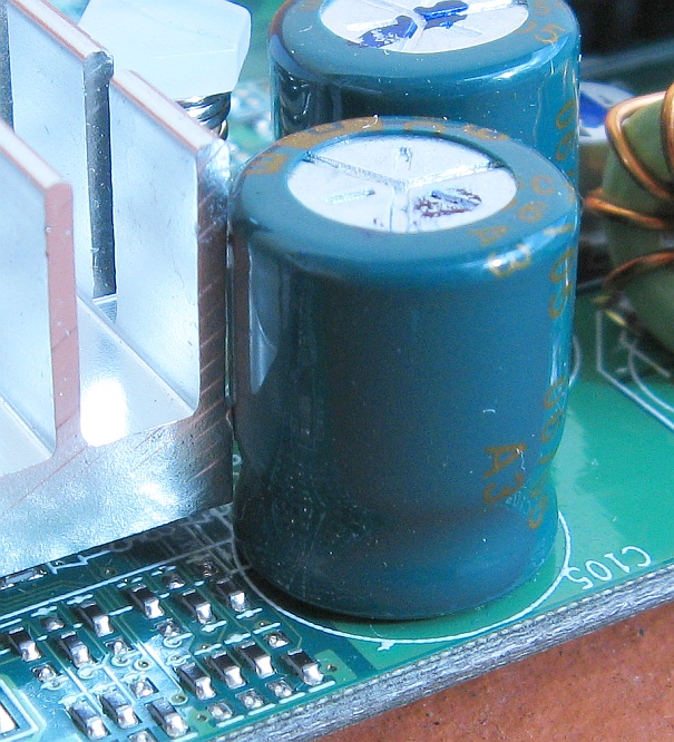

    The case was opened and no signs of oozing or bulging caps on the motherboard.
    The video card was removed for close examination. This is an ATI Radeon X300SE 256MB with HyperMemory, and the electrolytics here also show no signs of oozing bulging. I have a Capacitance Meter on the way through the mail, but after I saw C105, and how it was installed, I may not even need that (see attached image).
    This card has a fanless heatsink, that therefore runs warmer than fan-cooled models, but note the Radeon board's unique way of avoiding overheating of the sink, by digging its edge into the electrolytic's plastic sleeve, probably getting metal-to-metal contact, and so preserving the life (of the heatsink!!) by dumping its excess thermal energy into the electrolytic's shell. A marvelous piece of engineering, indeed.
    Do they make all their boards this way, or am I just lucky?
    I don't think this is the 'capacitor plague' -- I suspect it's just 'heat-sink cooked capacitor'. It's rated at 1000uF 6.3v, but I'll try my Capacitor Meter on it as soon as it arrives. I suspect it's going to be down, a bit??
    Advice, please: I'm sure not going to install the replacement cap in the same way. I am thinking about a Nichon brand cap, one that comes with a smaller diameter and a slightly higher shell. Good idea??
    Any comments on what I'm proposing? Or, would anything be better than the original factory installation?

      Measure the diameter of the capacitor then lookup Panasonic FM/FR series, Nichicon HM/HN/HZ series, United Chemi Con KZE, Rubicon Z** or RX (high temperature, but select ones rated for 10-16v instead of 6.3v for better specifications)
      If you find only wide caps at 6.3v you may find capacitors rated for 10-16v that are less wide but taller. Going up in voltage is OK, just don't change the capacity value.
      The series I mentioned above are the kind of series that have high ripple and low impedance/esr, both important on computer parts. Not all series or capacitors can be used, just by getting same capacitance value.
      Note that you won't get accurate measurement with the capacitor mounted on the board. Take it off to do measurements. Even so, capacitance could be within specs (+/- 20% but ESR could be high, due to the temperature it was subjected to)
      Later edit: If you replace one, you should replace the other one as well or the ones near it if there ares several. Replace all if the brand is OST - afaik they're unreliable.

                      If you have room, put the new capacitor on its side and bend the leads over (don't bent right up against the body though!)
                      That way it won't be near the heatsink.

                          Good idea. I've already beveled the heatsink's corner, and it no longer touches the cap. To my slight disappointment, the sharp corner was not cutting into the cap's plastic sleeve -- what I saw as evidence of that must have been a reflection in the photo. Getting the new cap farther way would be best.

                            I guess if you have no multicoloured lines down the screen that's a good thing.
                            But if it is capacitors, it probably isn't just the one next to the heatsink, if they're failing, likely all or most of them are.
                            Only way to know if the capacitors are bad (and if not bulging) is to measure with ESR meter and check against what they should be (although finding that out is sometimes difficult)

                                    With heat issues solid polymer are the way to go if you can find some suitable.
                                    They usually have the same max temp rating but they don't suffer from dry-out.

                                        I only brought that up because I assume it would run 'warmer' than a motherboard, and so would give the 'nod' to a brand of caps that works better under these conditions.
                                        I just took the board taken apart to modify the heat sink, and there's no visible indication of heat damage (discoloration, or anything else). In fact, the board and components all look like brand-new.
                                        I take it, from the comments so far, that either brand of caps would be equally suitable for this application?
                                        By the way, the selection of caps I'm looking at, both brands, are the ones on the badcaps site.
