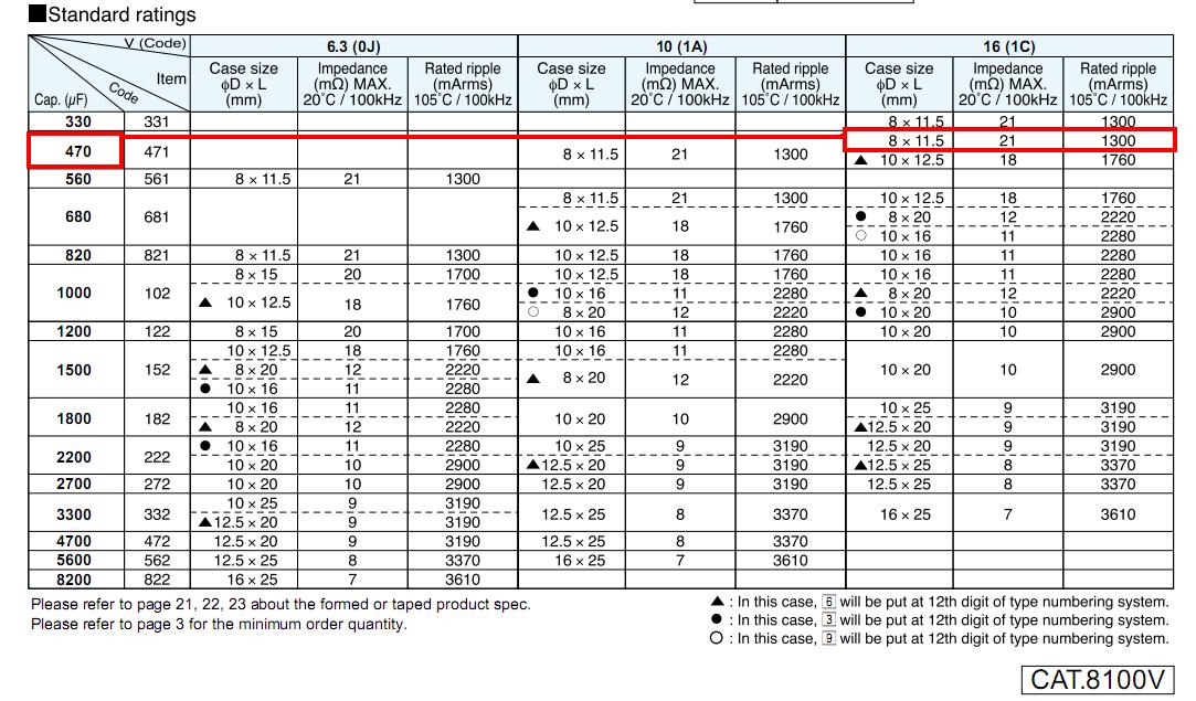

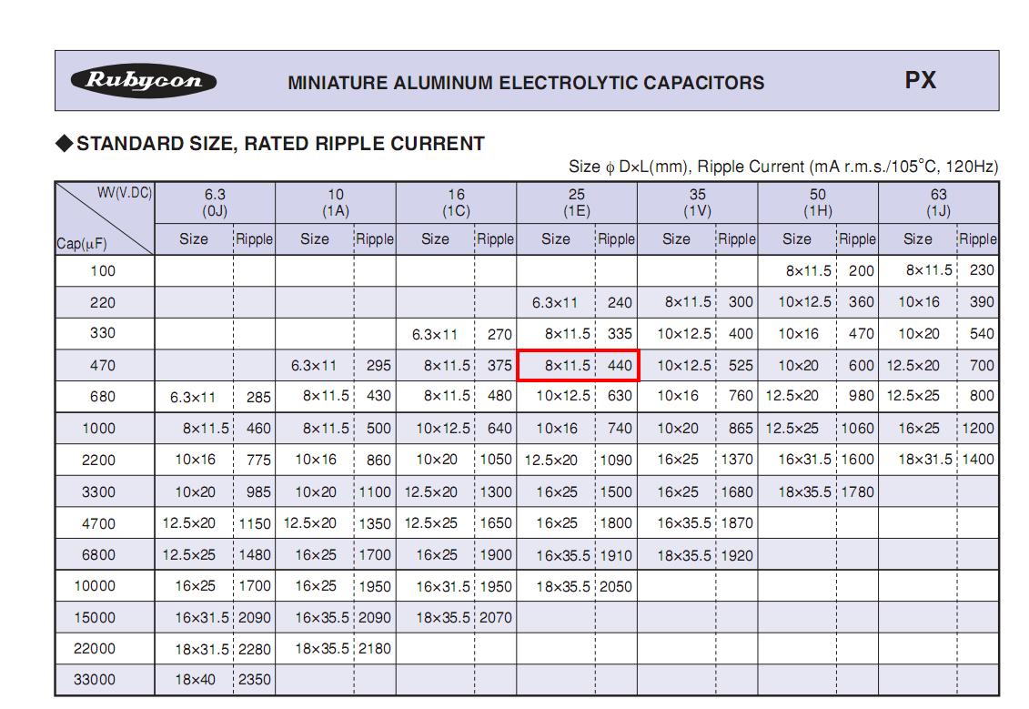

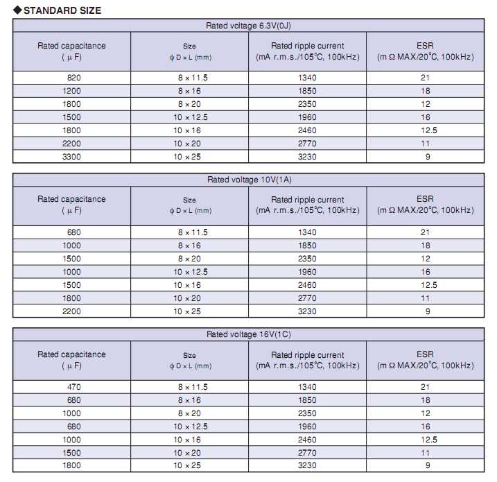

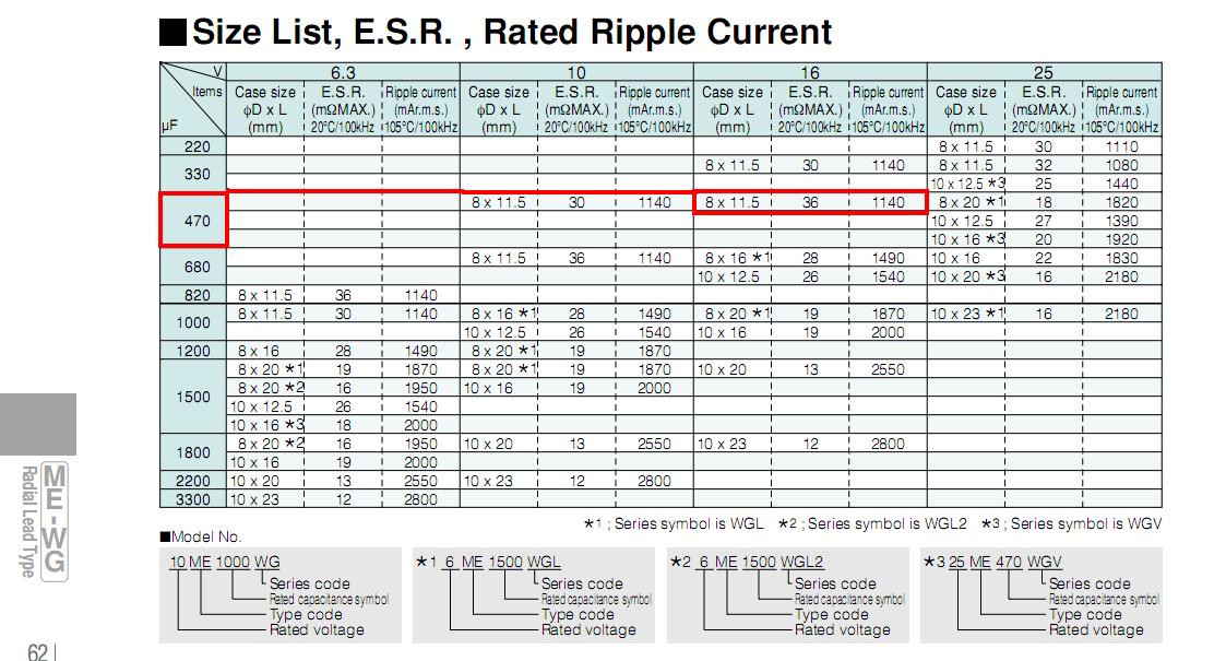

It was slightly better than the average onboard video chip -- of seven years ago. I just want to keep it going until the motherboard is replaced. The cost of four caps plus postage is just about right, to invest in an X300SE.
Any suggestions on which I should choose would be most appreciated!
