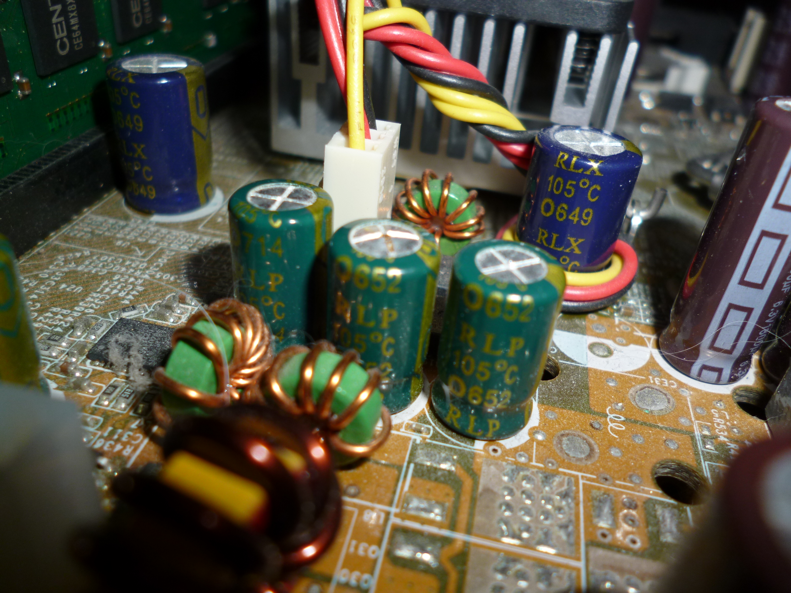

    I just acquired a Shuttle XPC SD30G2B from a lot of assorted parts off craigslist and the system does not power up. The flex atx power supply isn't the problem since doesn't power up using a full sized atx psu. The previous owner say it just stopped powering up a few months ago.
    It's a FD30 rev 1.x board. Only one capacitor that has signs of failure (slight puff). I'm planning on replacing it and others identical.
    Has anyone had experienced or comments on this board?

    Re: Shuttle XPC SD30G2B (FD30 motherboard)
    just because other ones aren't bloated dosen't mean they're good
    do you know what brand they are?
      The bad one is green OST 10v 1000uf, there are total of 8.
      Other brands of the bigger caps are KZJ, KZG, and RLX.
        KZJ/KZG should all be replaced. They often fail without bloating. RLX is made my OST I think and OST is just so that should be replaced. Also check the PSU for bad caps.
              Replace all OST caps on this board. Note that there are different series of OST. There's:
              * OST RLP and RLG ---------> replace with Chemicon KY or KZE, Nichicon HE or HD, Rubycon ZL or ZLH, or Panasonic FR and FM
              * OST RLS ---------> replace with Chemicon KZE, Nichicon HD, Rubycon ZL or ZLH, or Panasonic FR and FM
              * OST RLX ---------> replace with Nichicon HM or HN or HZ, Rubycon MBZ or MCZ, or polymers if around CPU VRM.
              As for the KZG and KZJ - those are made by United Chemicon, which is a good brand of capacitors. But those two particular series, the KZG and KZJ, are known to fail often. So it is highly recommended to replace those too. Use same replacements as for OST RLX.
                Thanks for the help!
                Is there any difference between the O714 RLP and the O652 RLP. Both are marked 10v 1000uf .Take a look at the attachment. You can see the middle RLP bulging at the top. Its right in the path of the Northbridge fan air exhaust . Prolly the cause for failure. I'll replace those 3 and see what happens.
                  Year & week date codes - 14th week of 2007 and 52nd week of 2006
                  Unusual for a board to have capacitors with that much age difference, unless one's a replacement - perhaps something to do with a holiday period close to production date
                    Other than the date code differences that pfrcom mentioned - no. The caps have the same specs.
                    That's fine, but I recommend you get replacements for all of the larger OST capacitors on the board (anything rated at 330 uF and above). If you end up replacing those 3 caps and the motherboard works, then definitely go ahead and replace the rest of the OST capacitors. Otherwise, be prepared to tear down the PC again sometime in the future. OST caps rarely last in anything.
                      Thanks,
                      Stinger
                      quoting this post since the pic has the exact same bloated cap as my SD30G2B has, I replaced the whole group of 3 with nichicon HM, but still get no boot out of mine any other thoughts?
                      Also wanted to point out the northbridge isn't getting hot even with the fan connected and the ram feels cold too, thought those would be warm with it sitting there.
