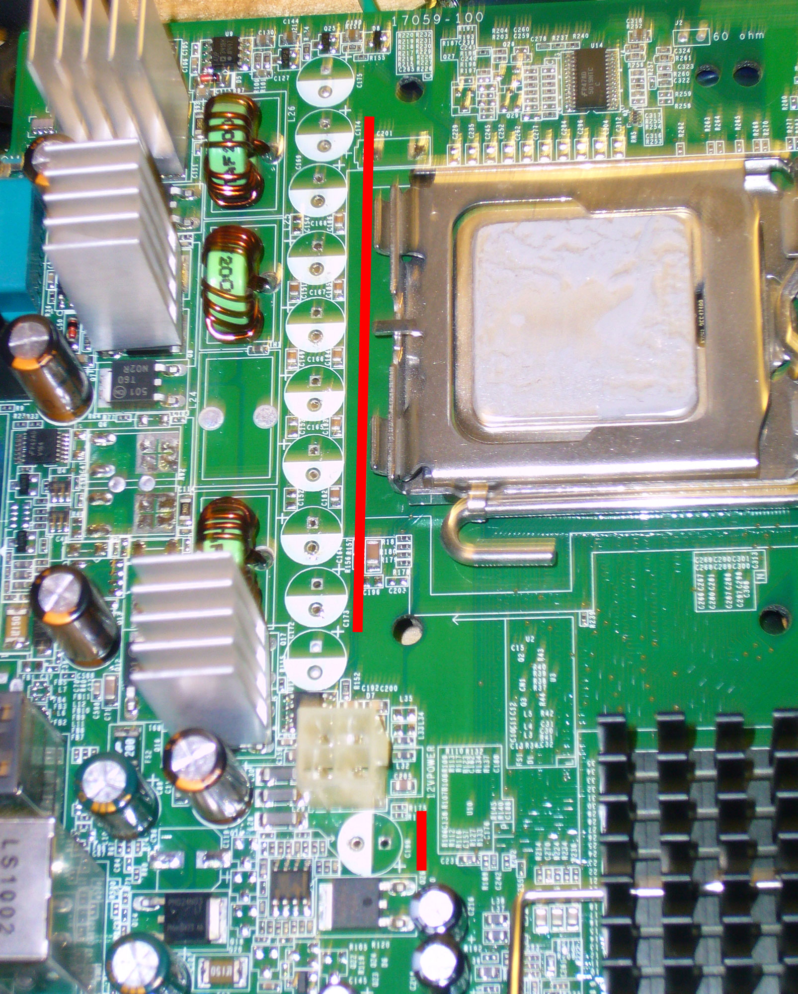

                                    Thank you both for your help so far -- appreciated. I think it best if I back up a bit and post a picture to help explain both. Normally my pics are nice and clear - this one was a bit hasty, but hopefully will suffice.
                                    As you can see, there is room for 10 v-core caps. This space was populated by 8 1800uf/6.3v 8x20mm MCZ's. To be honest, I really wouldn't care if these were replaced by lytics or polys. My reason for leaning poly was that they were already MCZ's and all went out, plus, Digikey doesn't appear to have any lytics in stock that would work.
                                    I've also marked the one oddball below the v-core. Again, I would be happy to replace with lytic, but can't seem to find any and would really prefer to order from Digikey as they are close and I already have an order started with them.
                                    • PCBONEZ
                                      Grumpy Old Fart
                                      • Aug 2005
                                      • 10661
                                      Re: Dell Dimension 4700C - V-Core Rubycon MCZ's were ALL bad
                                      I would use 8x 820uF Poly mostly because of the heat there.
                                      The ESR on the MCZ was .012 so go for something with less.
                                      [And a lytic at 'stock' uF for the odd one.]
                                      Digikey does not carry any Lytics better than Panny FM unless they recently added something.
                                      And AFAIK all Mouser carries in lytics with better specs than FM is Nichicon HN and HM.
                                      BCN should have what you need too.
                                      Are those black/gold caps to the left HN and if so what is the date code?
                                      Those dated '01 thru '04 were defective.
