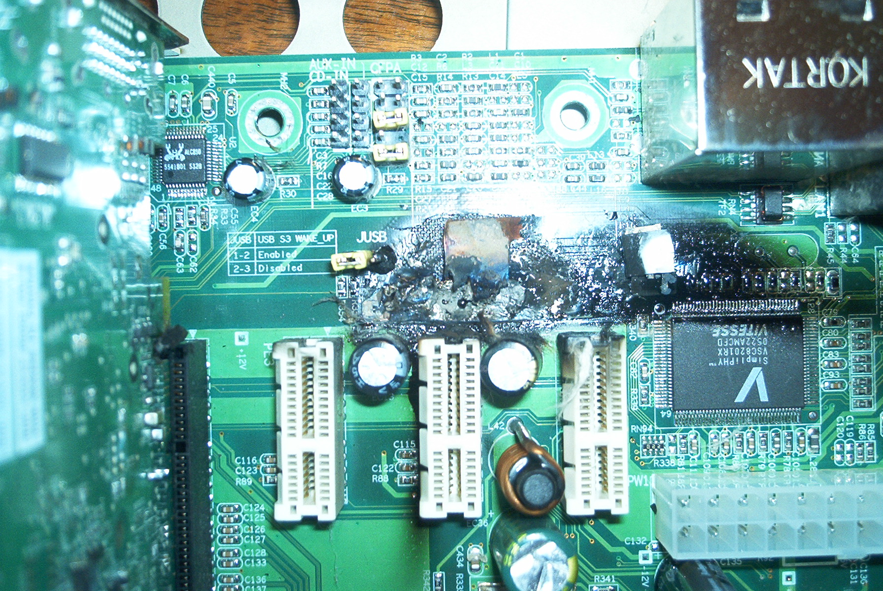

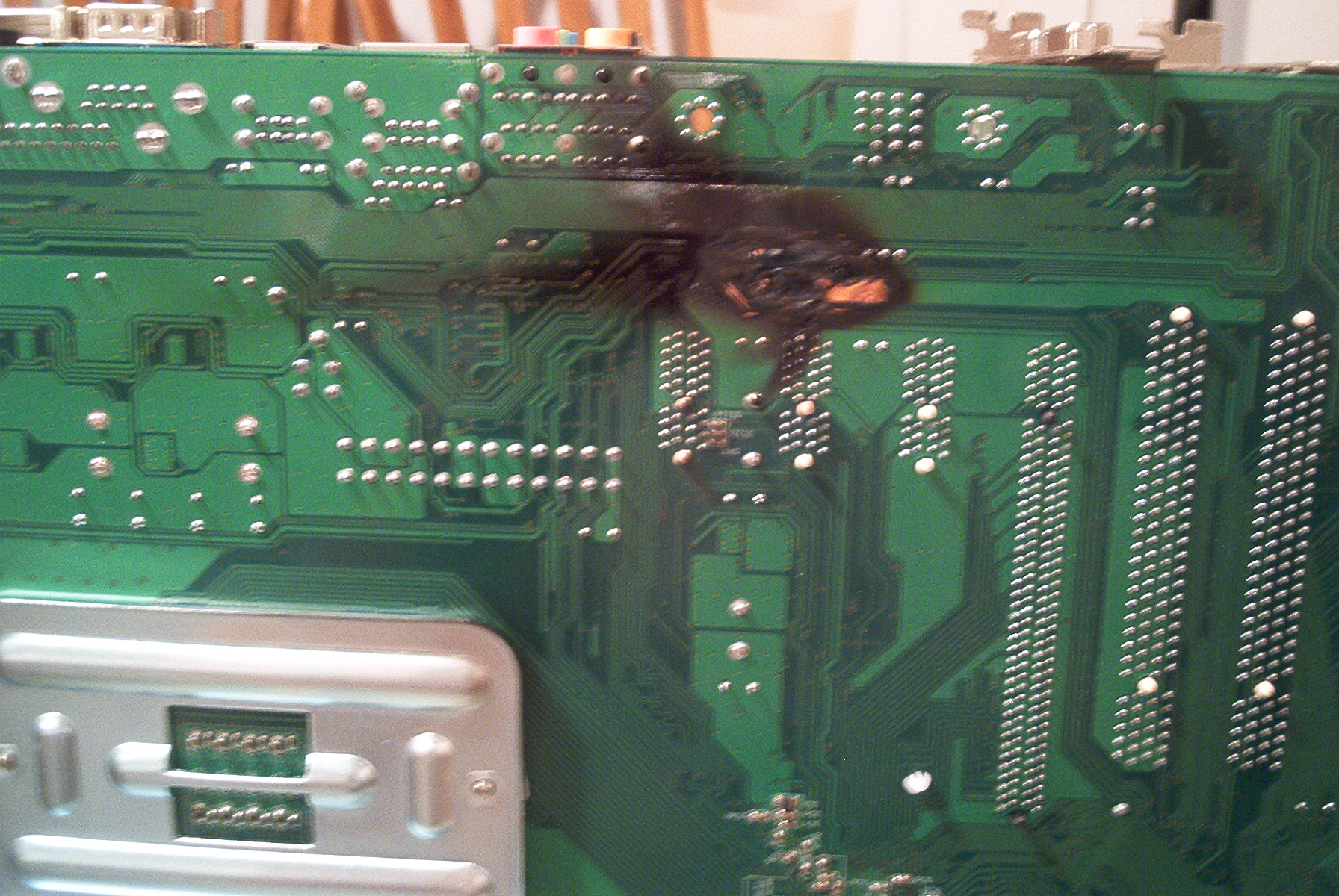

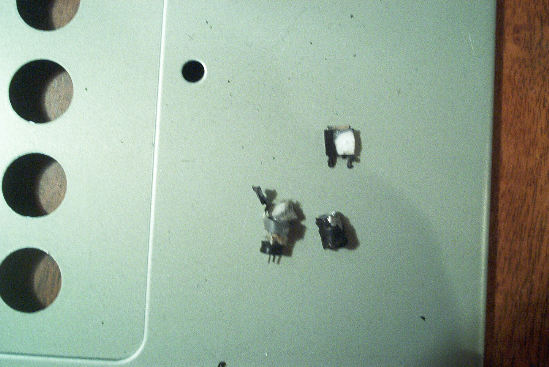

    Recently installed EPOX 9NPA Ultra NForce 4 board w/ AMD 4400+ X2 CPU and 2 Gb Dual channel DDR400 RAM. Set this system up for video processing. At about 3:00 AM Saturday morning, house smoke alarm goes off. EPOX board is frying away...
    Attached pictures show front and back of board, and blown up capacitor and some other component. This seems extreme for a capacitor only problem; I had an EPoX 8KHA board that had the classic leaking capacitor problem, but it certainly didn't fail like this one did; the 8KHA lasted 5 years before it went belly up...
    Any ideas? EPoX has been contacted, but they are currently leaning toward an install problem (short circuit w/ mounting board). I've installed several MBs, so its going to be cold day in hell before they convince me that this related to an install problem...

    Wow! Very nasty. The underside shot of the board might lead Epox to a short under the board to the case in that the copper buss is burnt through. However looking at the cap it is certainly burnt/blown away. Caps do not fail with a motherboard short to ground/case, the only short that could, would be short to a higher voltage rail that would destroy the cap (even a semi failure). The evidence suggests a short in the cap or semi, blowing the cap and the semiconductor.
    I suspect this is your conclusion.

      Ouch! It's rare for a new board to go like that, I'm sure that's why epox is leaning towards install error... Not to say anything about your capabilities at all, as it's certainly possible for a manufacturing defect to take out a board like that.
      How long was the system operating normally?

        could have been a internal trace fault.i remember a 4 layer board a local company had issues with flameouts.
        turns out the problem was a error in an inner power trace that put it too close to a ground.
        each bare board had to be tested with high voltage before stuffing and soldering.
        these were in a custom smps that put out 48v dc at 100 amps.the arc would not trip ocp till the thing was a fireball.exploding lytics would contribute and keep it going.worse yet the topcover was plastic!

          EPoX has now agreed to take the board back and replace... Already ordered MSI board... Kind of down on EPoX given the earlier capacitor problem and now this flameout....
