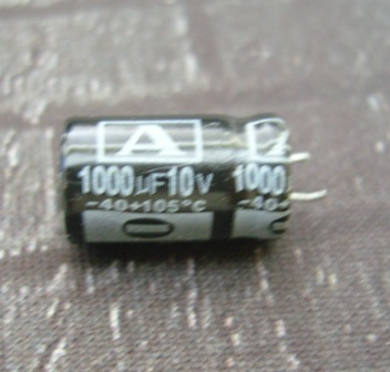

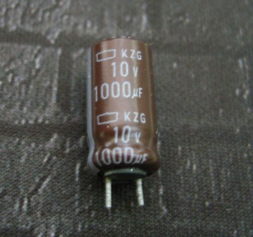

    I have an ABit IC7-MAX3 motherboard that recently became useless due to swelling United Chemi KZG caps which are 1000uf 10v 8mm x 16mm and I replaced them with something off an old board, same capacitance and voltage just a shorter can and I can't tell you who they are made buy they just have a "A" in a square on the side and the board posts again but I want to replace them with new caps so I am asking for recommendations here. I replaced 5 of these and I believe there is one or two more on the board.
    So what caps should I use?
    Thanks for the help.

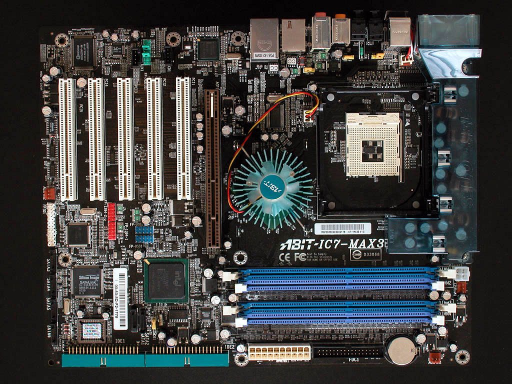

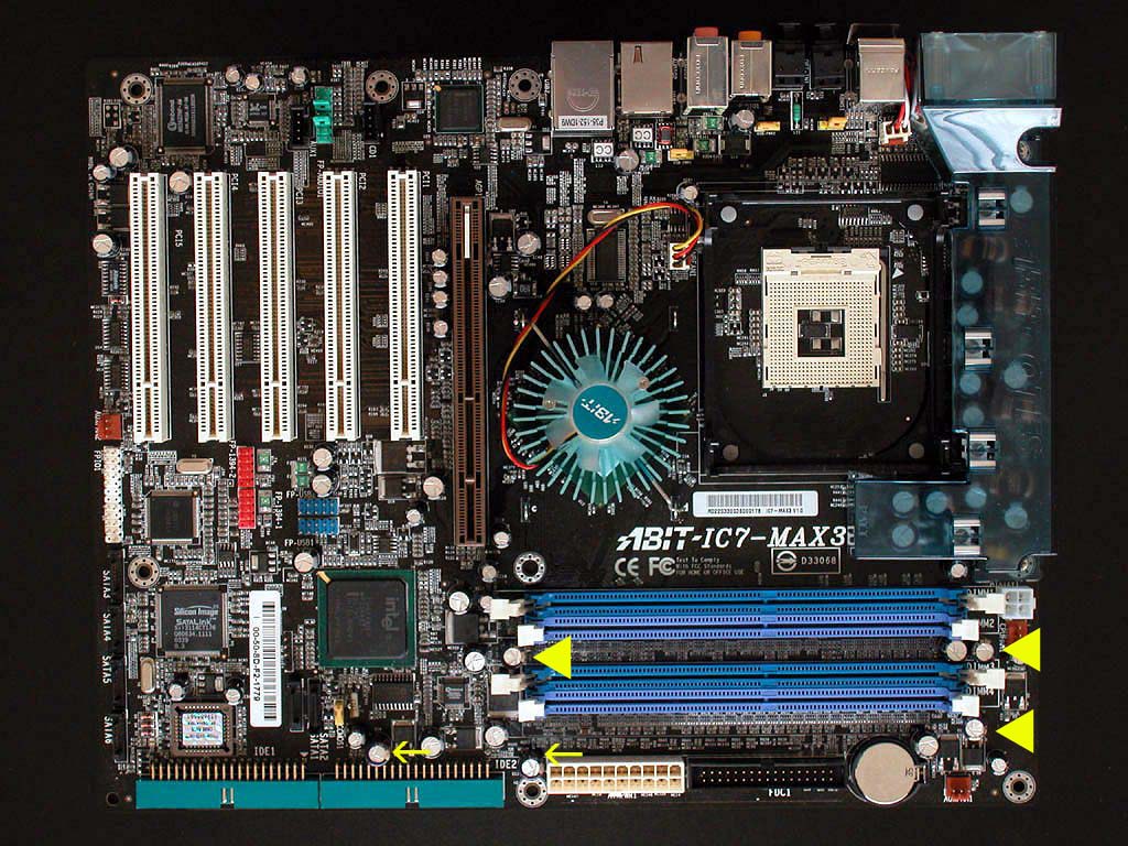

                  Can you post a pic of the board or take the one I attached and indicate which caps these are?

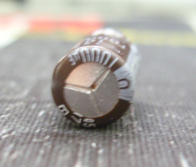

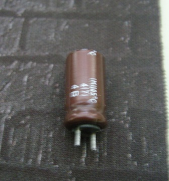

                    I indicated the caps with yellow arrows, there is only one more United-Chemicon cap left and its the one between the ram banks on the right side of the board. I have another of the frankenstein cap I robbed from an old board but since I will be replacing all of them again with the appropriate parts I will not be changing it yet as it isn't swollen. The board is working fine it takes a few seconds more to get the initial beep when you turn it on. I just assume its because these caps are not quite the exact match. Included are pic of the Frankencap and the original cap (the worst of the five)

                      According to: http://capacitor.web.fc2.com/
                      that's: http://www.arktwn.com.tw/ and http://www.arktwn.com.tw/table.htm
                      Just need the series. BUT, who cares? You're going to put better than that on there anyway
                      Hopefully that's the last of the KZG on the board. What brand and series are under the "shield" near the CPU? (curiosity)

                        Everything else is Rubycon on the board there were only 5 KZG on the board.
