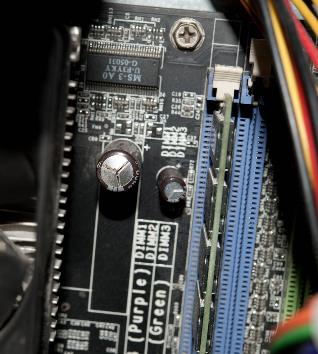

    I didn't see this one here so adding it to the list. A socket motherboard around 5 years old. I cannot see any ID on the caps but they are a red / brown colour which resemble some of the pics in the hall of shame and marked as KZG.
    Currently I've about 5 of them bulging their little eye out. One to the left of the sim slot, two to the left of the CPU slot (closest to the cpu), two south of the cpu slot and all 2200uf 6.3V. The others all appear ok.
    On thing when looking at new caps and their lifetime rating is that I notice a lot are around 3000 hours. This doesn't seem a lot - I leave my computer running most of the time. In 24/7 terms that's only 4 months. Am I missing something here?

    3000 hours is the endurance lifetime. ie. the expected lifetime IF they are run at 105*C, with their maximum ratd ripple and voltage. the lifteime doubles for every 10*C below the maximum temperature.
    Replace ALL Chemi-con KZG caps on the motherboard, since they are bad caps and often fail with no visible signs. These should be fine to replace them.

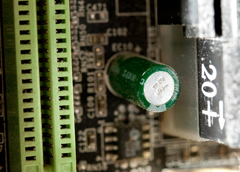

          Unfortunately I can only see one side of the cap which simply shows M 105c, There are some numbers on the top though.
          Some bad pics taken just now, best I can do at the moment whilst it's running and poking a full size slr into the case.
          This green cap is on the right of the memory slots. There's one other which is situated in between the agp and first pci slot. Any numbers writing on this is hard up against the pci slot.
          As with the red / brown ones I don't see any manufacturer mark on any of them. I've assumed KGZ only because they look so similar to the ones in the hall of shame.
          2nd pic just shows the redish brown 2200uf cap on the left of the memory slots.

            Re: MSI K2N2 Delta 2 LSR
            wow that kgz looks completly aired out
            last you knew did this board still boot up? not sure you should try powering it on till you get those larger kgzs replaced

                  Top numbers just date usually.
                  Green cap looks okay anyway.

                        • 10661
                        Originally posted by Louiscar
                        It's in use right now, I'm writing this on it. I am worried about it of course but at the moment I've not a lot in the way of an alternative at the moment. Using just one GB memory it's so far stable but that can change fast of course.
                        Using a board with vented caps can lead to all sorts of additional damage including completely blown chipsets and fire.
