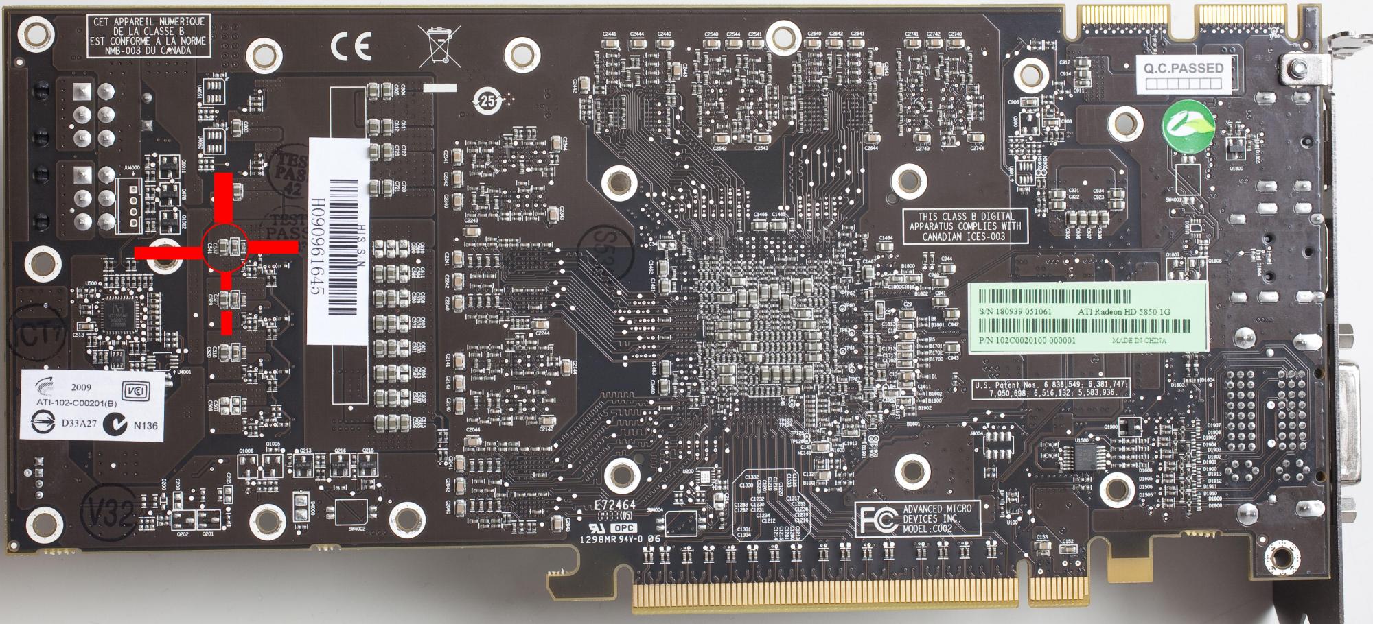

    My Saphire HD5850 (reference PCB) has a missing capacitor (C541) and I need to replace it, but I don't know which component I need to buy.
    I have attached a photo I found online which shows the capacitor that needs to be replaced. Hopefully you'll be able to see clear enough.
    Can anyone offer any advice to help me get the right part?
    Many thanks,
    Bob
    Re: Help! Can anyone help identify this cap on HD5850?
    I would say it is the same as the 2 next to it.C529 and C520. Would have to take it off to get an accurate uf measurement. I don't know the voltage ratings of most smd parts by looking at them, but someone may. I guess you can see that this piece was physically there before by looking at the solder pads. Pads not smooth anymore.
      Wel, after googling a few minutes, I see where the capacitor above yours is missing. You might try to contact their support to see if they can tell you.
