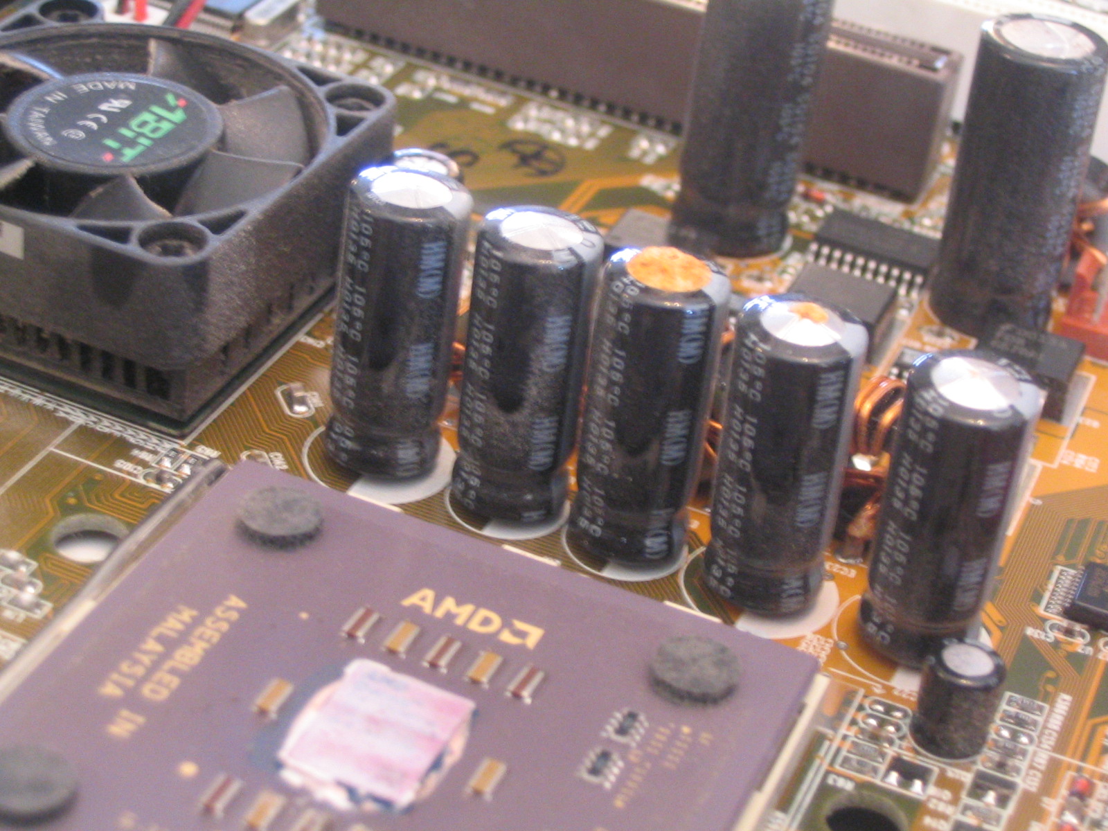

    While shuffling room contents during our home improvement project, I glanced at the mobo on my daughter's system. It's an ABit KG7-RAID that has run pretty much nonstop since summer 2002. I've been a bit lax on maintenance, I haven't been inside it in about five months. Six bad Nichicons; 3 leaking, 3 bulging. Can't tell what series. I'll attempt exact ID and pics next week (hopefully). This board is covered in Rubycon and Nichicon caps. It's in an aluminum Chenming (same design as the one I've posted in FS/FT forum) with excellent negative airflow. I'm just about to be sick. Now just waiting for the Panasonics on my QDI to fail...

    That is very frustrating to see, and I think for Abit too because they prolly built this board after all the flak the got over using poor quality caps and they used good quality and they fail anyway...
    Impatiently awaiting the pictures ;-)

      Nichicon 105 deg 3300 mF 6.3v HM(M) H0135
      Sparkle PSU FSP300-60GT mfg. in 1999; Matushita beer cans. All others are perfectly flat- topped, no bulging/leaking bungs Fuhjyyu; PSU is on its third fan and has run pretty much since the day I got it.

        thats interesting because dell referred to a period quite a few months after your board was built.
        "The problem is isolated to a specific capacitor supplier which was used in system boards manufactured from April 2003 to March 2004. The defective Nichon capacitors were placed on two manufacturers' GX270 motherboards between 04/01/2003 to 03/20/2004.
        i think that is the first HM series fail pic i have seen, the others were HN series.
        gonna recap it?

          Yes. I'm sending it in to TC tomorrow or the next day. It's "mission critical" (daughter's PC) and I only attempt soldering on boards that don't really matter until my solder skills are up to speed.
