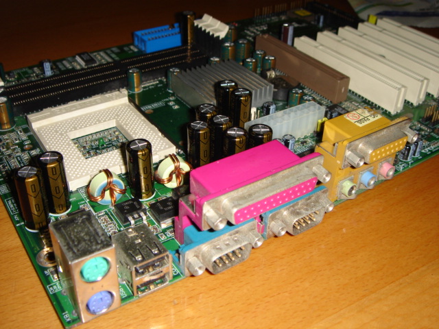

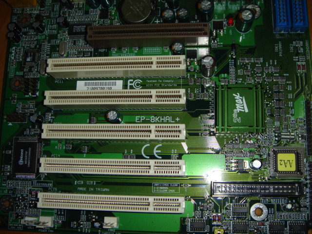

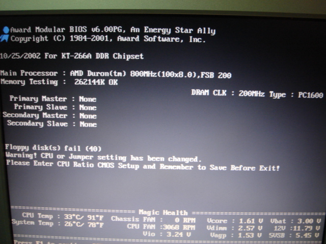

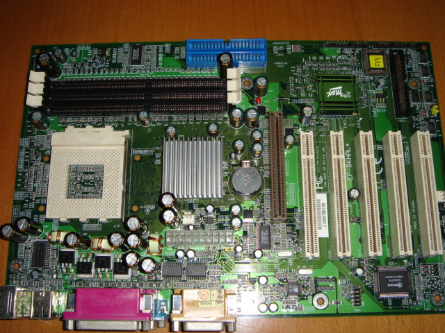

This is my 3rd 8KHA+ for replacing caps. This motherboard is also a bad caps at the bad list motherboard. The pictures are replaced with SAMXON caps.

are the green ones samxon also?
what soldering equipment do you use? -
Re: Epox Ep-8khal+
The green are TEAPO. All Ultra Low ESR SAMXON capacitors are black background with golden letters.Originally posted by willawakeare the green ones samxon also?
I just used with a normal HAKKO 40W(red)soldering iron with 0.50mm solder only.Comment
