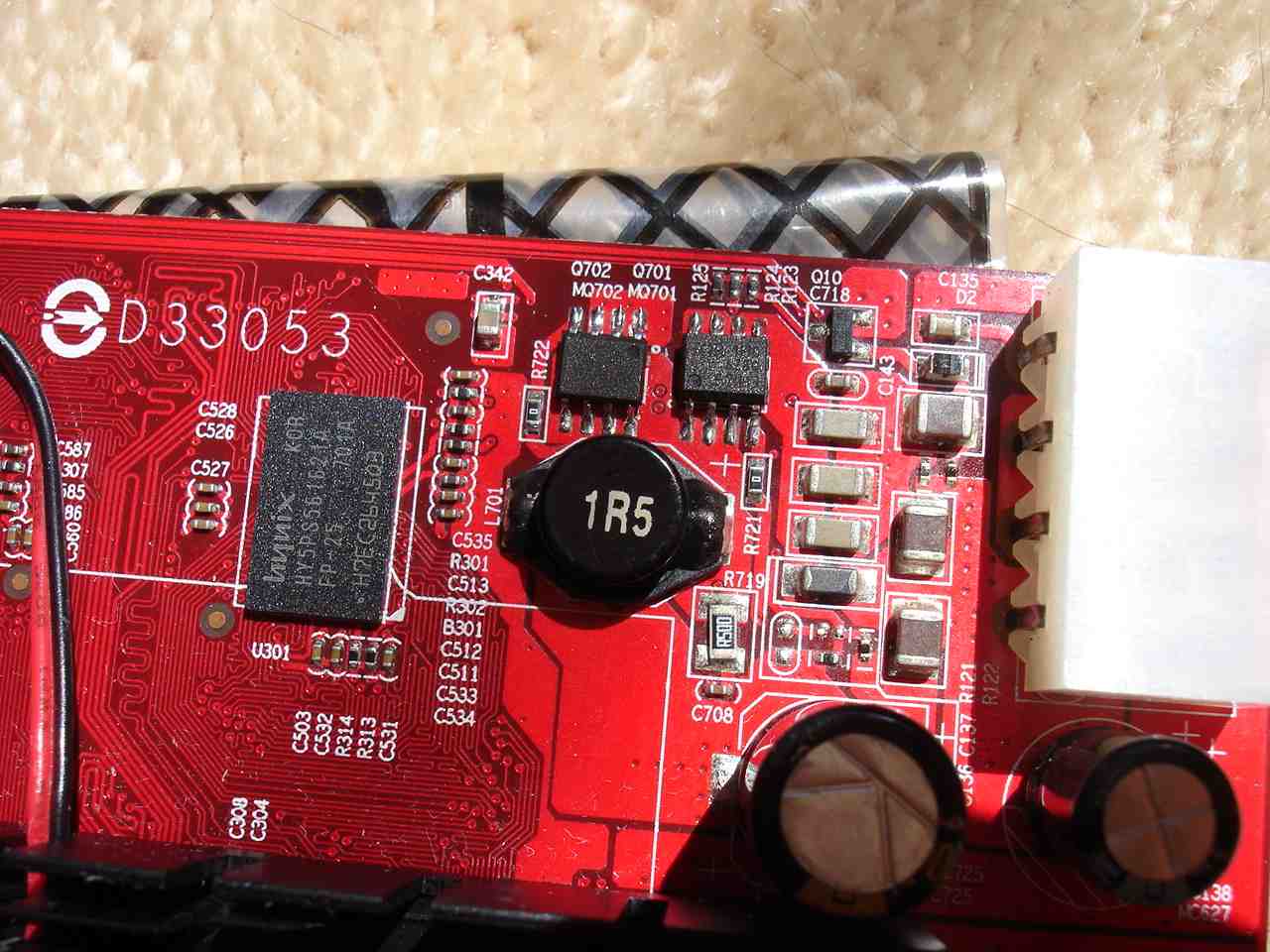

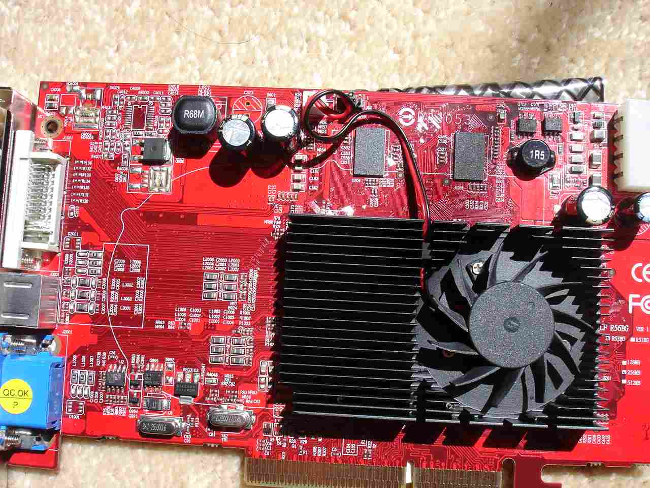

    The replacement 70T03H shows voltages on its S D & G pins, using a mounting hole on the motherboard as ground reference
    Rather than risk throwing good money after bad, I cannibalised a pair of IR F7413 (data sheet attached, if anyone's interested) from an artifacting 9800XT
    This pic shows them in place (what a fiddly job that was)

      Replaced the original electrolytics with recycled (dislike wasting new money on obsolete consumer cr*p) trio of Rubycon MCZ and a Nichicon HM with A0601 date code

        Still no continuity beeps from the Molex pins, so on to the acid test
        The motherboard powers up, shows POST stuff on the screen, and freezes
        It's an old Socket370 CUV4X-C which won't detect IDE devices, so no great loss if it fried
        Time for the P4C800-E from another thread - it POSTs and boots into XP
        Now I need to get a driver - wasted time downloading Catalyst WDM 10.2 from ATI-AMD, looks like I need the 75.6 MB of bloatware - graphics makers have become too sophisticated for their own good, what happened to K.I.S.S. ?
        My thanks to everyone who made relevant posts - especially momaka, Pyr0Beast and Th3_uN1Qu3 for your ongoing patience

                      Wasn't bad money after all, was it ? Sure it took some time and effort, but you probably learned something from it too.
                      Anyways, good to see another item saved from the trash (extra points here for using recycled parts too ).
