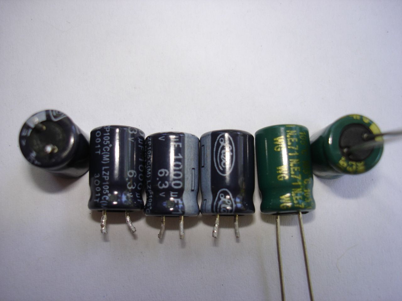

    What uF, volts, can size were those LTEC LZP you removed?
    Those were the ones with high ESR?
    1000uf, 6.3v, 8 mm diameter, 12 mm height
    As you can see in the pic, the Ltec are slightly smaller than the Sanyo
    Underneath, the Ltec show what I regard as the "poor quality" bung with concentric circles like a target, whereas the Sanyo have the "good quality" bung with a moulded shape

      I asked because I found the LZP data sheet but 1000uF 6.3v shows as 8x16mm
      LZP 1000uF 6.3v 8x16mm = 850mA / .086 ohm
      Nearest to 8x12mm is 680uF 8x11.5mm at 660mA / .130 ohm
      I was just curious if the .12 to .15 ohms you got was good or not.
      Looks like it was in the ball park for a 8x11.5mm LZP but LZP have crap for specs anyway.
