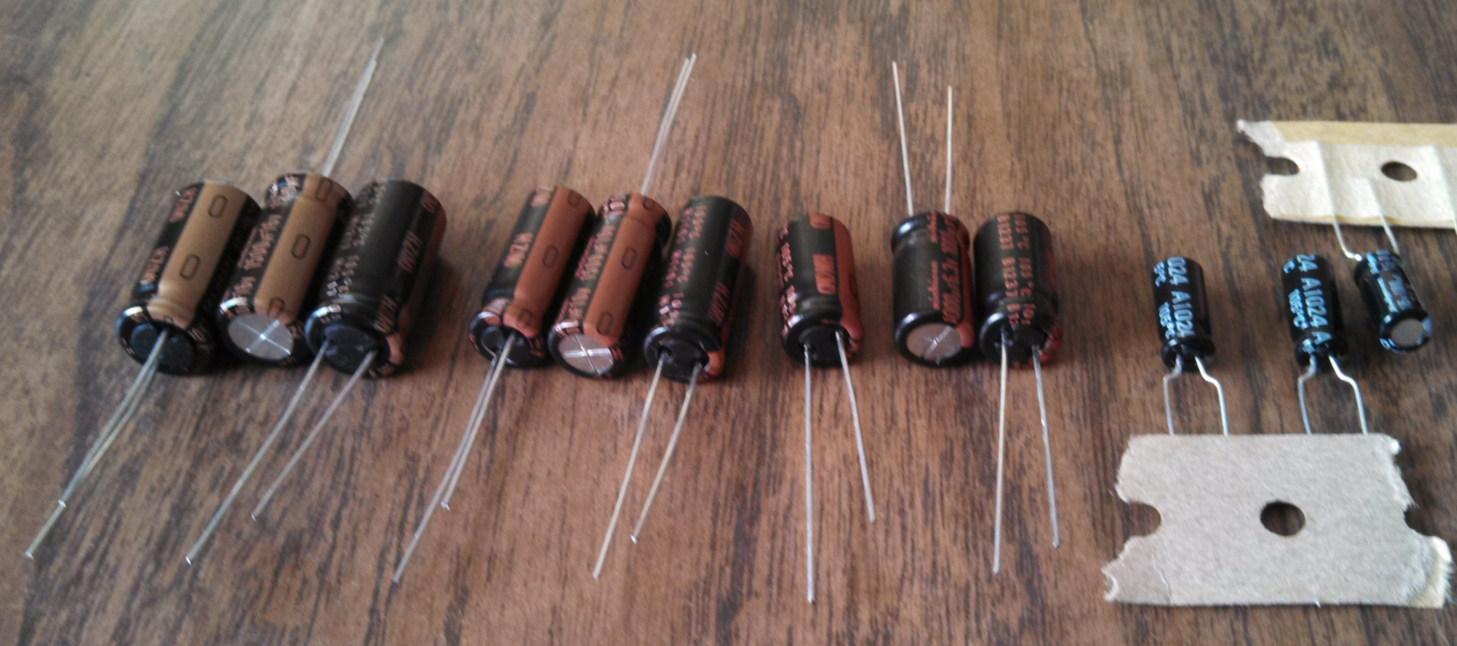

                    Re: Asus P4C800-E Deluxe rejuvenation
                    Thanks for the input everyone!
                    I just want to be certain so I don't put the wrong replacement cap in the wrong place by accident as there is always a chance of anything happening.
                    This is what I picked up in which I've attached a picture of just for reference with the different views:
                    nichicon 1500uF 16v HZ(M) 105C H1217
                    nichicon 1500uF 10v HZ(M) 105C H1101
                    nichicon 1000uF 6.3v HN(M) 105C B1237
                    Rubycon 100uF 16v ZLH 105C A1024
                    Hopefully the last 2 are good since they only had HN for the third one and not HZ. Is Rubycon ZLH any good as I noticed only ZL and ZLG was mentioned. Nichicon doesn't seem to have anything in the 5mm size. Is the last set of numbers basically the manufacturing date code since while I don't know what the letters mean, am I correct that it's basically H1217 = 2012 17th week, H1101 = 2011 1st week, B1237 = 2012 37th week, and A1024 = 2010 24th week?

                        No, don't do polymer... Stick with what you ordered. Do you have more than the three of each you show in the picture for all the caps on the board?

                          I have a total of 37 caps in total so the picture was only to show the front and back view of each type of cap and also the date code.
