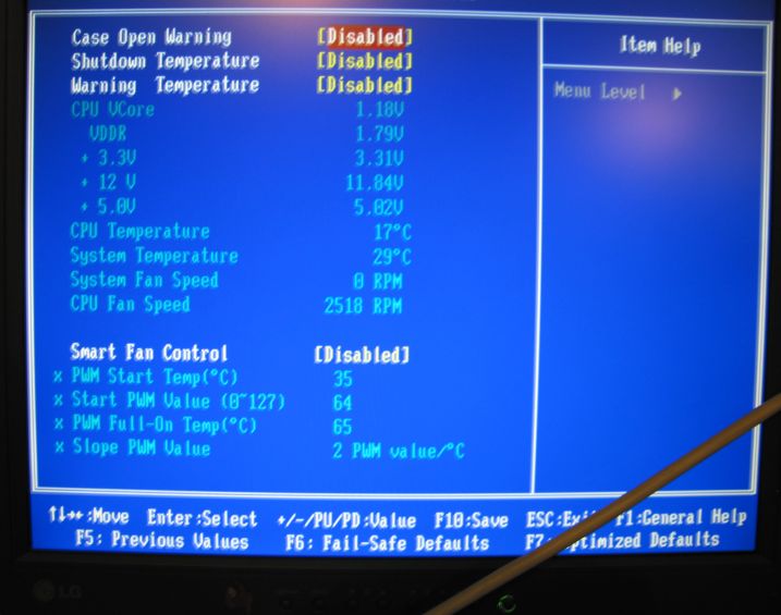

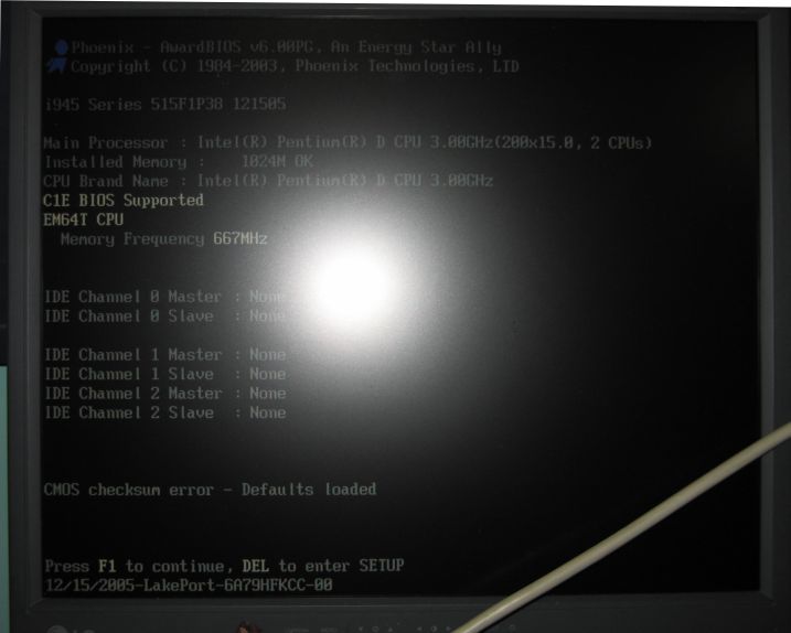

Success!Here are some pics:
The black ones are the KZJ and the blue ones are MBZ.
On the board are scattered 6.3V 1000uF KZJ, the green ones are 6.3V 470uF Lelon "RGA", and in between the coils on the side of the PCIe 16 slot are two GSC 16V 470uF "NK" caps. The tiny caps on the far left are a mix of Teapo SEK which I'm sure need not be replaced.
Higher res pics attached.
12 x Lelon "RGA" 6.3V 470uF replaced with Panasonic "NHG"
11 x UCC "KZJ" 6.3V 1000uF replaced with Nichicon "HN"
7 x UCC "KZJ" 6.3V 3300uF replaced with Samxon "GC"
2 x GSC "LE" 16V 470uF replaced with Panasonic "FC" (Had to go to 25V to match the ESR)
Order was almost completely done from Mouser but I couldn't for their 6.3V 3300uF Nichicon HN caps to arrive February. Only other options were Rubycon MCZ or Samxon GC.
For Lelon "RGA" I used general purpose Panasonic "NHG" capacitor. Is this OK? Datasheet
Thank you PCBONEZ for your assistance.Last edited by mockingbird; 01-11-2011, 11:50 PM.Comment
