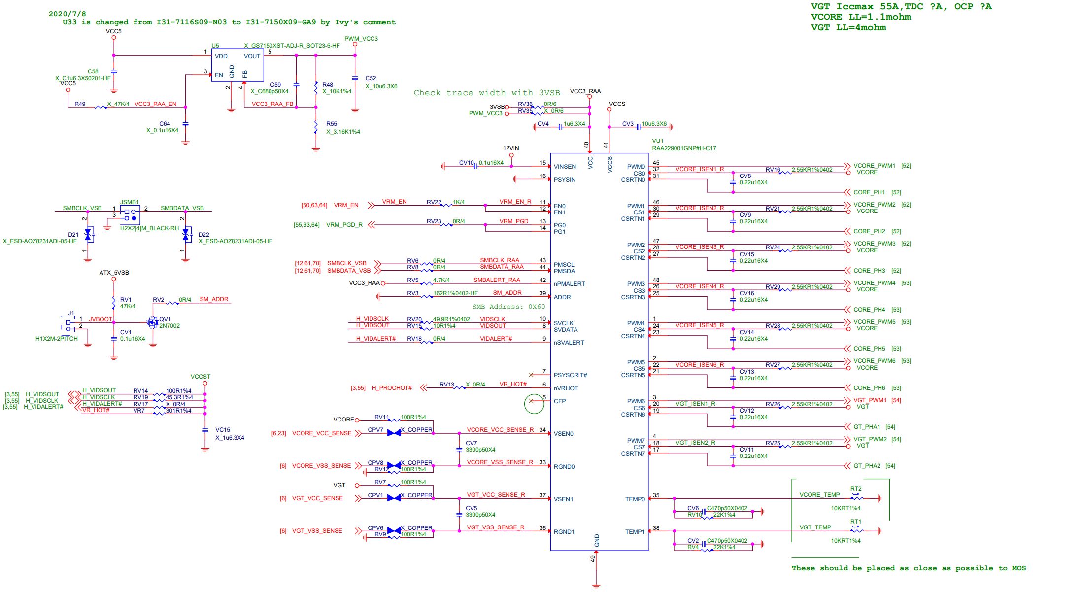

    Below a screenshot from the schematics part of the a.m. board with the VRM part. Maybe this will help others, as the Renesas datasheet is shit as it does not contain pin number information (have no idea why they do not disclose this information).

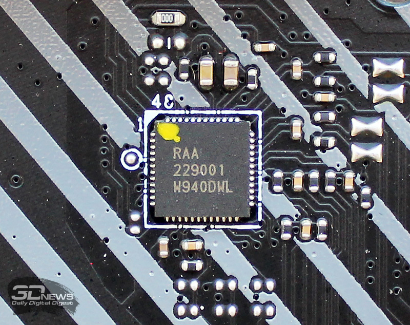

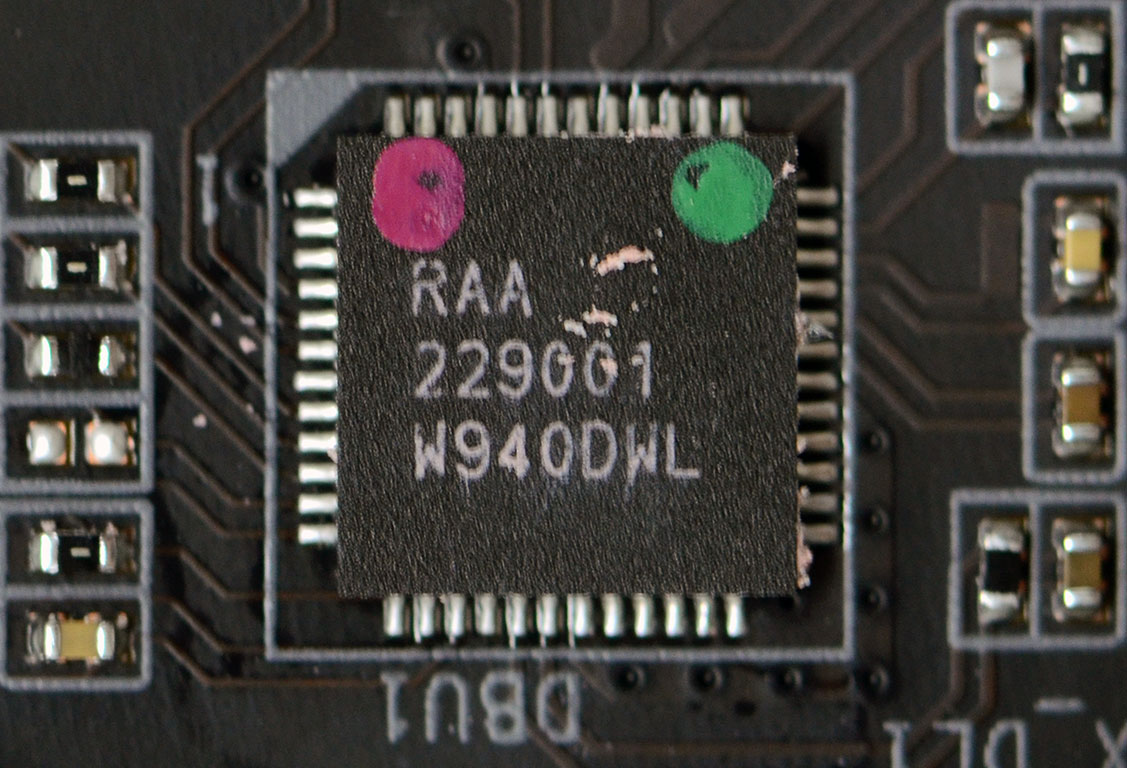

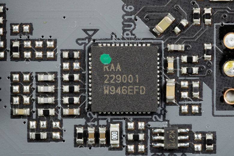

    Usually, dots of colored paint are applied on programmed chips from the factory - this means that the chip has been programmed and has passed the test, so that it still needs to be programmed.

      You are right, the chip on the working motherboard has a dot. So need "only" to find out how to program this bloody chip, or better copy the configuration. Can be a nice riddle.
