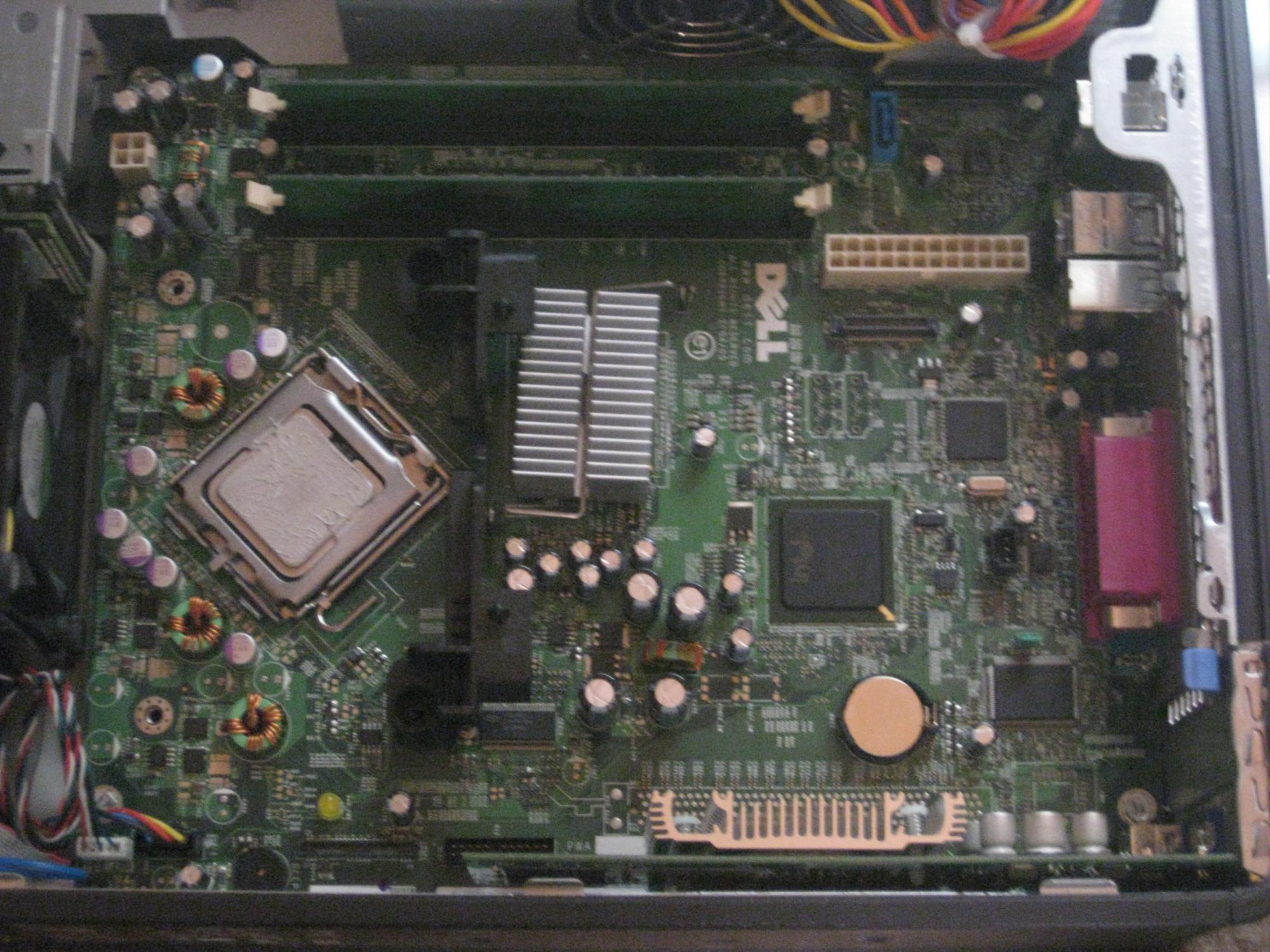

    I have a Dell GX520 USFF that I want to re-cap. Can I just buy the GX620 USFF kit? I could not find any information on the Boards used. I can post the boards model# tonight if that might help.

    make a list of the caps in it or post a foto.

      I took a close look, and can't seem to find any caps that are bulging or leaking... This may not be a cap issue after all. I tested the PS, but it tests good. The thing just shuts down randomly. Sometimes it will stay on for hours, even days. But other times it won't even make it to the Windows logon screen before shutting down.
      Here is the best pic i could get. Could it still be a cap issue?
      BTW, It looks like they were all Rubycon caps with exception from 6 caps located near the socket and 1 next to dimm2...

        GX620's will blow the little 4&5 mm caps which don't always bloat.
        Presumably the GX520 will too.

                    You have a desktop or small form factor GX520, the GX620 that like to bake caps are usually ultra small form factor - very different systems.
                    Is your cooling fan working correctly? Is the heatsink seated correctly?

                          Short answer is no, they are not the same.

                            Sorry I've been inactive for a bit. Ok, so it's a GX520 SFF, not USFF... But yeah, deffinatly not teh same board.
