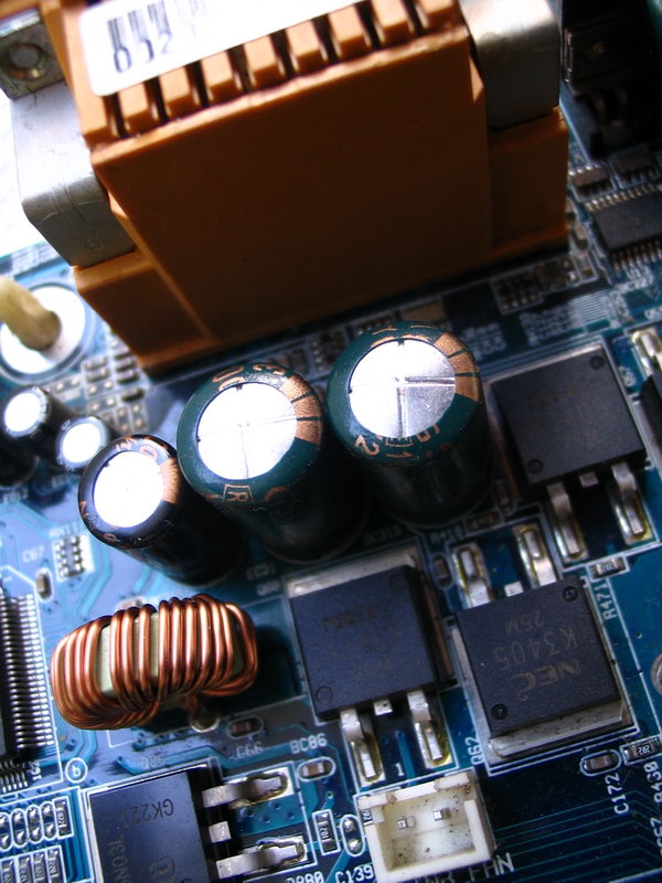

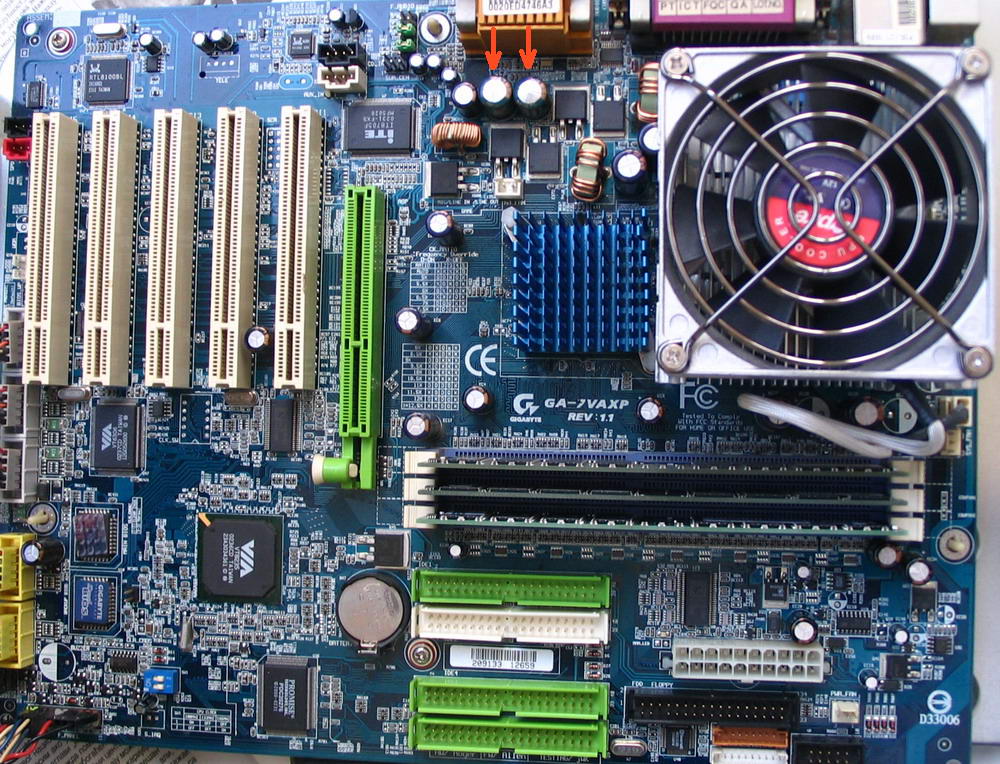

              I have Gigabyte 7VAXP (purchased in December 2002) and until now I don't have any problems with system. But, in last two months I had a lot of random BSOD. I've reinstalled windows but BSOD are still presents. Two or three times in a year I do clean all in case, fans, and last week I discovered two suspicious caps. (pics are attached). If you notice I've replaced chipfan with heatsink because fan died after 8 months. Gigabyte is solid mobo but, chipsetfan and caps are shame for a company. I will replace caps next week.

                Yes, the caps are bad. Nice choice of replacement northbridge heatsink, too.
