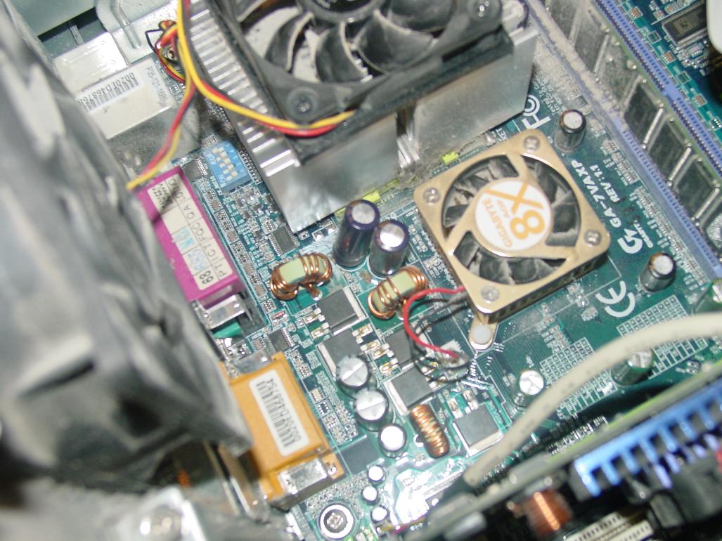

    Im new to the forum, and I have some images of some boards that
    recently decided to act up..

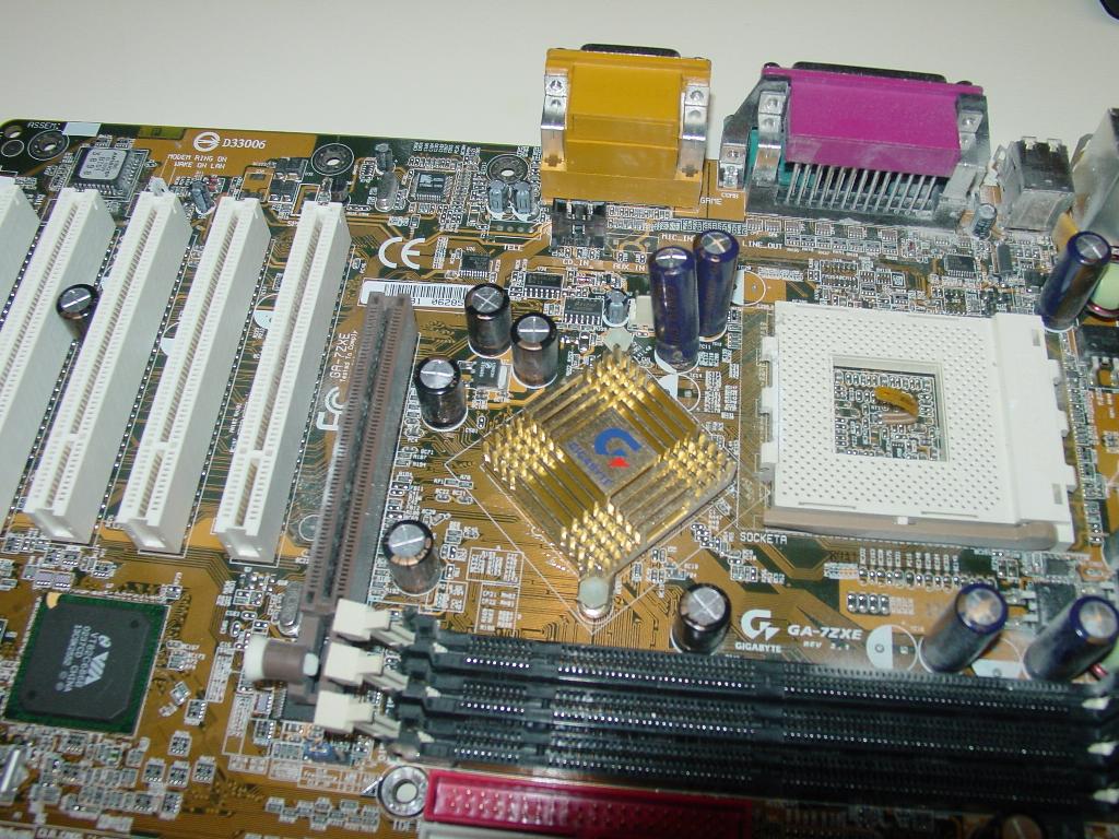

    This board was in th wife's computer. she told me the other day that it started to act funny, rebooting or freezing.

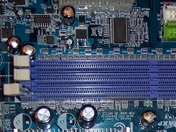

    So, I cracked it open and behold, one cap vented from the bottom and the others the top.
    When I go to work in the morning I will toss some caps on it.
    To make matters worse, after I yanked this board out I was working on one of my machines when it rebooted during an installation of Visual Studio 2005
    When the system came back up, it had a 'your sytem has recovered from a serious error' dialog.
    So, I crack that machine open and low and behold... bad caps.

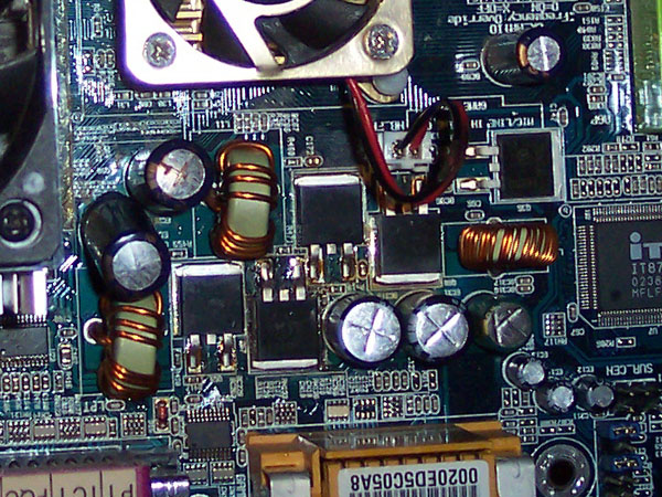

    When you look at the images you may notice one thing:
    they are the SAME CAPS. the values are the same, and so is the manufacturer, 'choyo'.
    These are 3300uf/6.3 volt 105c rated caps (well, not anymore )
    What are the chances that 2 machines within hours of one another, failing?
    I am a firm believer in Murphy's law

    Not only did they use lousy Choyos, they also skimped by omitting about half the caps on the GA-7ZXE. I'd suggest using 1500/6.3 or 2200/6.3, and populate all the empty locations as well when you recap it.

      nice clogged hsf in that second pic.and the dust packed around the ram can cause trouble esp with high humidity.

        Murphy strikes again. When you recap the 7vaxp, clean the dust out of the HSF (both CPU and NB) and RAM sockets.

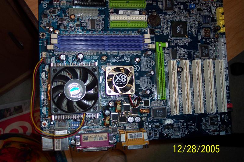

                            As far as I can remember, the first time the board would not post.
                            This time, I had a MCE 2005 install running, and it became buggy. (freezing, etc.) I pulled MB and CPU, then tried a new XP install on a new HD. XP Install almost completes normally, i.e. files cannot be copied, then are copied once retried.
                            At power on, there is a high pitch whine is coming from the MB. At first, I thought noise was the from hard drive but another HD sounded the same, resulting in a closer inspection of MB.
                            This is the way it looks now.
                            Jim

                              can you email me the full pic
                              if you are based in us/canada then Topcat can recap it for you.
                              the whine can be from smt components or the coils when the caps are bad. some boards do that from the coils when new though.

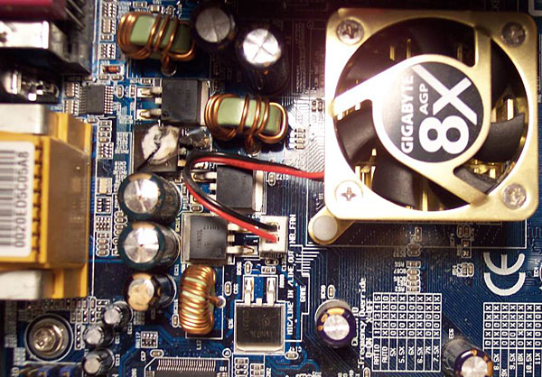

                                close up from above image
                                busted fets prior to "repair" by gigabyte
                                i wanted to see the big pic cos the fets looked funny but it was just the soldering from the repairs.

                                  Considering that this is an AMD XP MB and the known problems of heat generated by AMD XP CPUs, it's no surprised that cheap caps failed. CPU ran 47c, System around 42c enclosed in the case. I was running the retail HSF because it is very quiet, but lacks big time cooling.
                                  This was a media PC with a ton of components and it needs to be somewhat quiet.

                                    those purple ones look like GSC?
                                    i have seen GSC fail on an althlon system in a well ventilated case, although not so spectacularly as that but we might have caught that one early
