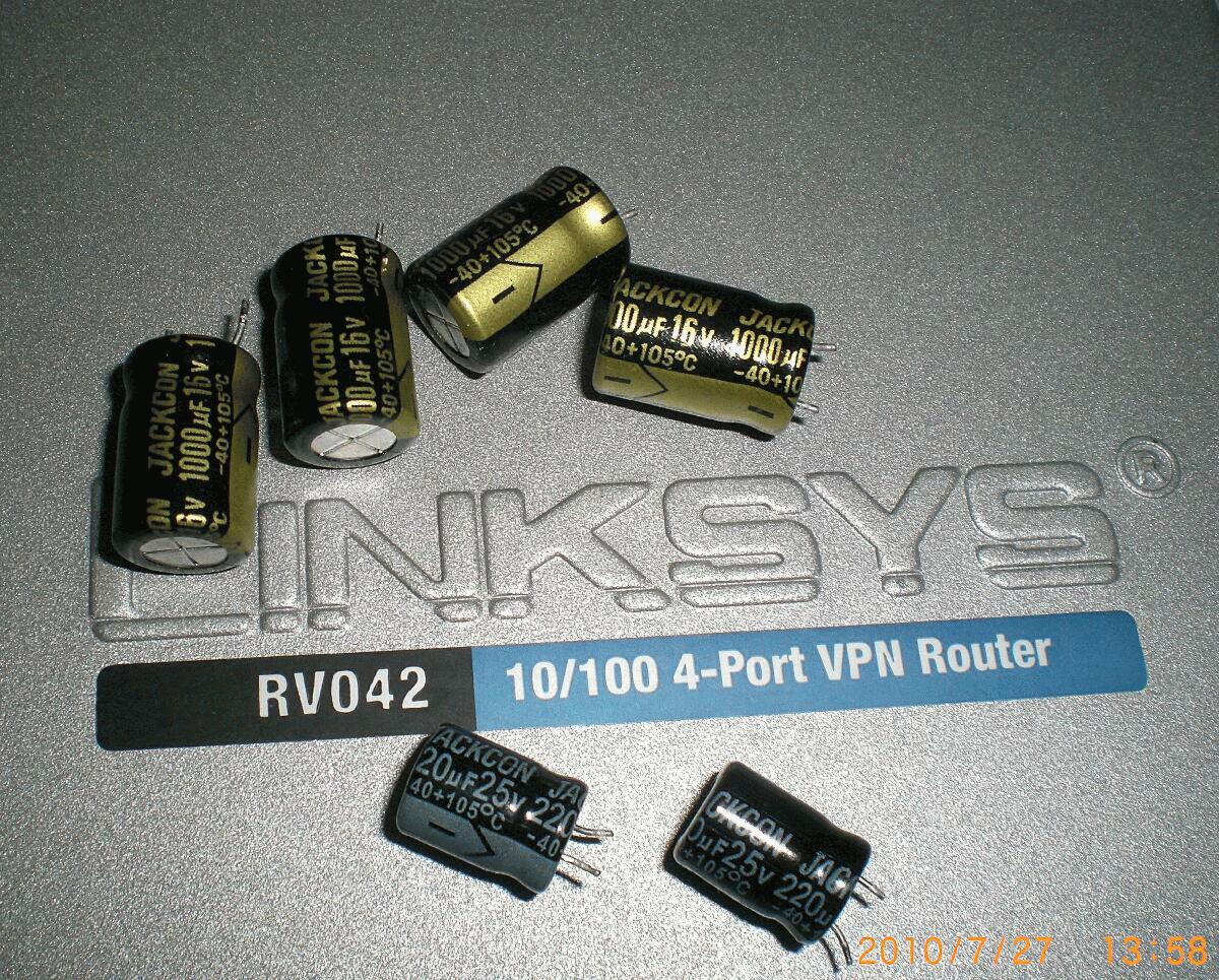

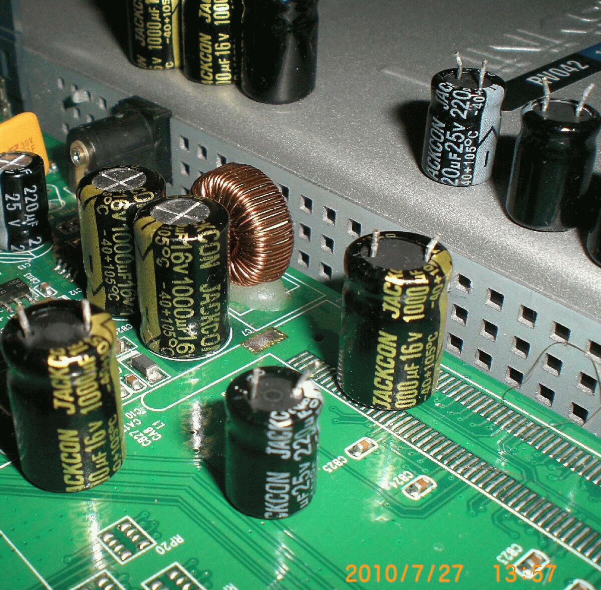

    I have several RV042 (Linksys/Cisco) routers fail over the years.
    They would flicker, hiss, reboot constantly or just have the diag light on.
    In the beginning I thought they'd fail because of power surges (or similar external influences) had damaged something.
    But I found out that from the 12 dead units, 10 have Jackcon capacitors and that they fail because of that!
    Those capacitors (2x1000uF/16V and 1x 220 or 470uF/35V) have only a few uF, if at all.
    Unfortunately the RV's would die right after the warranty period (which was one year at that time).
    I contacted Cisco about this pattern and am curious what their response is.
    I also have contacted Jackcon but their rep is just giving me a rounaround so far.
    The rep claimes that they have no dealings with Cisco/Linksys, so I wonder how their junk capacitors end up in those products?
    Amazing that a 50c trash capacitor can bring a $160 unit to it's knees after just one year!
    So in case you end up here, this is what you need to do:
    Replace the C7 and C11 and C13 Jackcon capacitors.
    In fact, check if you have any Jackcon capacitors and replace them right now, as they will fail soon.
    Attached some pictures

                          Hi, I just wanted to thank Peterdori for his post. I have a RV042 which was very reliable until last week when the diag light came on. I found this post and replaced the C7, C11 and C13 capacitors. Now the router is working normally. This saved me time and a lot of money. Many thanks
                          • jc292
                            • Jul 2012
                            Re: Failing RV042 routers due to bad Jackcon capacitors
                            Just want to echo david123's thanks to the OP. I replaced the three electrolytic caps mentioned in this post (the only 3 in the device) and didn't even use low ESR caps. It still brought it back to life! Awesome. And the hissing from the device has stopped.
                            • mfaraday
                              • Oct 2012
                              • US
                              Kudos to Peterdori for this post. I have been using an RV042 as my home router for several years. I recently came home to a brick with its diag light on, and it was making a slight hissing sound. Luckily I had a second RV042 shelved in the garage, so after getting the second one configured I started searching for failure info and discovered this post. I haven't re-capped the dead box yet, but I'm hoping that will be the key to reviving it. Thanks again.
