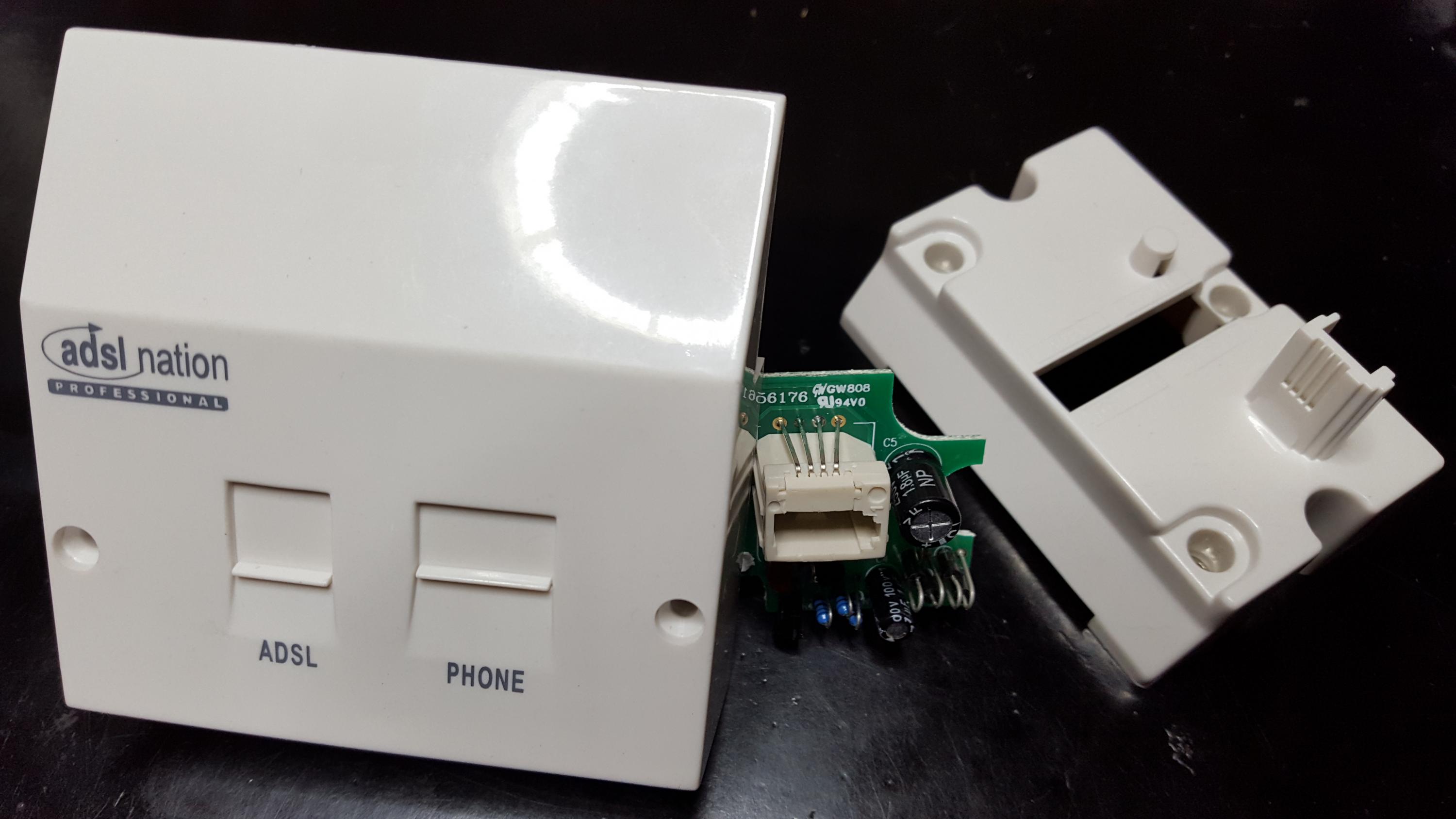

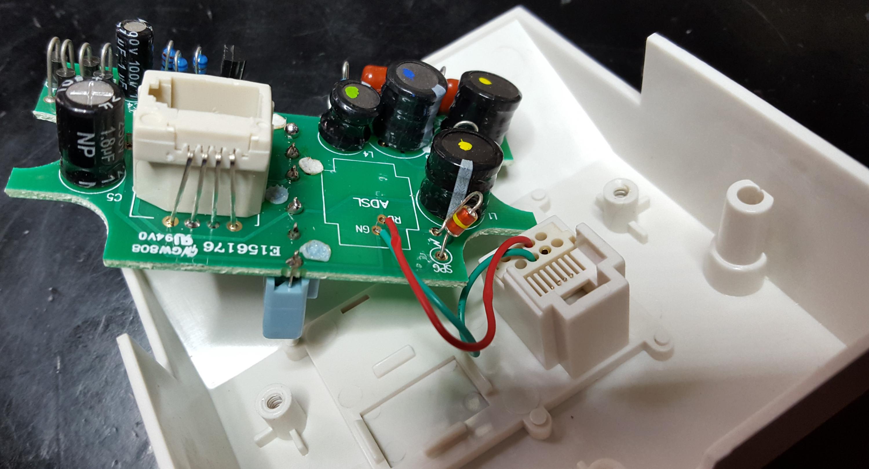

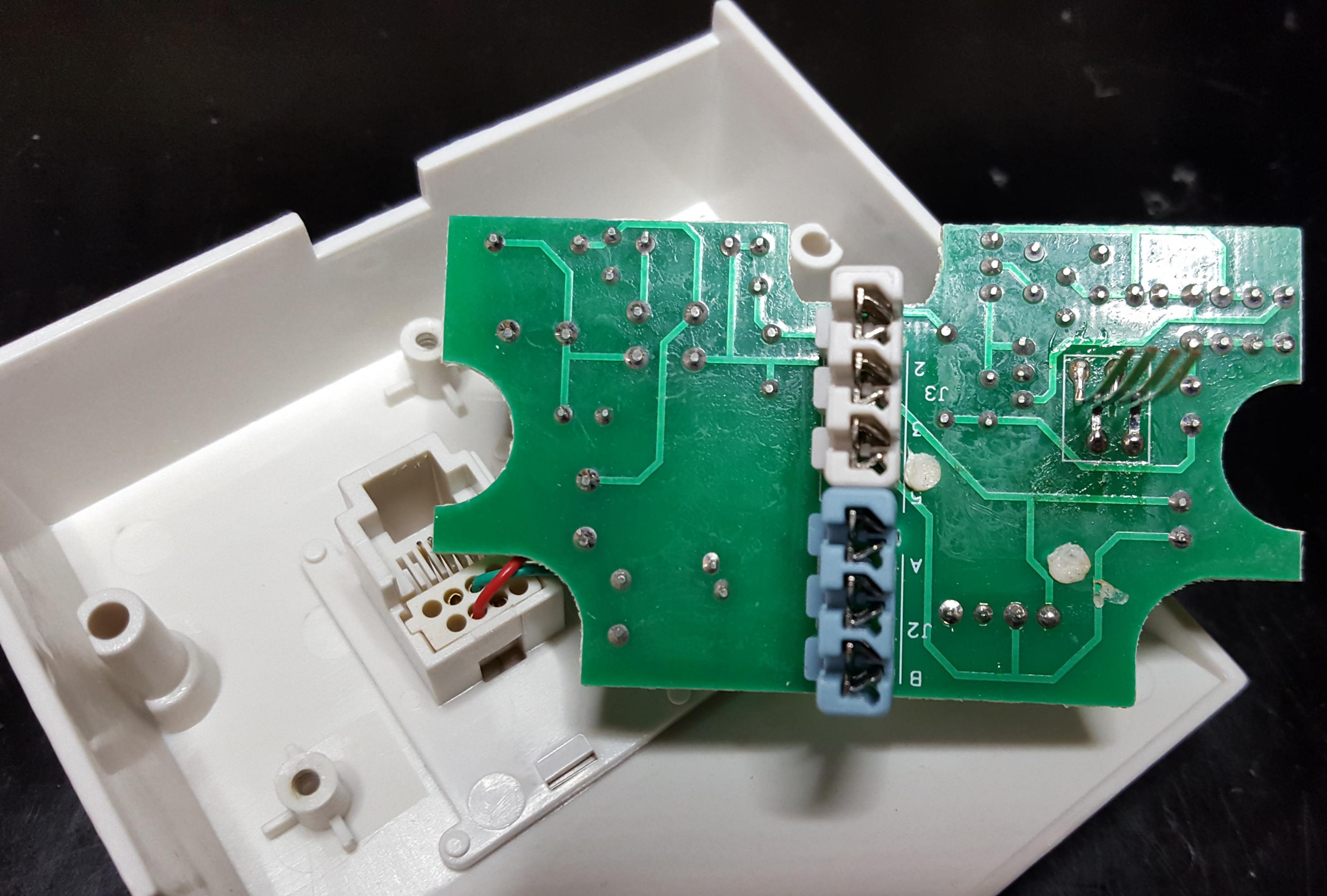

    Broadband Filter ADSL Nation Capacitor Upgrade Values
    I use an "ADSL Nation XTE-2005" to separate my DSL/Broadband signals from my POTS Voice signals.
    I would like to replace the two capacitors on it that I suspect keep failing - the real issue being the frequency separation and filtering performance (ADSL connection speed) of the "XTE-2005" increasingly ebbs away long before you replace it when it finally dies (sudden audible noise on voice telephone calls).
    The Capacitor values are proving difficult for me to find a superior replacement for they are: -
    1. C4 1uF 100 Volt "NP" (Presumably Non-Polarized) -40+105°c
    2. C5 1.8uF 250 Volt "NP" (Presumably Non-Polarized) -40+105°c
    Here is a link showing the XTE-2005 design with other ADSL Filters and Splitters http://www.adslnation.com/support/filters.php
    Here are some close-up photographs showing the markings and values of the capacitors I am talking about

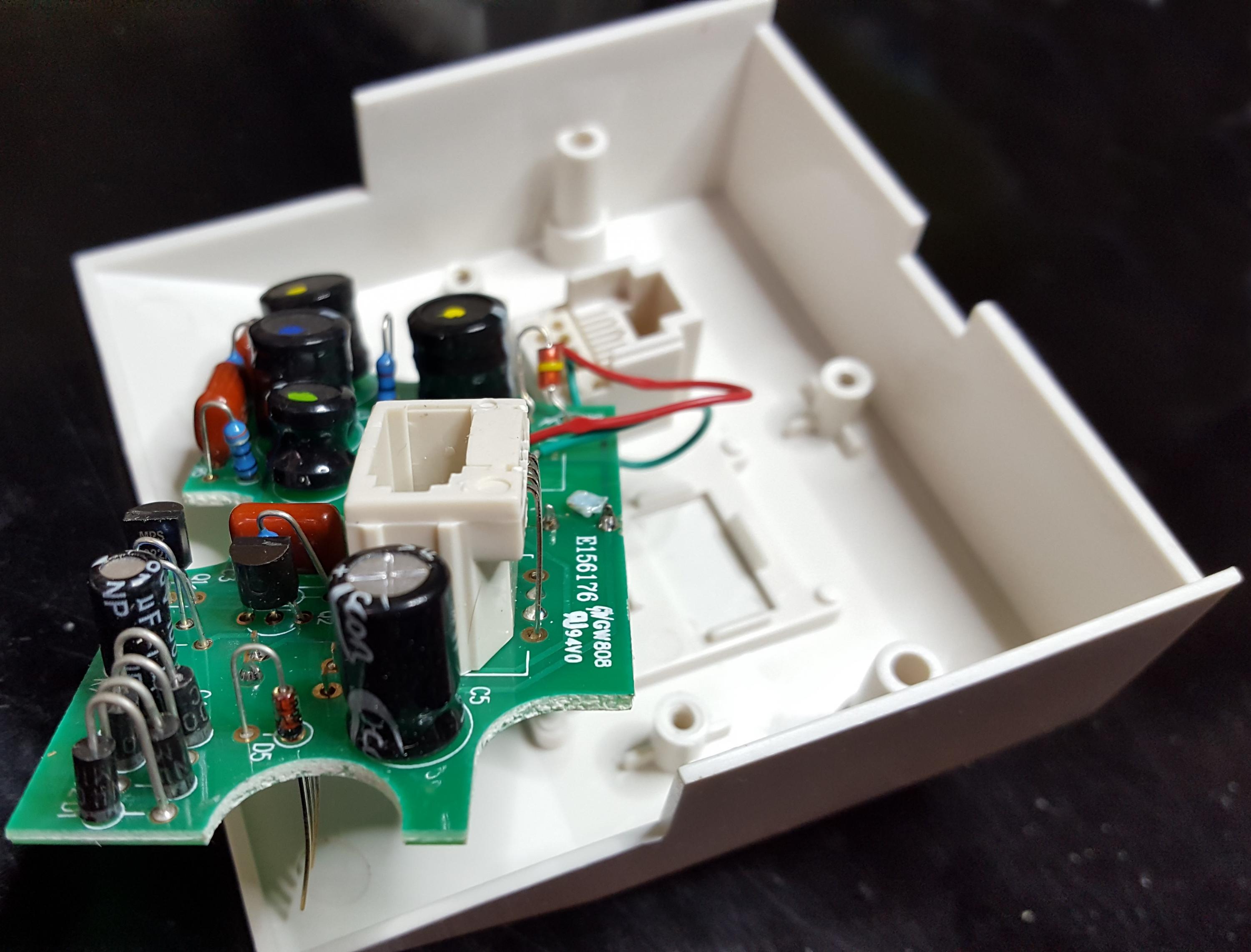

    Re: Broadband Filter ADSL Nation Capacitor Upgrade Values
    Rest of the Photographs

      What do you mean by superior? Have you tried Farnell? Don't forget that you can always go up in voltage rating and you can probably drop from a 105C cap down to 85C. Also, you may as well replace all the caps on the device since you're not sure that it's those two caps.
        Superior (in my opinion) would mean a capacitor from a well known manufacturer (who supply's the repair industry & not just the lowest possible price obsessed manufacturers) with a good reputation - the opposite from the unknown manufacturers name printed on the capacitors you can see in the photographs.
        Farnell? Not specialized enough.
        The problem is the original capacitors are marked as "Non-Polarized" (aka Bi-Polar) so you cannot put in a regular polarized capacitor - having checked again (unless I am using the wrong search terms) Farnell do not sell any Non-Polarized capacitors rated over 50Volts.
        Either way can probably combine orders for free shipping and buy from outside the UK if necessary so UK Farnell will not be a limiting factor.
        I will replace all the other Non-Electrolytic Capacitors (suggestions for superior replacements are welcome) if changing the two Non-Polarized Electrolytic Capacitors doesn't work - I value all ideas/inputs on replacing the rest of the capacitors.
        However I suspect the two electrolytics are failing by drying out or maybe (being from an unknown manufacturer) they never met the specifications printed on them in the first place!

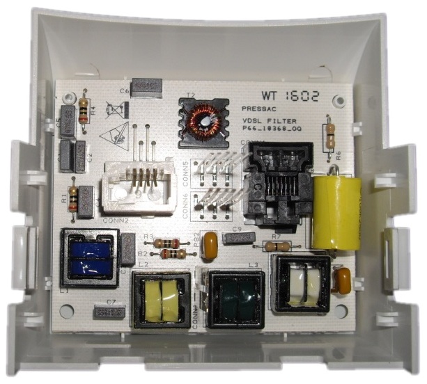

              What was known as SDSL is now also known as VDSL and there is now an even newer design of central DSL splitter like this one https://www.run-it-direct.co.uk/mk4b...dslsocket.html

                Look at the low tolerance resistors in that BT VDSL line-box splitter photo (my post just above) - also the capacitors are tiny in terms of physical size – which is not generally a good sign for reliability – the capacitors are all non-electrolytic though.

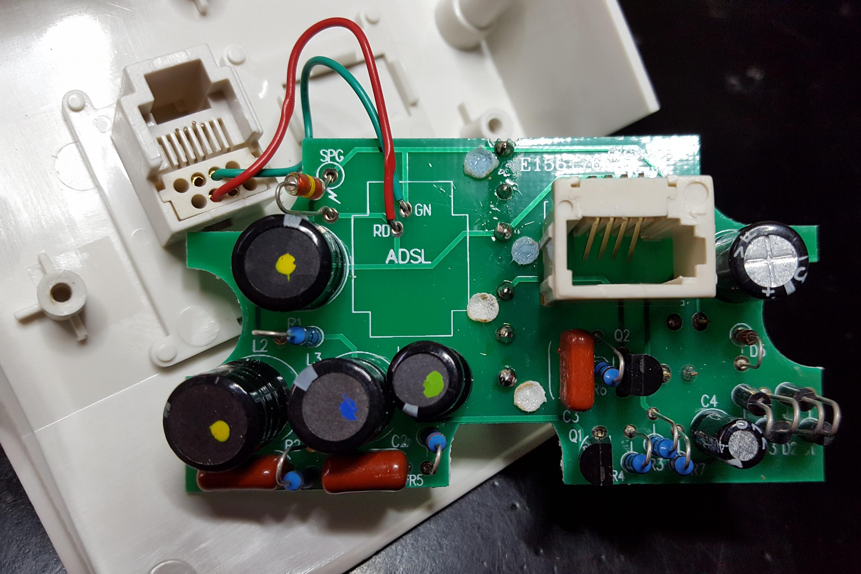

                Anyway, finally got around to changing the capacitors in my ADSL Nation splitter - it is noted their “XF-1e Microfilter” http://www.adslnation.com/products/xf-1e.php uses all non-electrolytic capacitors while their line-box splitter and master socket filters both use the two electrolytic capacitors that I got rid of in my XTE-2005 line-box filter.
                Why is that? There are very good reasons for totally eliminating electrolytic capacitors completely in any product (XF-1e) BUT then leaving electrolytic capacitors doing the exact same job (while drying out and failing) in the other two products you supply makes no sense.
                First of all, the ADSL Nation soldering quality was absolutely awful in several places - worst of all were the four gold plated finger contacts that connect the splitter to the BT line-box test socket – also there was heavy flux build up across several different areas – all of which I fixed. The visible dry solder joints would create noise and RF interference on the ADSL/Phone line from their imperfect connection.
                Of the four Inductors L3 has four connections/pins – the rest have two – why?
                Are inductors all normally marked and installed according to polarity? The ones on this are.
                Then having removed the two electrolytic capacitors I had to figure out how to physically cram in their non-electrolytic replacements – it is possible! See picture – just trim the case to make space for the ring capacitor – once installed on the BT line-box it looks totally standard/stock.

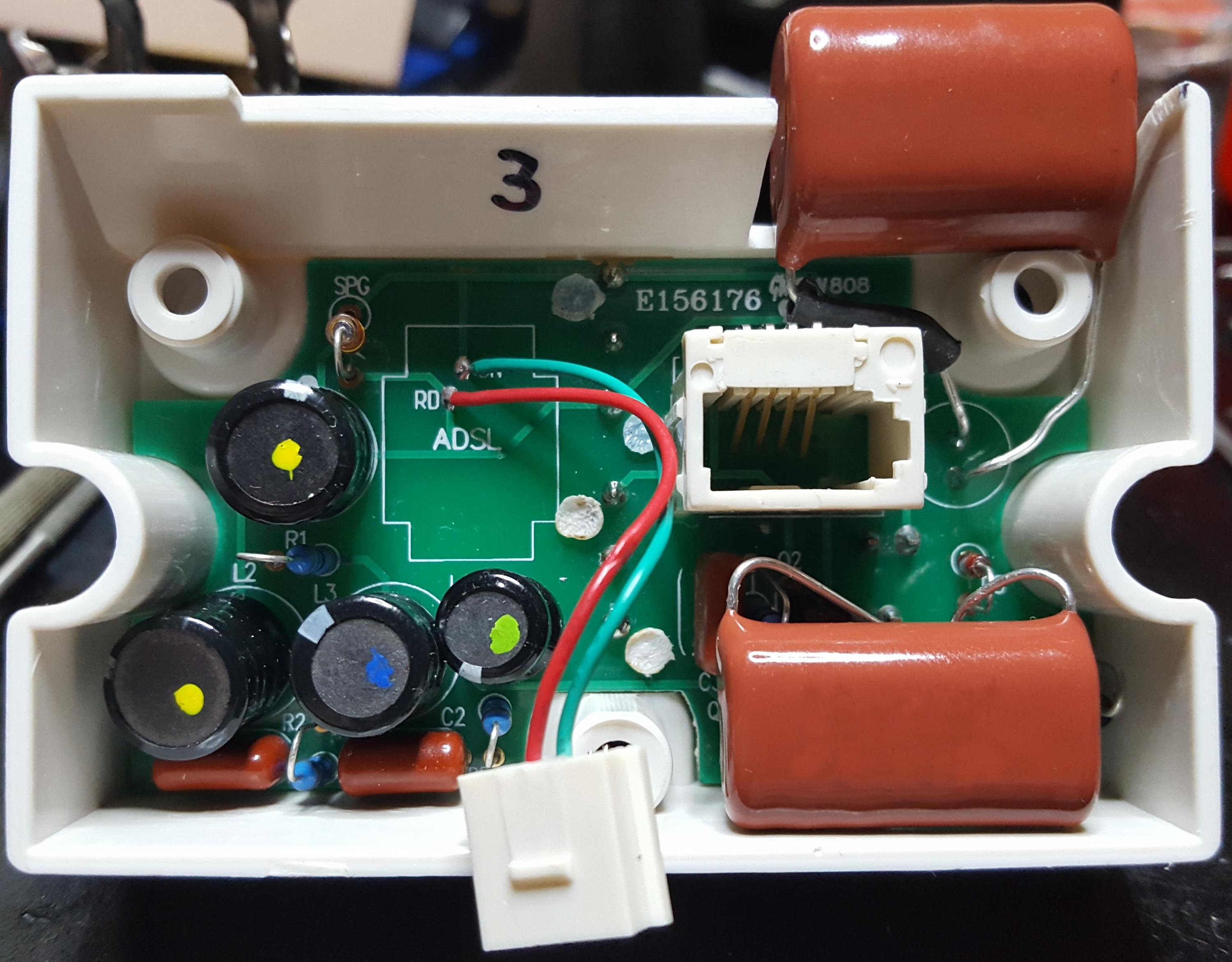

                What a spectacular Broadband/ADSL2+ speed increase! Best ever – way better than the very first (2008) “XTE-2005” I bought.
                Very pleased with the result and even better this non-electrolytic capacitor chemistry cannot dry out and cause problems like dropping DSL speed or audio crackling.
                Comparing the original very first (2008) ADSL Nation “XTE-2005” I used with ones I bought later I am beginning to think that ADSL Nation are supplying a worse, cheaper (in terms of components used) design of splitter nowadays – the differences in components are: -
                1. Physically smaller “SPG” (spark gap?) component - Top left of PCB
                2. Worse soldering overall – terrible (visible Dry Joints) manual soldering on leaf contacts – significant leftover flux across connections everywhere
                3. Different 1.0uF capacitor supplier – in 2008 it was pale grey sleeved - newer one is black – I wonder which is better (or cheaper?)
                4. Different pair of Transistors – 2008 vintage was marked “2N, 2222, A338” newer ones are marked as “MPS, 2222A”
                5. Different markings on the four diodes – bottom right corner – lost patience by that point so didn't write them down!
                6. Different markings on the three Film capacitors (older markings first) C3 WAS marked “F152Je., 400MEF1” NOW marked “Z400, 152J” C2 cannot be read without de-soldering and the C1 WAS marked “F393Je., 400MEF1” NOW marked “Z400, 393J” – also the older 2008 capacitors were physically larger components – which could be a clue as to quality?
                Sometime I might just replace all five of the capacitors on the original 2008 splitter (with the different transistors etc.) and see if there is a further DSL performance / throughput gain to be had – also if it comes back to life as it was replaced because it was not working.
                To that end would an expert be able to look at the makings and tell me how to go about decoding: -
                C3 “F152JE.
                400MEF1” and
                C1 “F393Je.
                400MEF1”
                When I de-solder C2 will then be able to also figure it out from the other two.
                Would a Transistor specialist know what is the difference / which is better for this application (similar to an audio crossover for speakers) the older 2008 splitter used a pair of transistors marked: -
                2N
                2222
                A338
                OR the new transistors they are using which are marked: -
                MPS
                2222A
                Instead of having to tolerate high ADSL line speed BUT with lots of small pauses just replace a pair of dubious choice wet capacitors on the nowadays shoddily built ADSL Nation Splitter and increase overall throughput speed massively!
                A great improvement that you can utilize every single day on your (now) low latency / jitter internet connected computer network.

                  F152Je., 400MEF1 = 400v 1.5nF
                  F393Je., 400MEF1 = 400v 39nF
                  The J at the end is tolerance in this case it's 5%
                    2222 is just general purpose NPN Transistor made by many many companies, base number is just 2222.
                    https://cdn.badcaps-static.com/pdfs/...4e099ddf82.pdf
                    https://cdn.badcaps-static.com/pdfs/...5d63fe6c7c.pdf
                    https://cdn.badcaps-static.com/pdfs/...dd8e10c1ec.pdf
