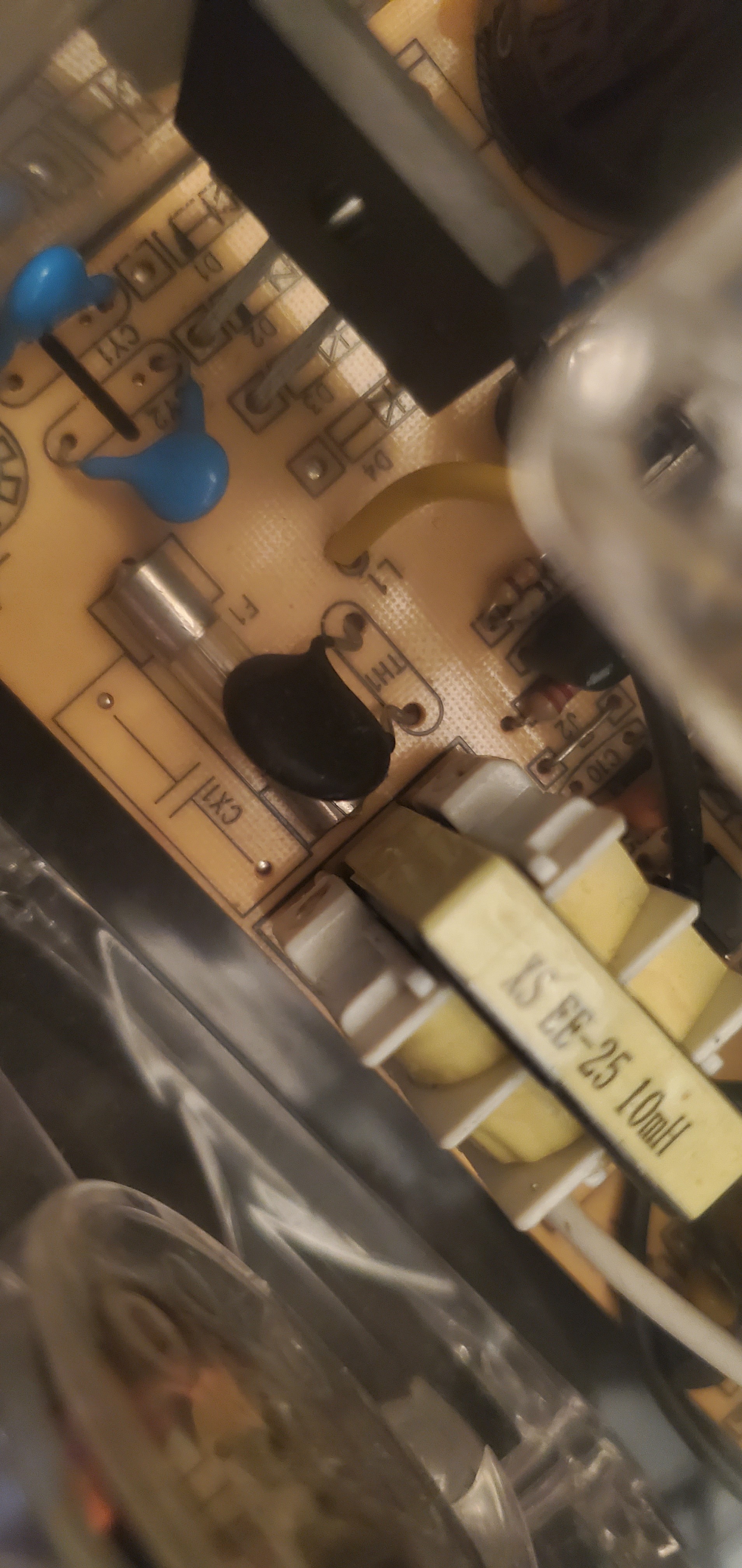

    Recently acquired one of those silly Logisys acrylic power supplies and lucked into getting one of the "better" ones (most of an input filter, bridge rectifier instead of 4 diode treatment, OK-sized heatsinks, etc.) and wanted to fill out what I can on the board + get some decent caps on there (especially the primary side since I highly doubt the ones in there are actually 1000uf). My questions are:
    1. How do I know what components to install re: the input filter? It seem to be missing an X cap, a resistor, and a Y cap.
    2. Where can I find a good heatsink for the bridge rectifier?
    Attached are pics of the missing component sections in question

    Typical values: ,33uF for the X cap ; 2200uF for Y caps. Check whether CY1 and CY2 are agency approved Y caps, not just parts rated 1000 VDC. If they are not agency approved parts rated for AC voltage, replace them. For the X cap, just match the lead spacing and available space. The Y cap locations are probably sized for ceramic Y caps.
